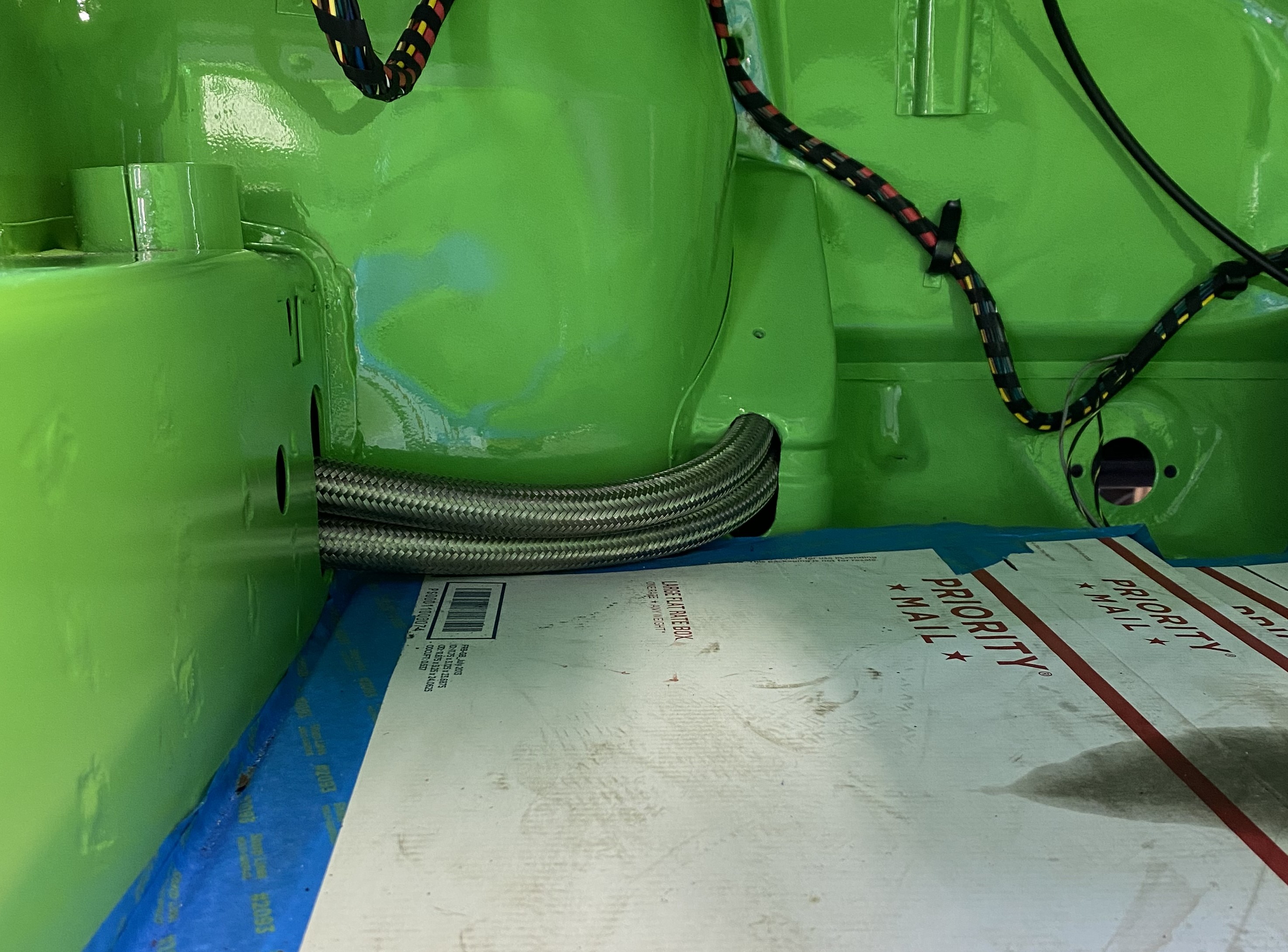

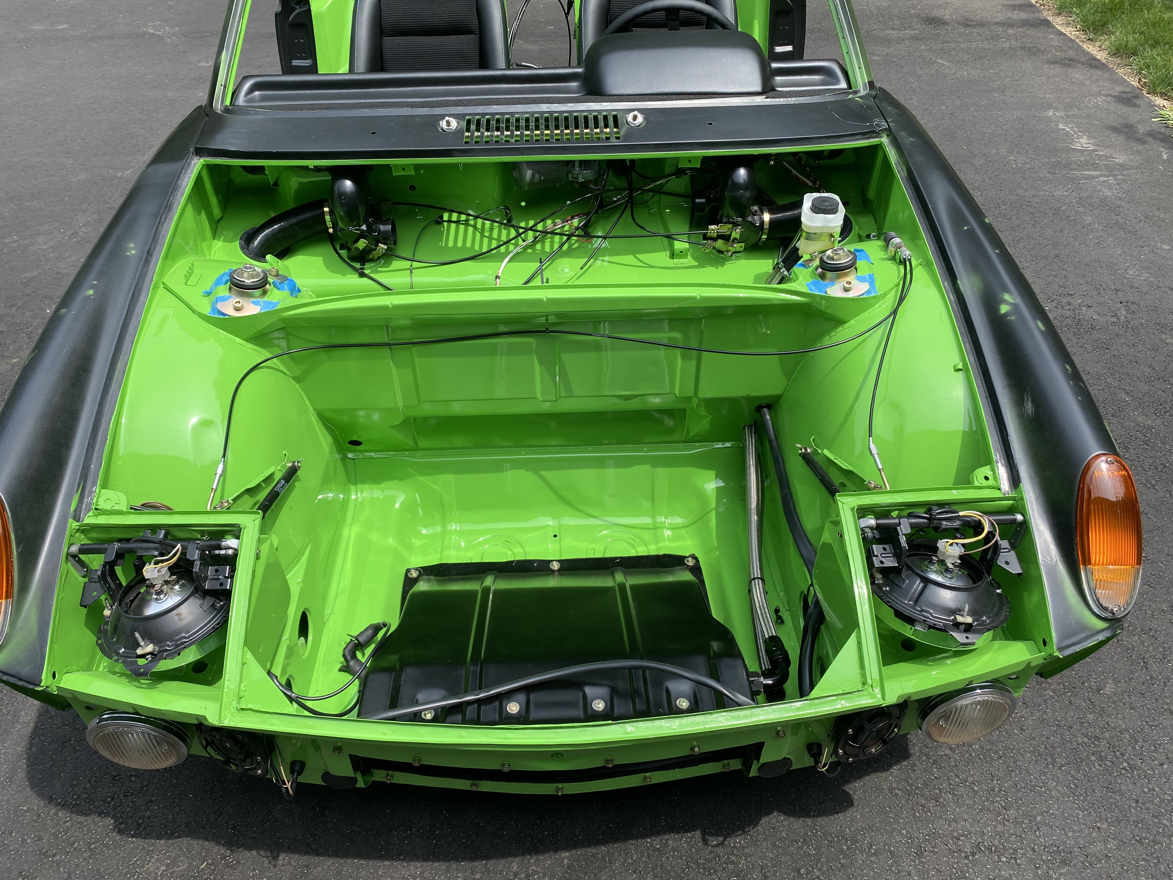

Hi Pete
Here is what I did on my 914-6 GT project based on lots of input and studying on this site.
Front mounted cooler with oil lines entering on the driver's side through the driver's footwell.
