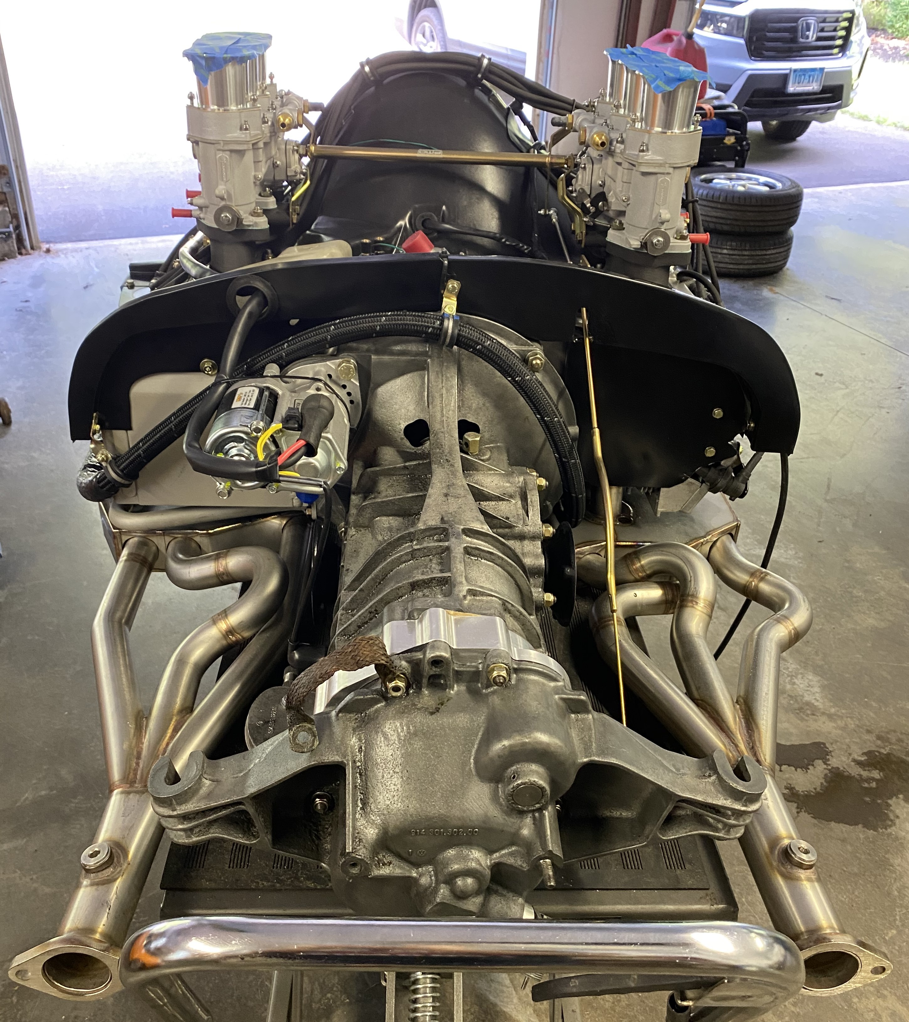

I used braided AN lines for the engine scavenge line and ran it backwards across the gearbox like the early 911's did.
