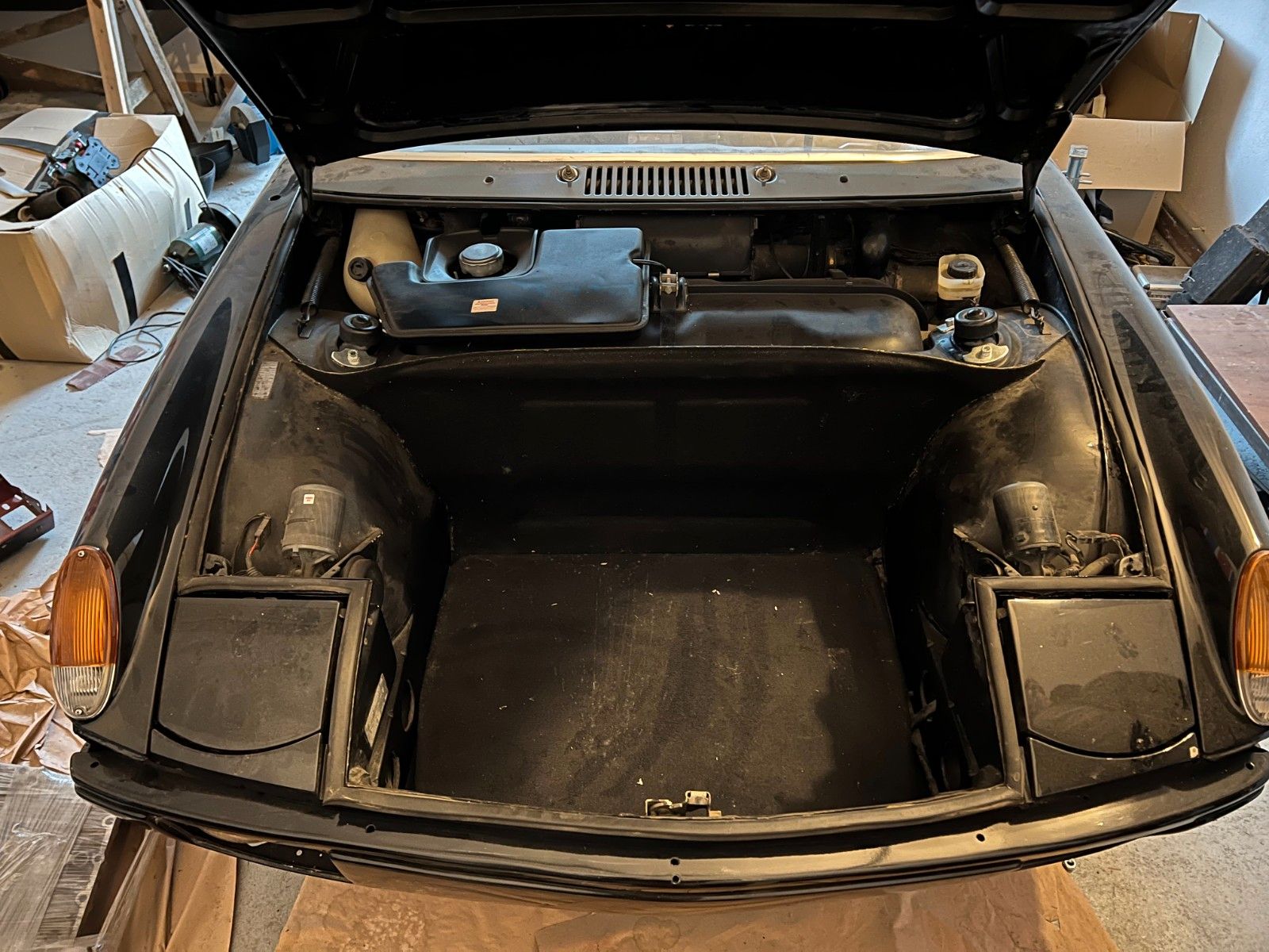

Lets figure out your model year.
Does your front trunk look like the white or yellow car below?
Pyetookh
post Dec 20 2025, 09:15 AM
Posts: 30
Joined: 25-May 17
From: Pisek, CZ
Member No.: 21,129
Region Association: Europe
QUOTE(JeffBowlsby @ Dec 19 2025, 11:41 PM) *
Yellow example, please.
This is my frunk:
There are some hints of the original Sunflower yellow in hidden corners too.
