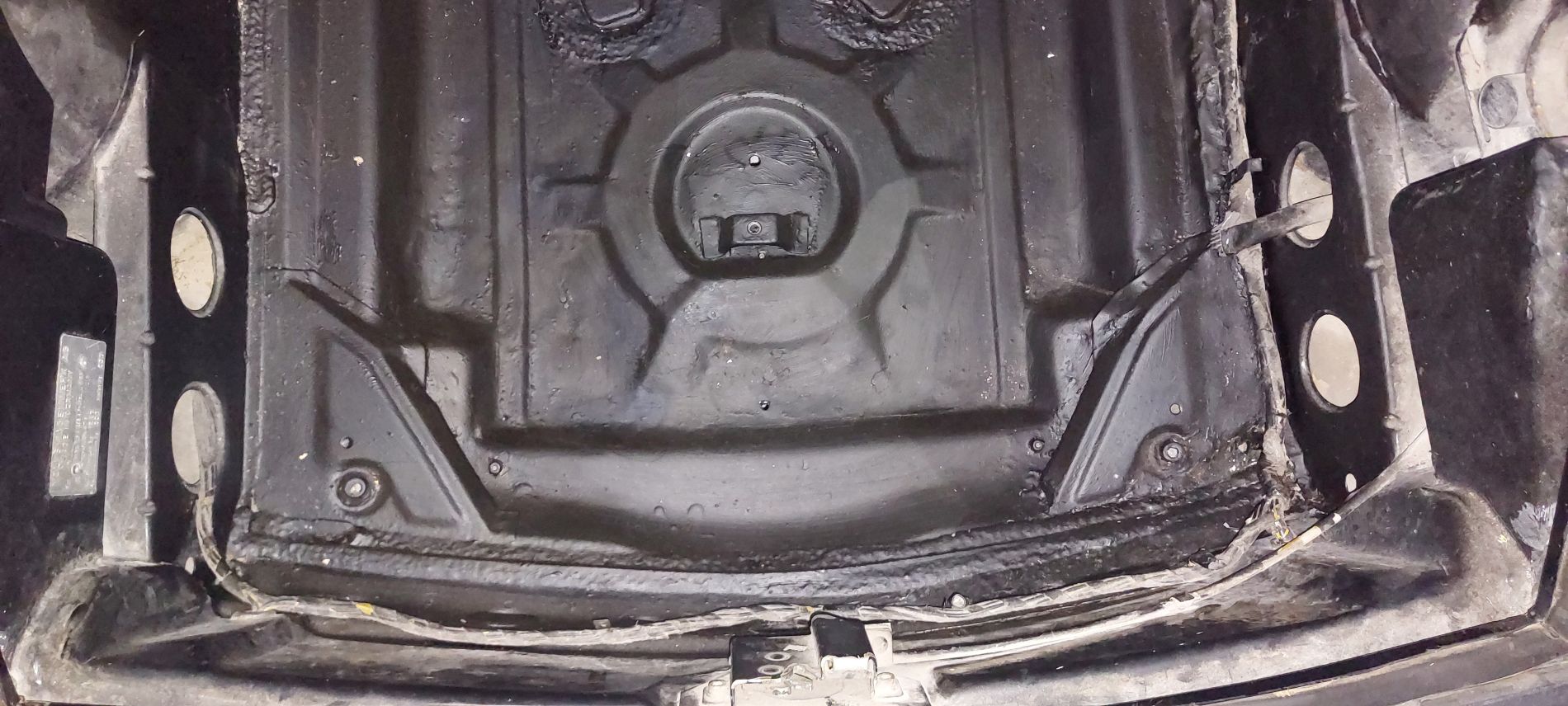

You need to lift the trunk floorboard to see what’s underneath.
If your car was originally made for the US market and delivered directly in the US, then there is the following: in ‘73 the curved reinforcement you see in the frunk on the white car above was added to the US models along with the bumper horns. However, the Euro models did not get either of those - mine is a 74 delivered in France and has neither.
I see both holes in the sheet metal near the headlight area, the reinforcement seems to hide the front most one in the pic above, so it looks to be absent.
Add to that that there are no side marker lights on yours - unique to the US models I think. They may well have been removed however. Do you see any evidence of that - patch welded in where they should be? I’m just wondering if it’s certain that the car was originally delivered in the US. If so, and the reinforcement is not there, it’s highly likely that it’s pre-73.
But of course I defer to the real experts…

Very sorry. Wrong picture.
No brace there
