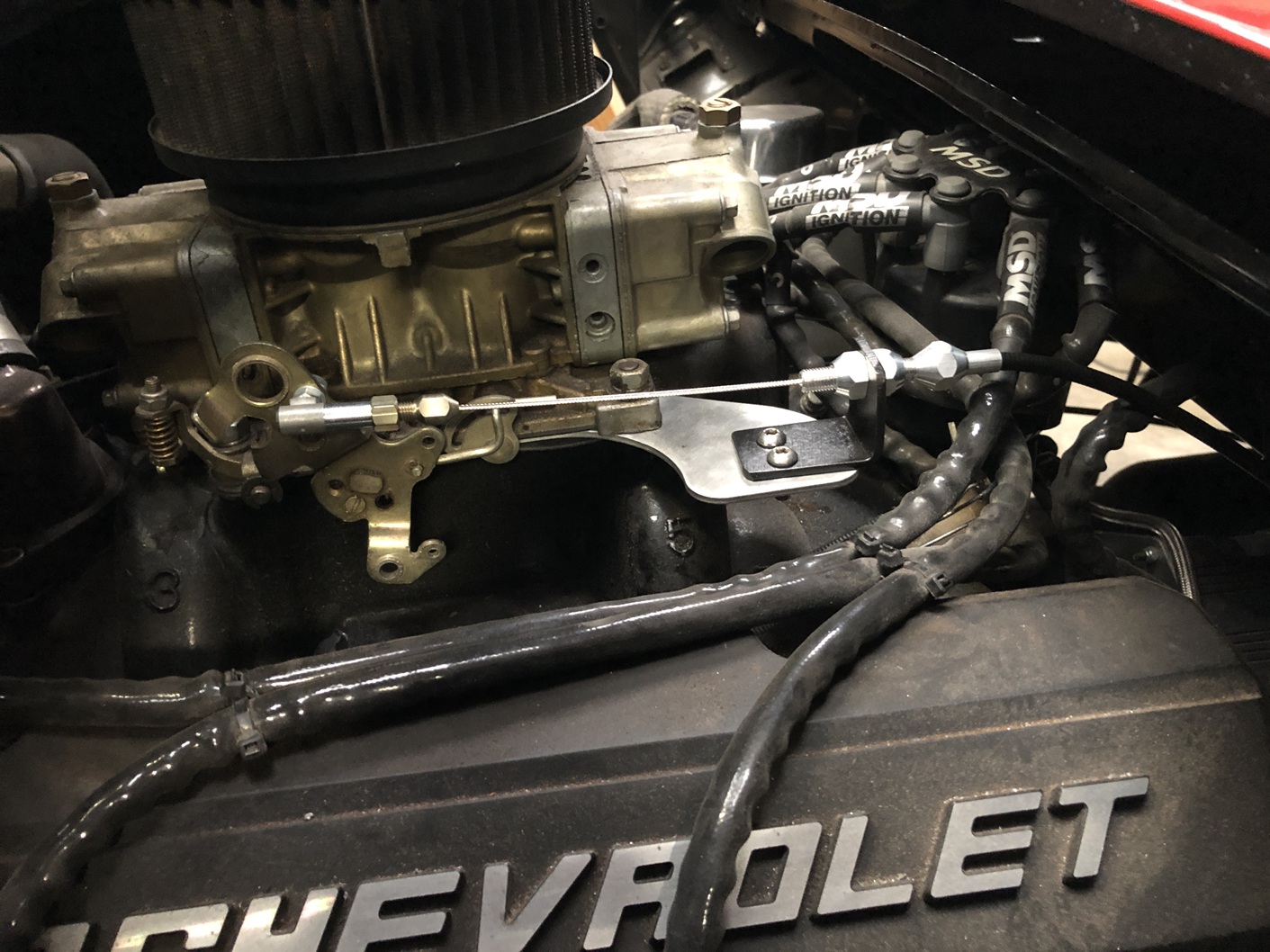

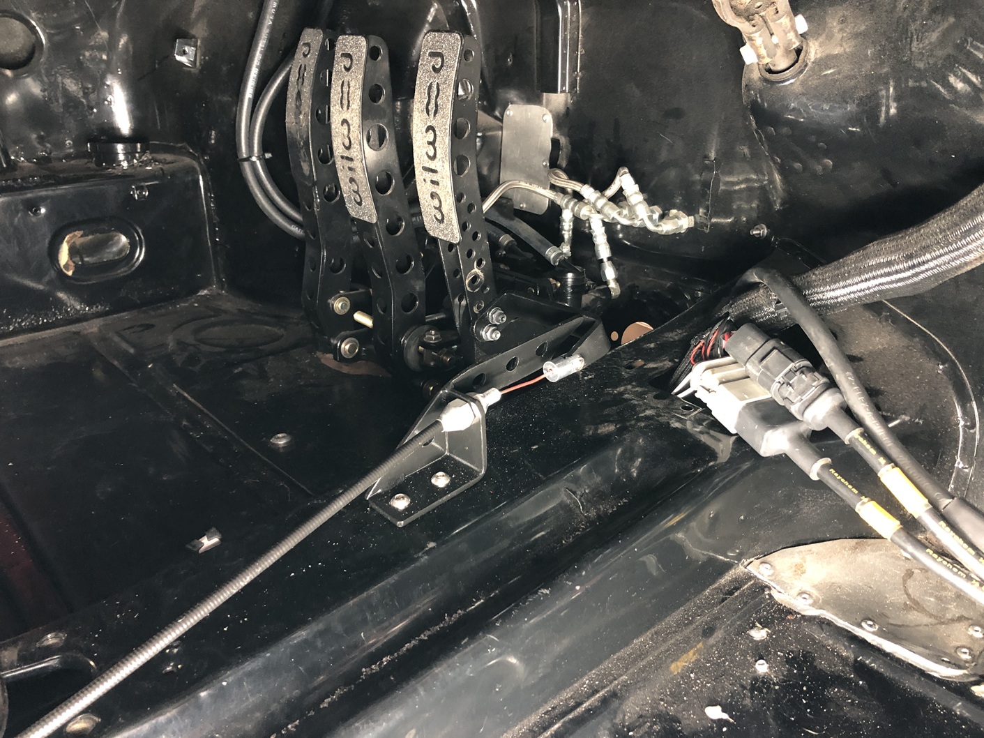

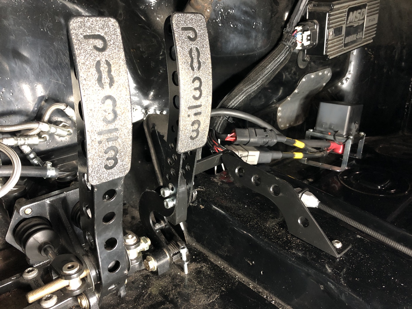

If you follow the videos, you'll remember the awesome job that was done with the throttle cable: a cracked plastic liner with an old VW throttle cable wrapped a couple times around a tube and sorta held on with a hose clamp. It was one of the most hacked hacks I've seen.
The good news is that it's now fixed with a lovely Lokar cable assembly and some proper cable stops. Just a return spring away from being all done.
