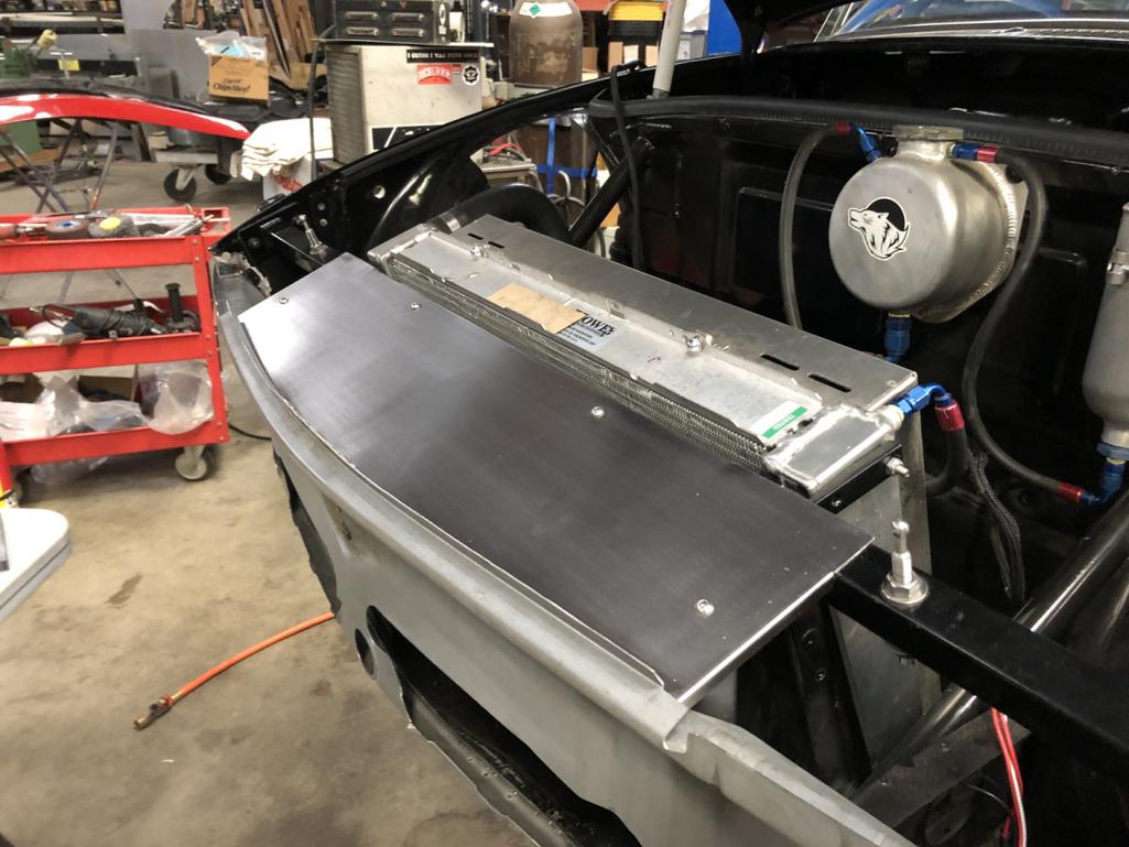

The car arrived with no shrouding from the nose to the radiator. Greg whipped up a tidy set of panels to solve that problem. A bit of seam sealer around the nose/chassis seams and all this is ready for paint.
Sorry, no stamped panels here. Gotta save all my Style Points energy for the 914 Ferrari! (IMG:style_emoticons/default/laugh.gif)
