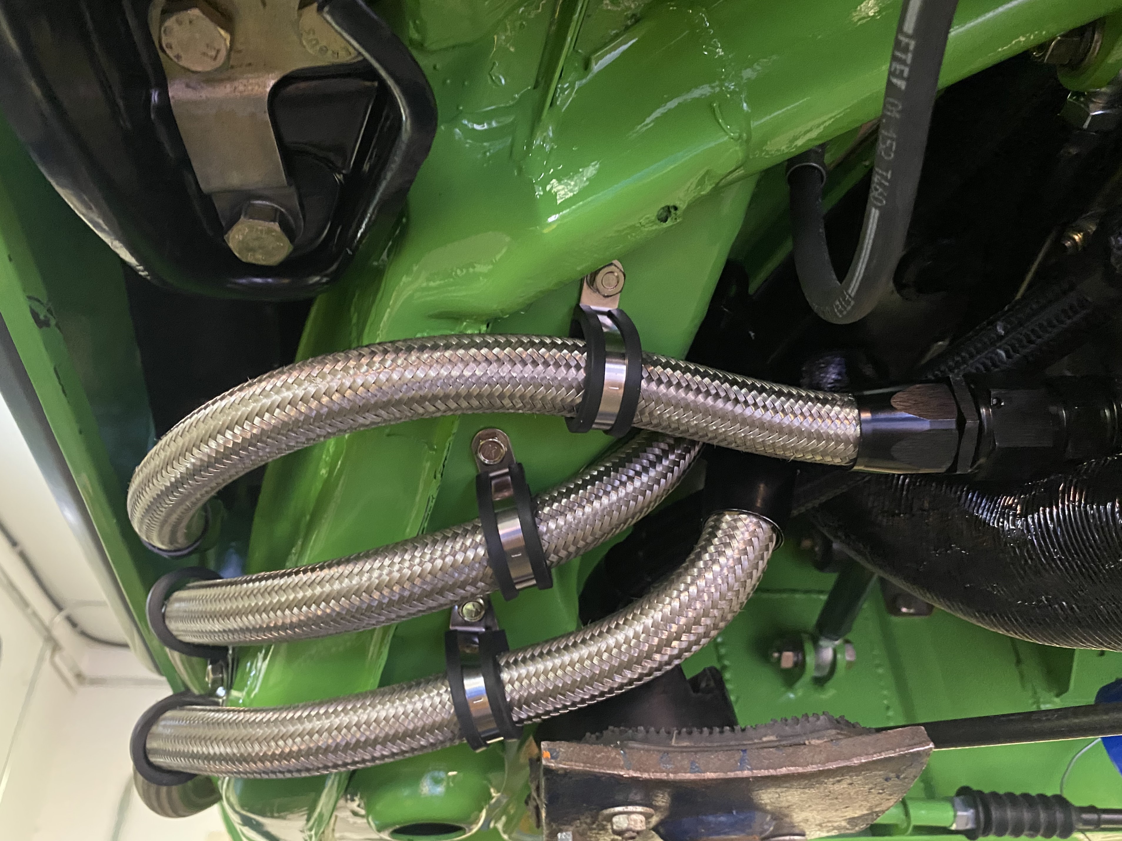

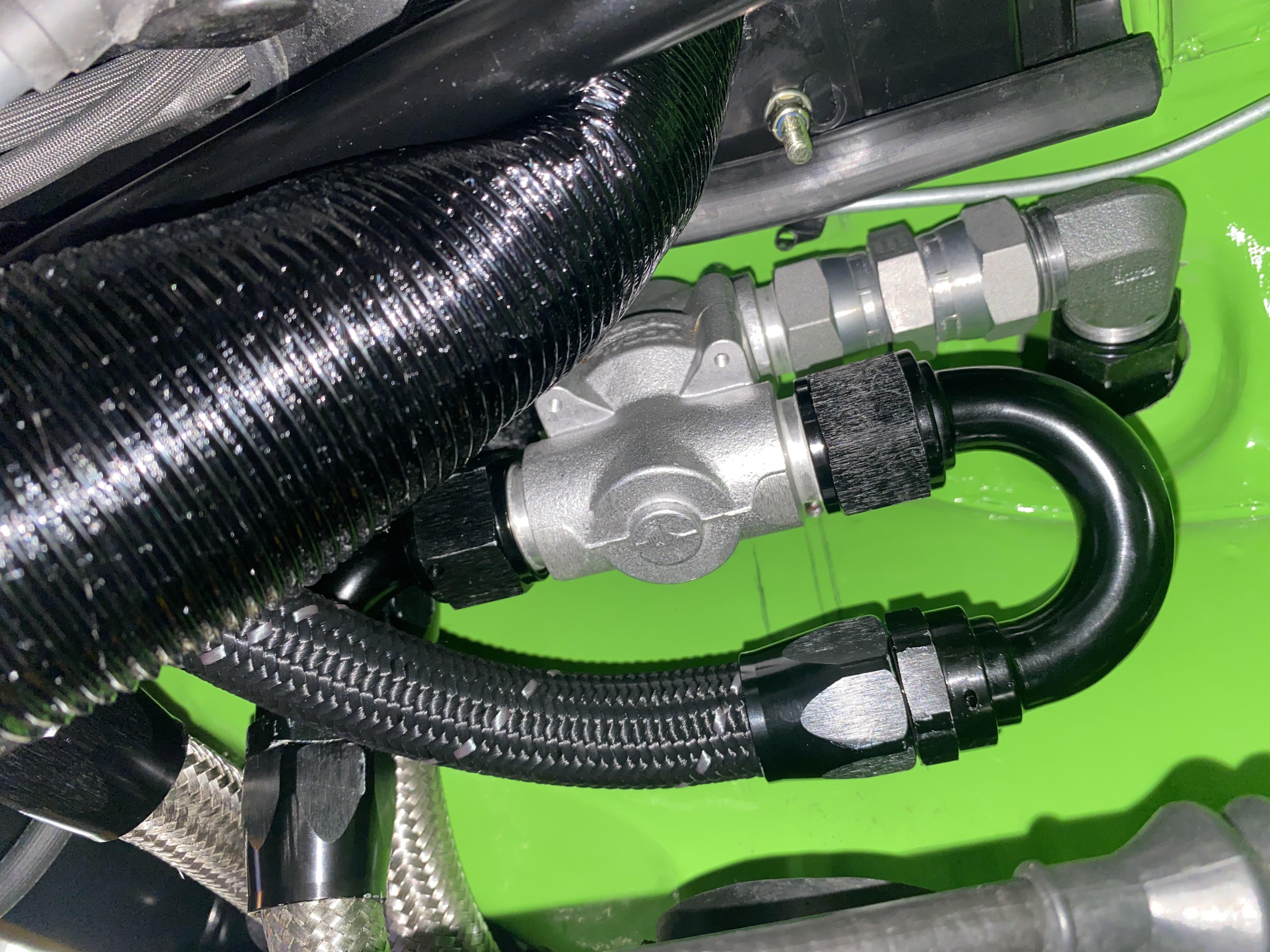

I brought the cooler lines and the oil tank feed line into the engine compartment secured with Adel clamps. The external T-stat was located on the driver's side.
I have put about 500 miles on the car and the oil temp stays rock steady at 180 deg F.

QUOTE(Tom1394racing @ Dec 19 2025, 05:52 PM) *
THanks Tom! I think this is the neatest set up yet! Very nice paint! (IMG:style_emoticons/default/biggrin.gif)
What size lines are you running?? I figure smaller lines higher pressure!
