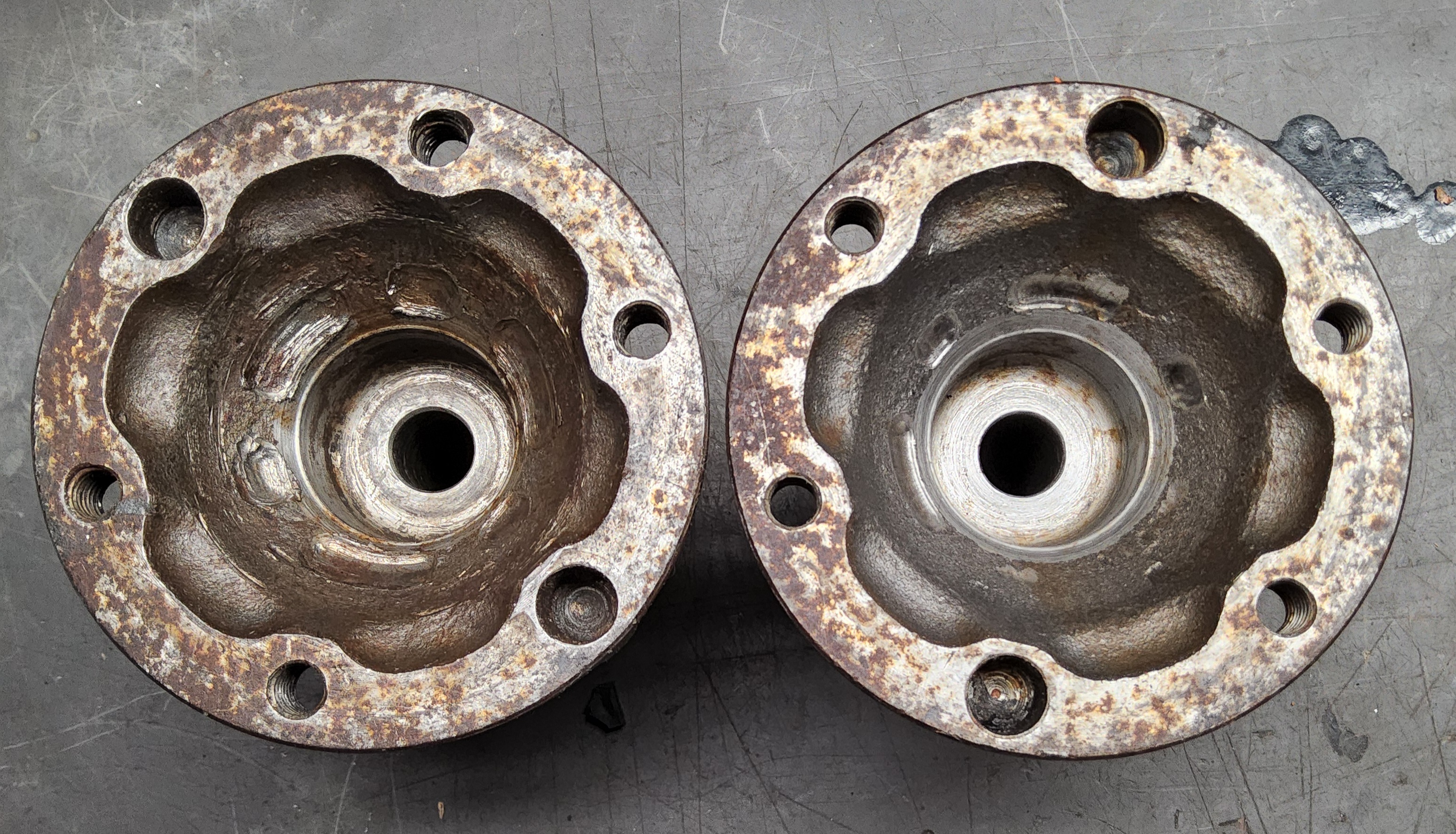

Today I started the process of dropping the engine & transmission so that I can send the transmission off to Dr. Evil and take care of some misc engine work (rear main seal, oil return tubes, etc. ). As part of this work I was also hunting for a clunking noise I hear from the back when the car is stopped and as I let the clutch out and the car just starts rolling forward. I already checked and/or replaced all suspension and engine mounts, as well as the outer CV joint bolts (inners are safety wired) and found nothing loose. So next on my list was either the CV joints themselves, or possibly loose flywheel bolts.
When I removed the inner CV joints from the transaxle flanges, I was surprised to see some pretty deep gouges in the flanges from the CV joint inner race/star (see photos below). This seems like a good candidate for the noise I am hearing.
I have never seen this type of wear before with any of the other cars I've worked on - what would cause this? I noticed that there is not much grease in the joints, which I suppose is one possibility. Was the inner race put on backwards? Wrong parts? I did confirm that the axle shaft does move in and out freely at the outer CV joint.

Krieger
post Dec 28 2025, 08:00 PM
Posts: 4,842
Joined: 24-May 04
From: Santa Rosa CA
Member No.: 2,104
I kept these to use as tools. (IMG:style_emoticons/default/biggrin.gif)

QUOTE(Krieger @ Dec 28 2025, 08:00 PM) *
Wow - thanks for posting that photo. The one on the left looks very similar to the damage on my left flange. So, I'm not alone..
I wasn't able to get the axles out tonight to measure them - it looks like I would need to remove the heat exchangers in order to do so, and I'd like to avoid that. So, I'll wait until after the engine is out to remove the axles - targeting mid-week.

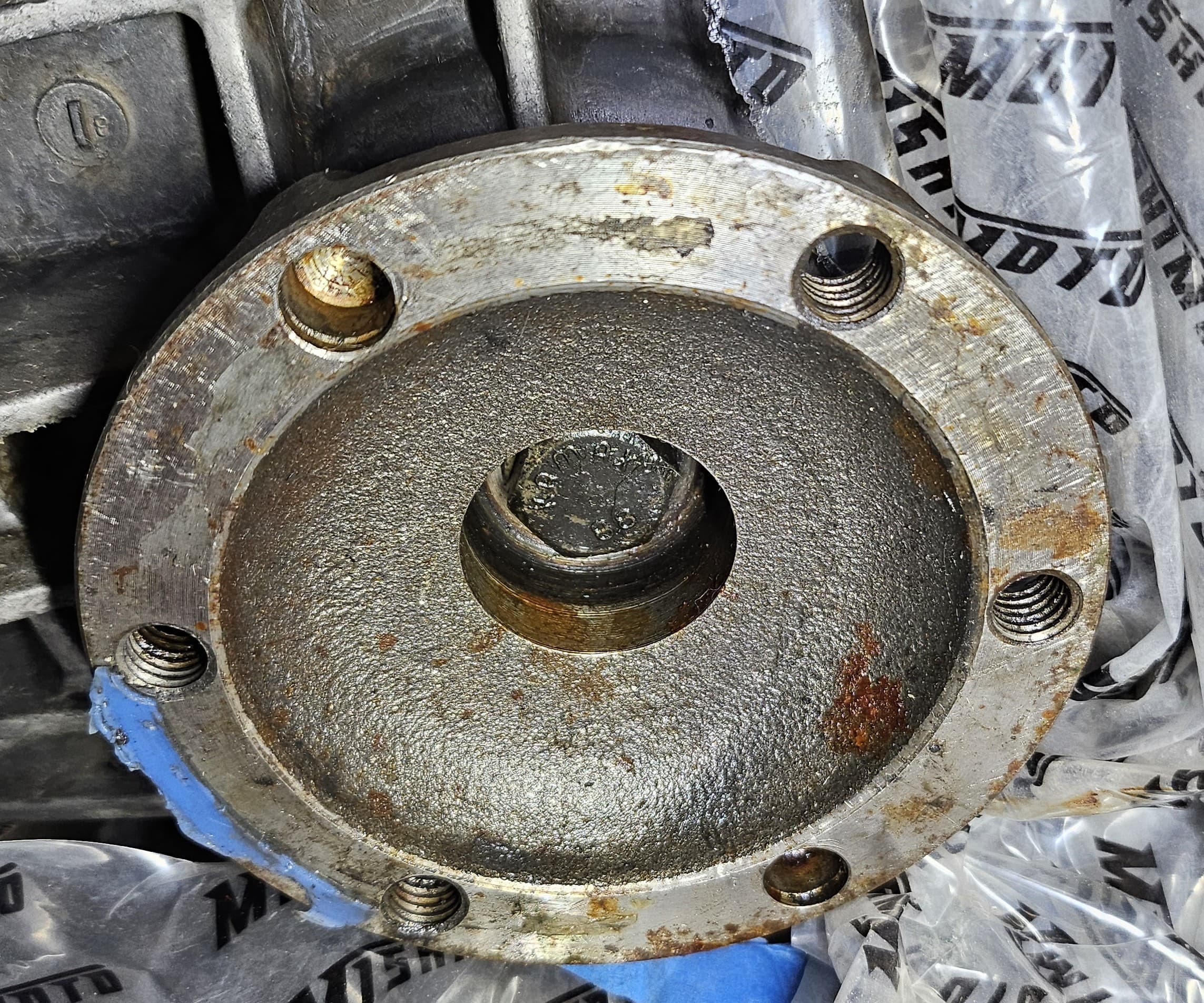

Out of curiosity (and to confirm to myself that I didn't overlook this type of wear before) - since my '73 911 is conveniently disassembled, I took a look at the flanges on its 915. As you can see, not a scratch:
