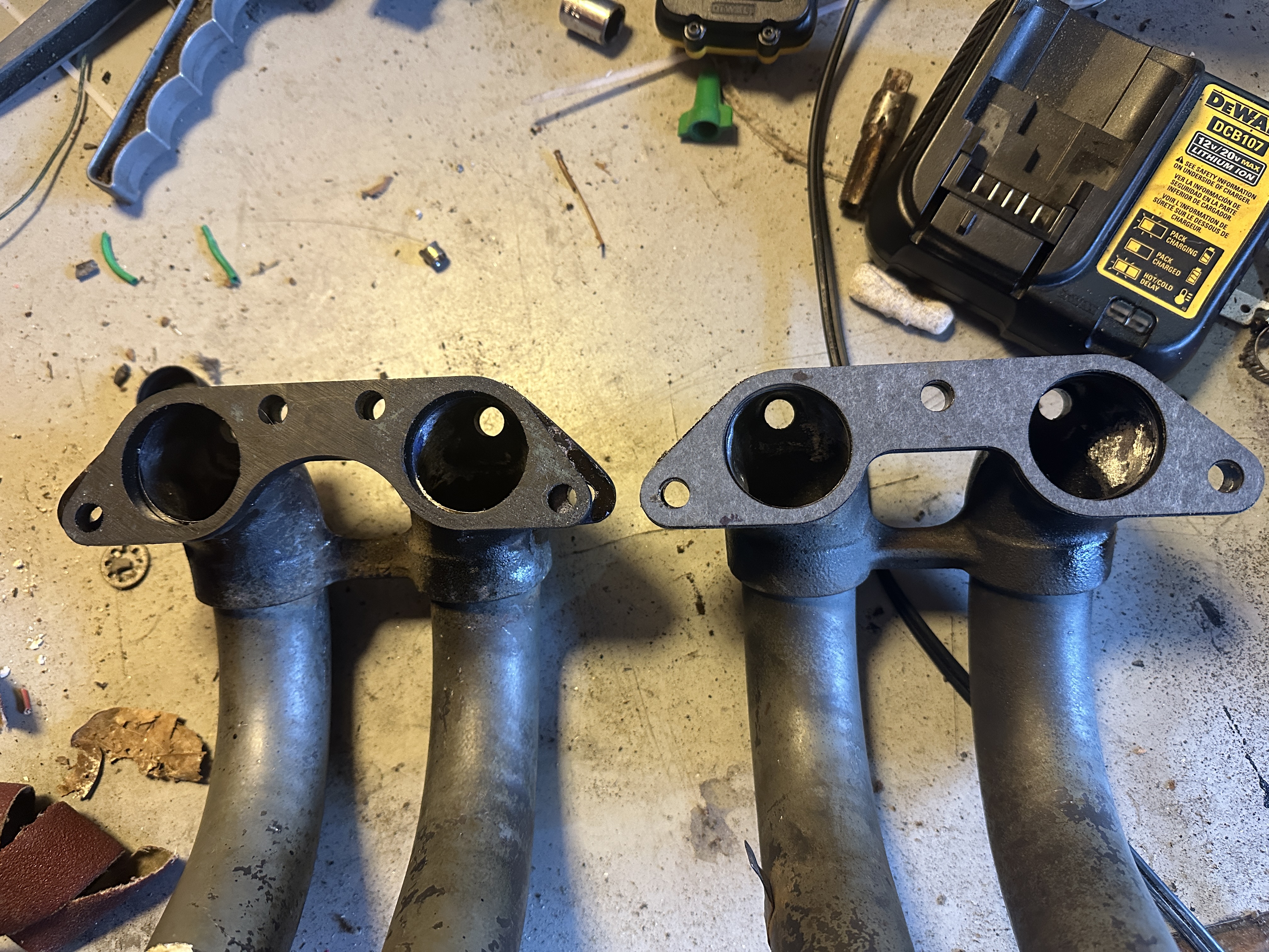

How are people fitting the Ljet intake manifolds to work with 2.0L heads? FWIW this will be on my 2056.

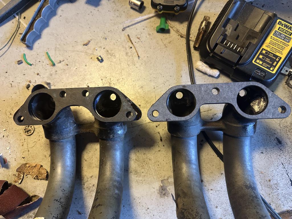

PROGRESS:
While I had the welder out for the O2 bung, I decided to finish up the LJet intakes for 2.0 head pattern...
I will blast and Cerakote once I remove a small dent or two from the tubes...
For comparison the 1.8 gasket and the 2.0 gasket if overlayed on the intakes to see the amount that needed welding
Was fun brushing up on my welding skills and Draw filing....

rfinegan   PROGRESS: While I had the welder out for the O2 b...   Dec 30 2025, 01:38 PM
