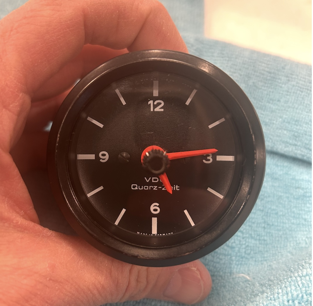

Does anybody have a working clock in their center console? It seems like everyone clock has died.
I bought a reproduction clock from Auto Atlanta and it broke in less than a year. Complete waste of money.
Has anybody sent their clock to be rebuilt and if so how did it work out?
I think I read somewhere that only 914 clocks with a date stamp of 75 or 76 can be rebuilt as the internals changed?

I was finally able to cobble together a working and new looking clock. I used the housing, bezels and seal from my original clock (that had broken gears). I ordered one of those Audi Fox/VW Dasher clocks movements off of eBay that Mark @914Sixer recommended. He was right, it’s identical other than also having a second hand, which I removed. It was pretty simple to swap in. I removed and repainted the needles from the Fox/Dasher clock and swapped on the 914 clock face. Lastly, I used the plastic lens from the broken Auto Atlanta clock since it was basically new and not scratched up like the other plastic lenses I have on hand. Works and looks good. Before crimping the bezel back on, I’ll respray it (to match my other restored center console gauges) and then call it a day on this project.
