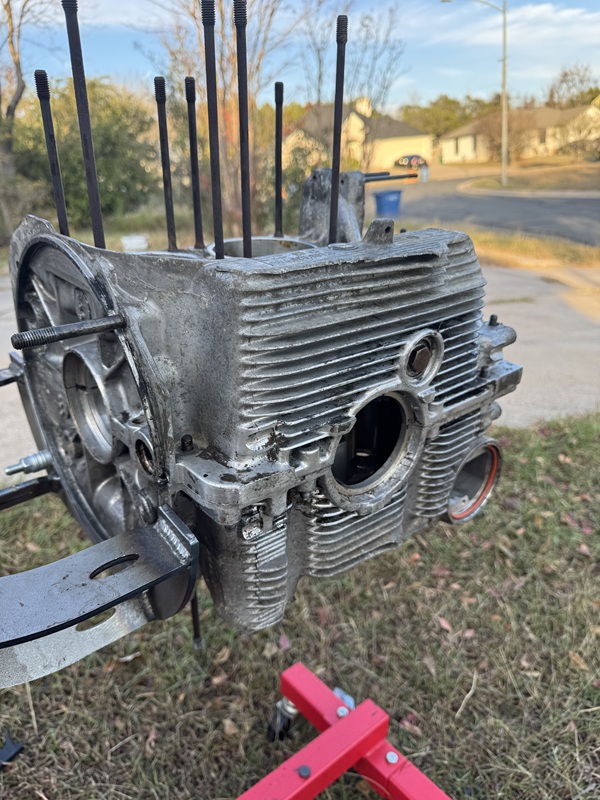

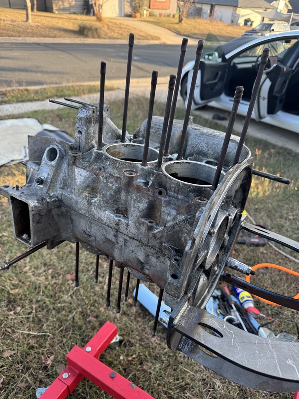

I got the engine case split and got all of the components out of the engine. With the help of members here I got to cleaning the engine case on an initial pass to get it clean enough to go to the machine shop to drill out all of the oil galley plugs. Finding out that my case has WELDED oil galley plugs. (They ain't comin' out). Called a local machine shop with experience in these engines and they said they have seen it in the past and that they can machine the weld off and get the oil galley plug out. I have been loving the process of learning as I go as I go deeper and deeper into the rabbit hole!
Attached ImageAttached ImageAttached Image
