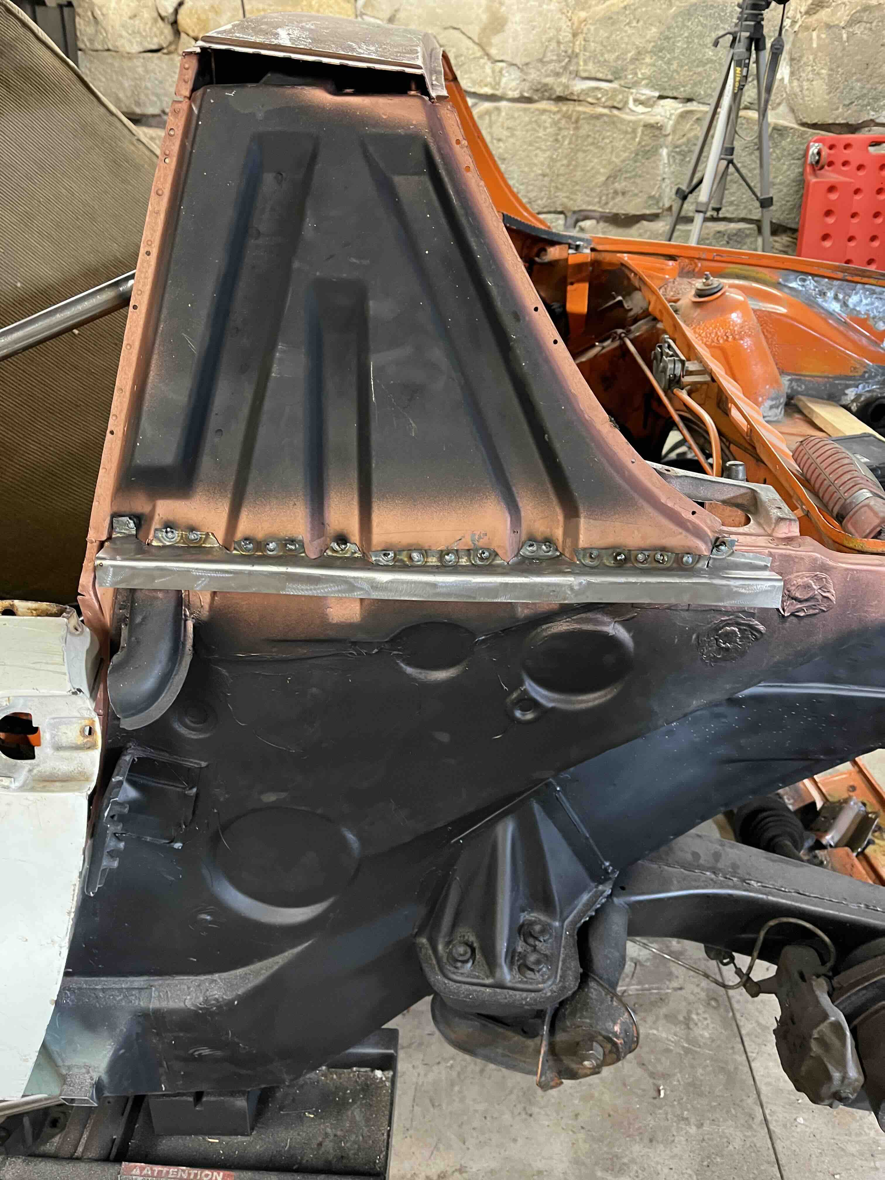

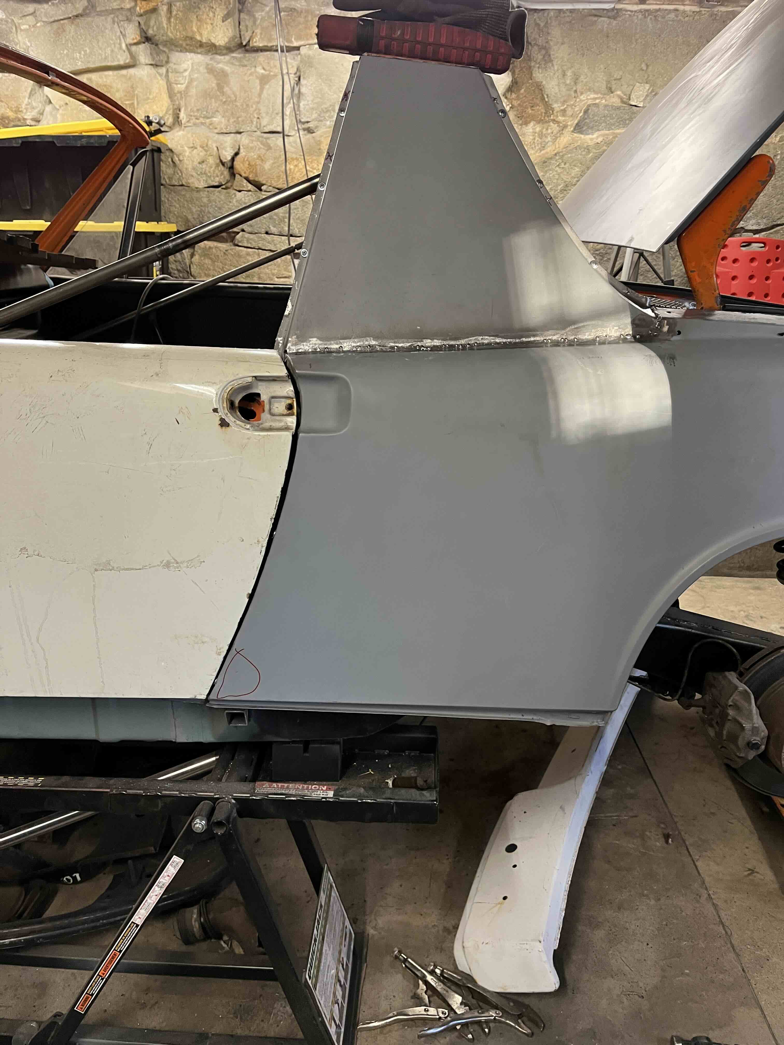

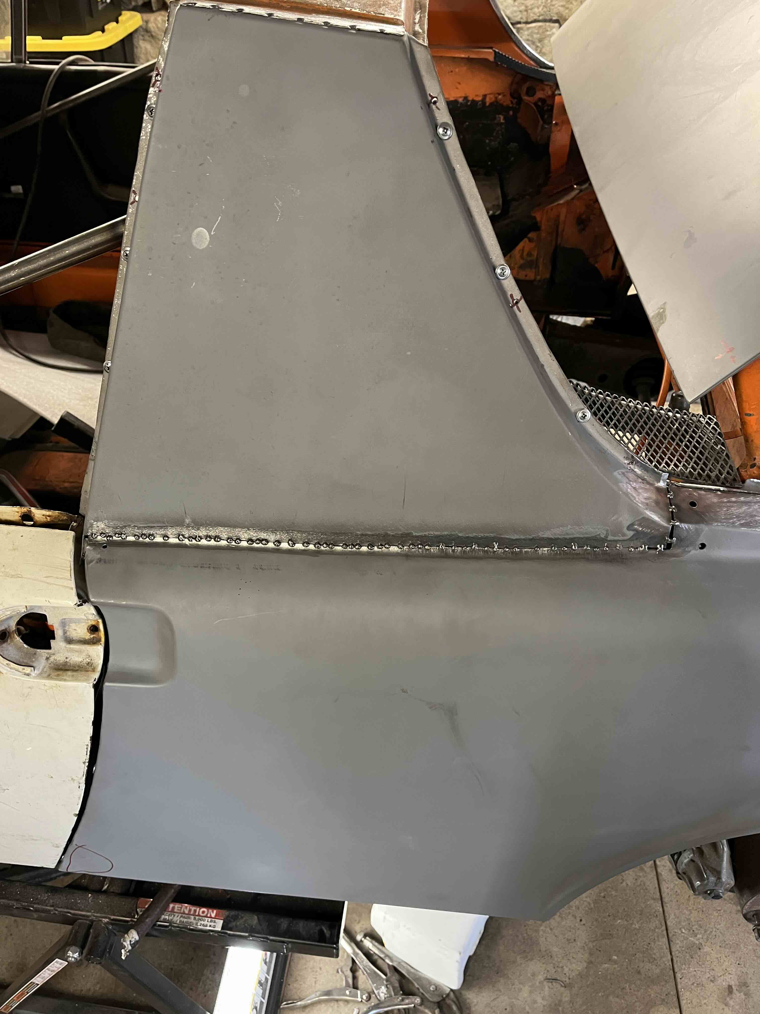

Been plugging away at this consistently since the last update, with some breaks for family time over Thanksgiving and Christmas; lots of progress and I'm a lot more hopeful this will be a real car again.
I used Fred's suggestion of assembling the rear quarter and door jamb as a single unit before spot welding to the chassis. This allowed me to properly treat and seal the quarter to door jamb area. In my case this meant not only putting those two pieces together, but also stitching on the RD sail panel repair section.
I had to re-create the baffle that seals crap from getting between the rear quarter and into the sail panel area; came out ok.
There was a lot of repetitive fitting, checking, re-fitting, re-checking as I got things pieced together and before I started spot welding the quarter to the chassis.
