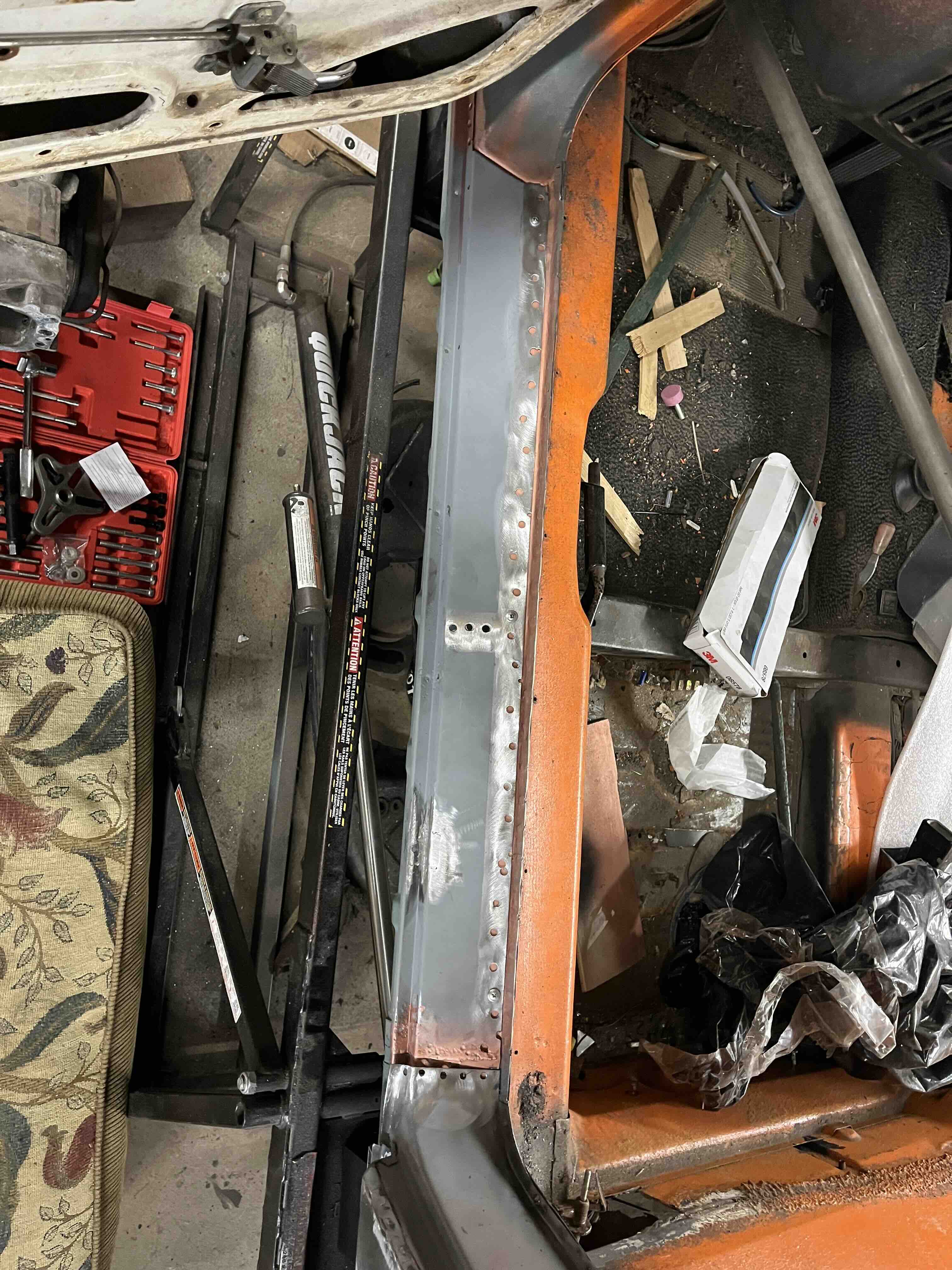

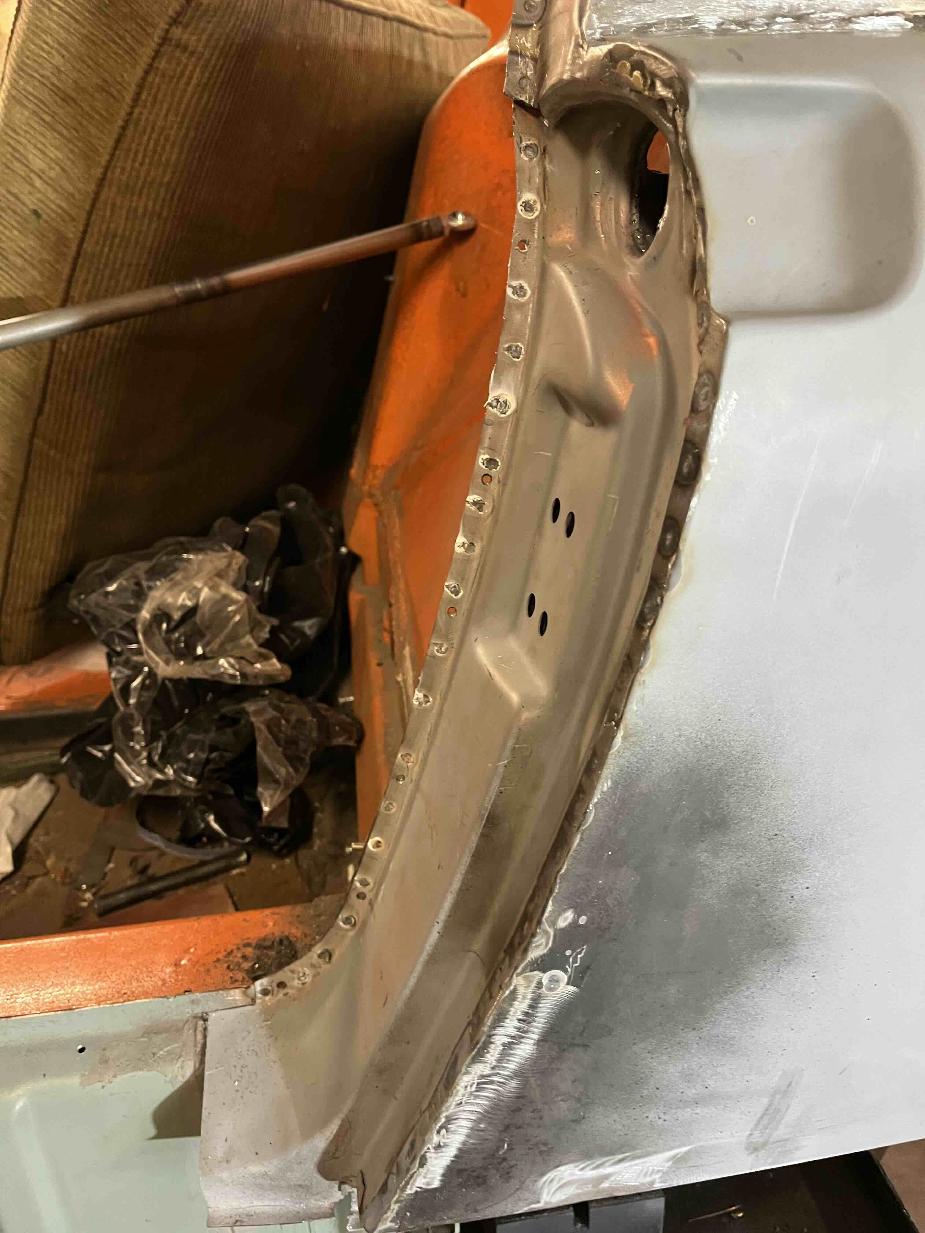

Once I was confident that things were lining up properly at all of the various reference points I summoned up the gumption to weld the quarter onto the chassis.
Then I welded the door threshold back on to complete the welding work from LH front fender area.

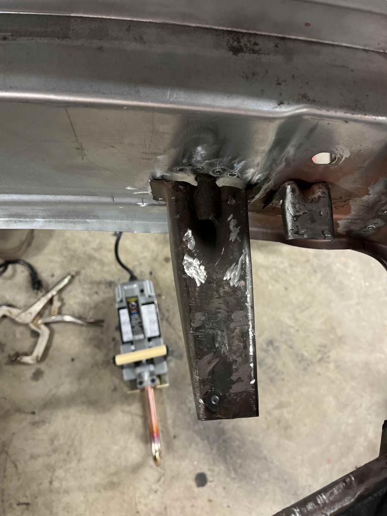

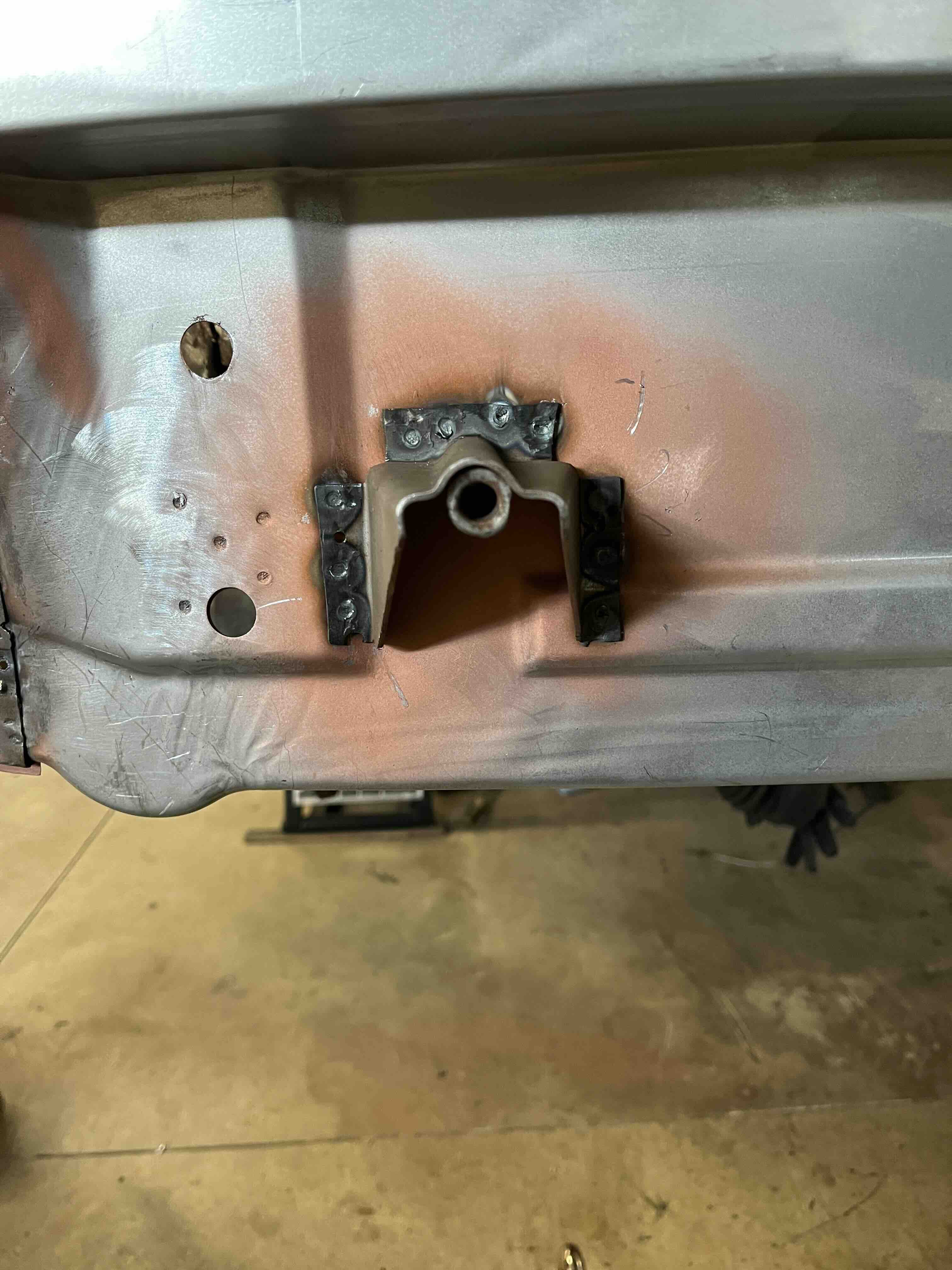

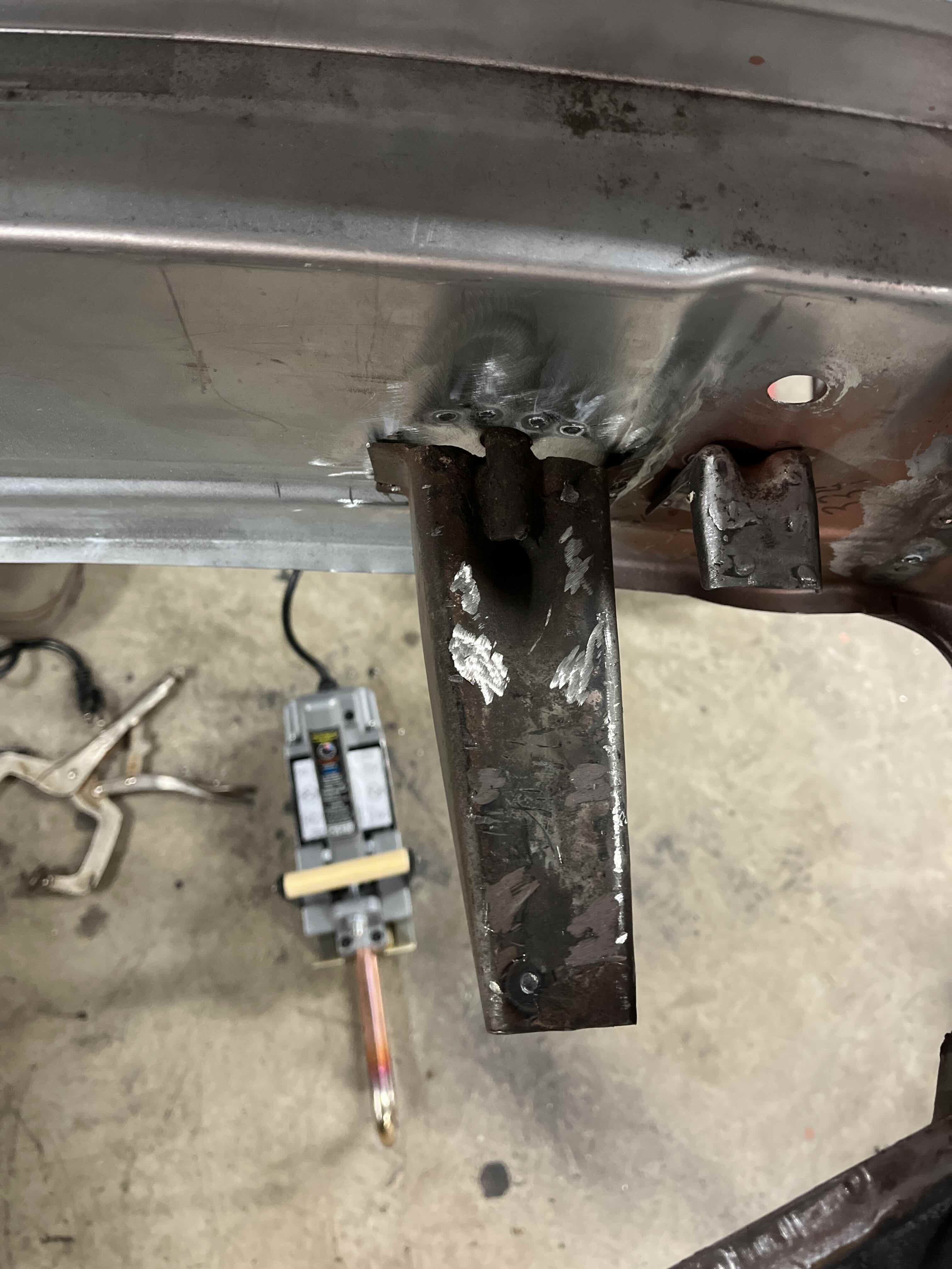

I wasn't sure (and still am not) why some cars have and some don't have the bracket for the rear tow eye loop. I was scavenging brackets off of a tail section piece that had a nice tow hook bracket so I figured I'd throw it on the car. I've abandoned the idea of a stock car and am basically modifying on the fly at this point, so what the hell. Getting all the tail panel brackets welded on was a lot more time consuming than I counted on....
