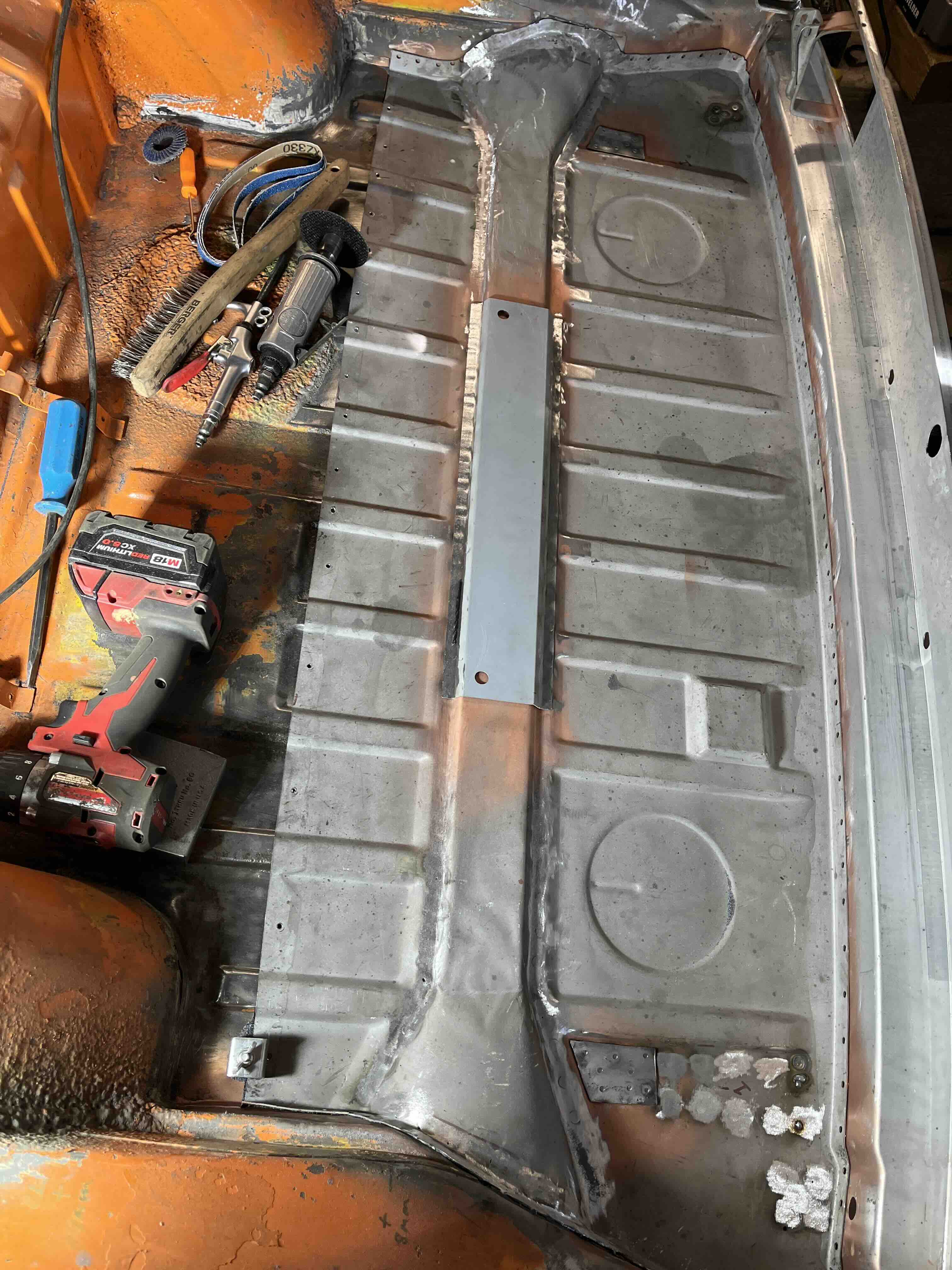

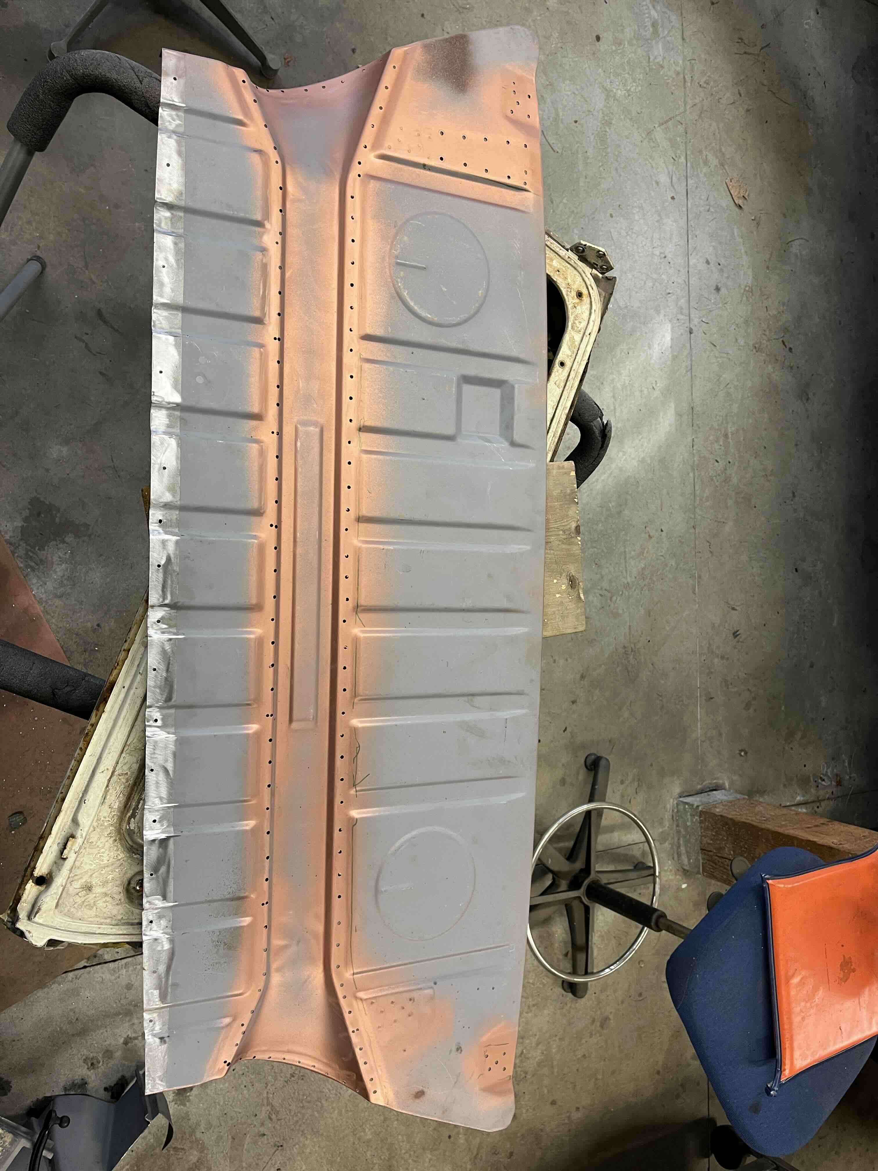

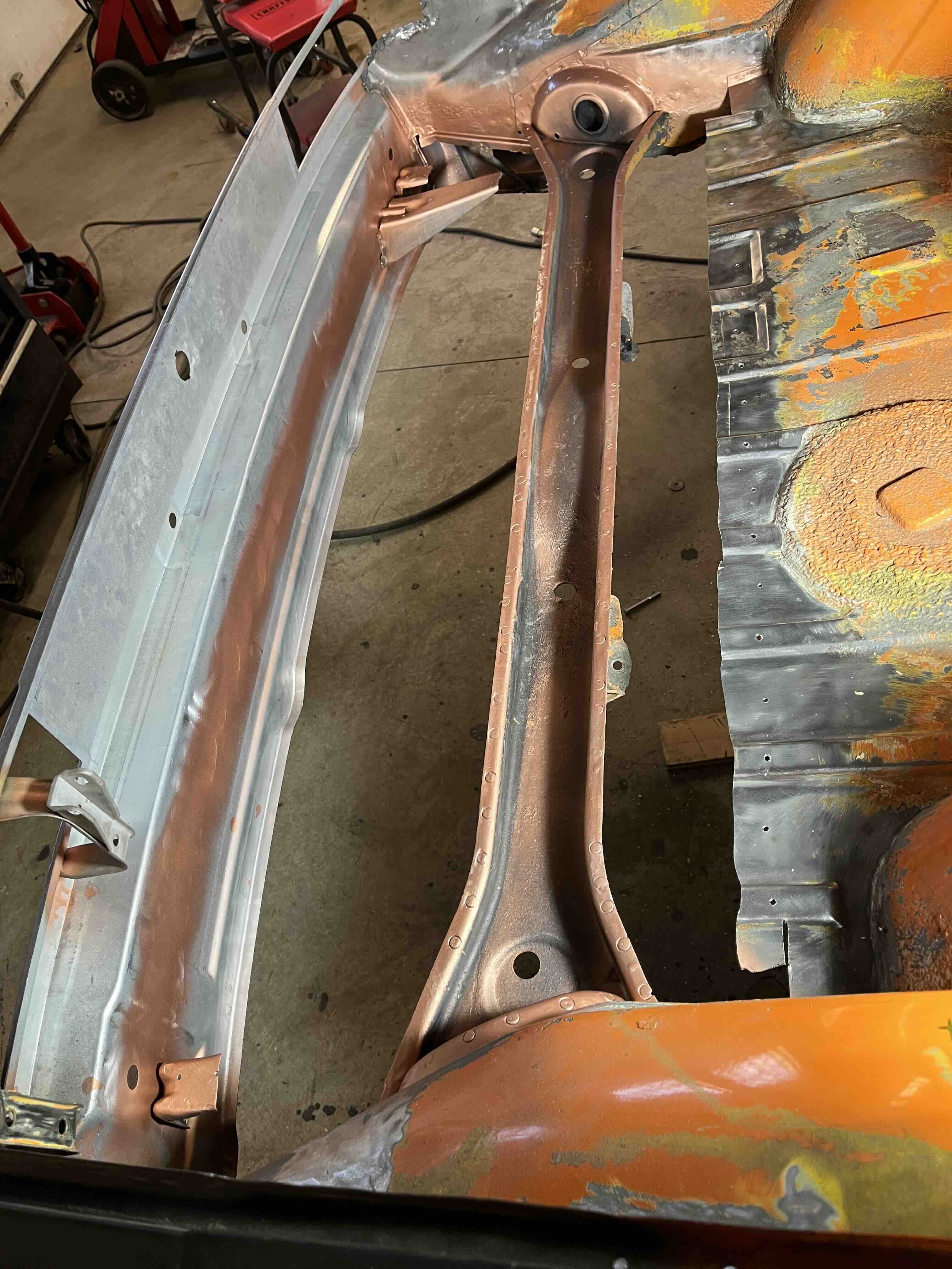

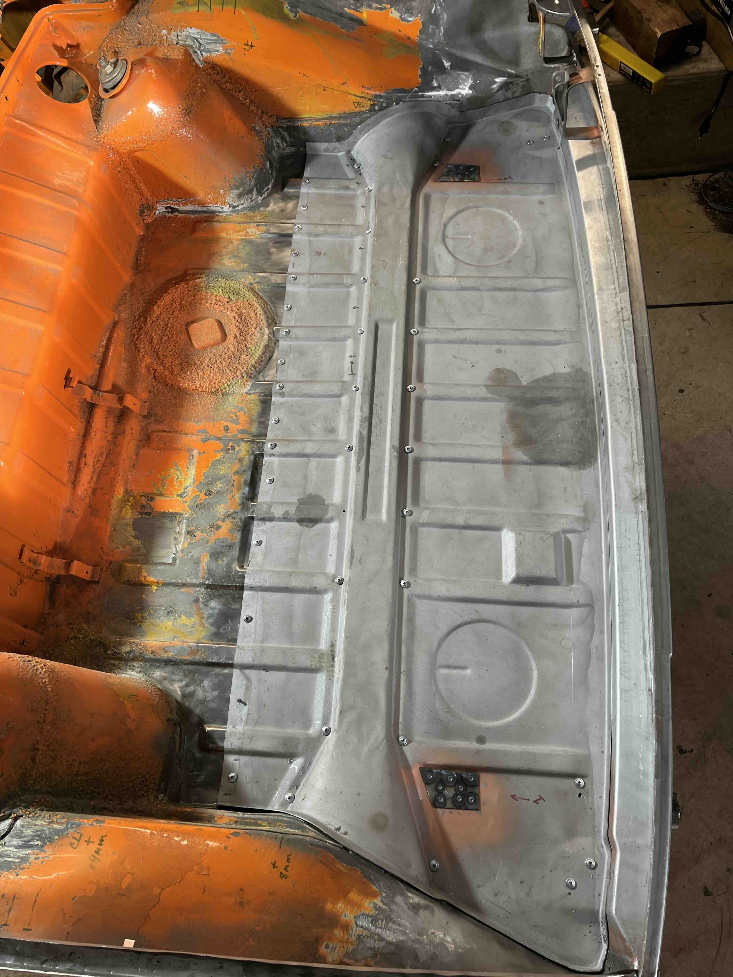

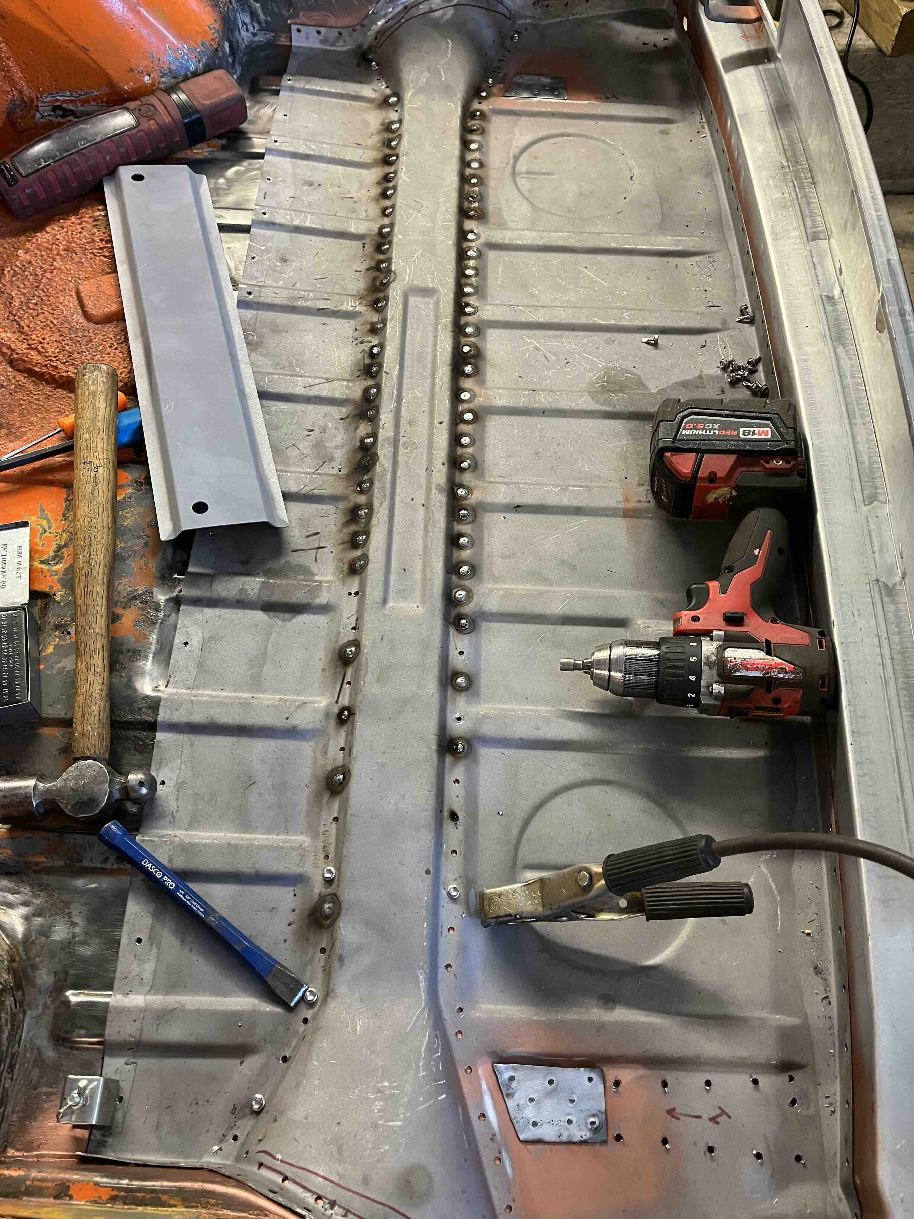

Next came final fitting and welding of the RD trunk floor patch. Lots of fitting, removing, re-checking, tweaking, and prep before the satisfaction of practicing my plug weld technique.
