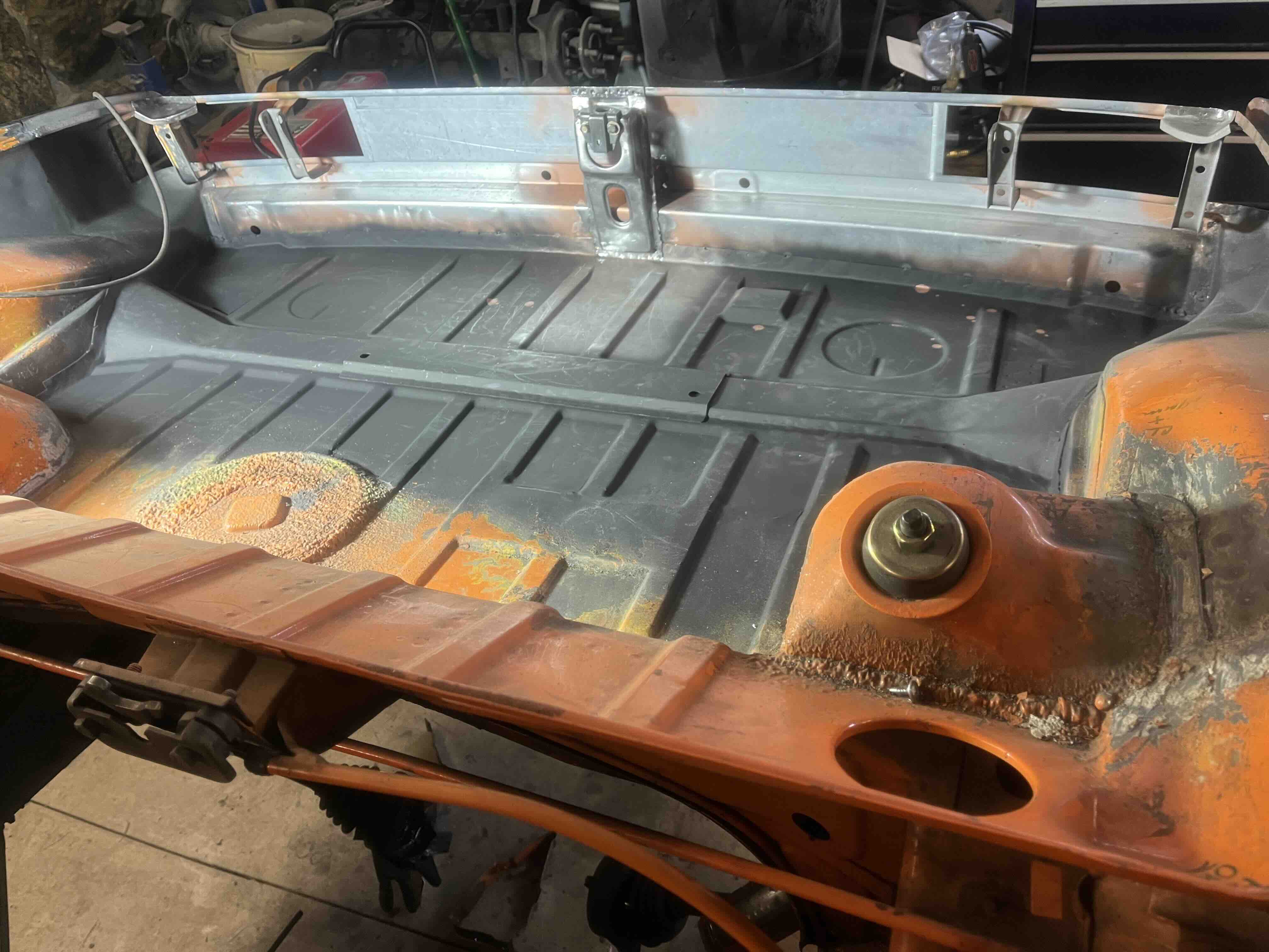

Next came the butt welding of the rear trunk floor repair section which gave me LOTS AND LOTS of practice on my welding technique...and let me try out some improvements thanks to lots of great contributors on YouTube.
Once that butt weld was finished there were a few plug welds to complete and then the LH tail light brackets, corner reinforcement bracket, and the trunk latch bracket. These were all salvaged so there was a lot of time to clean, straighten, and prep them before welding them in.

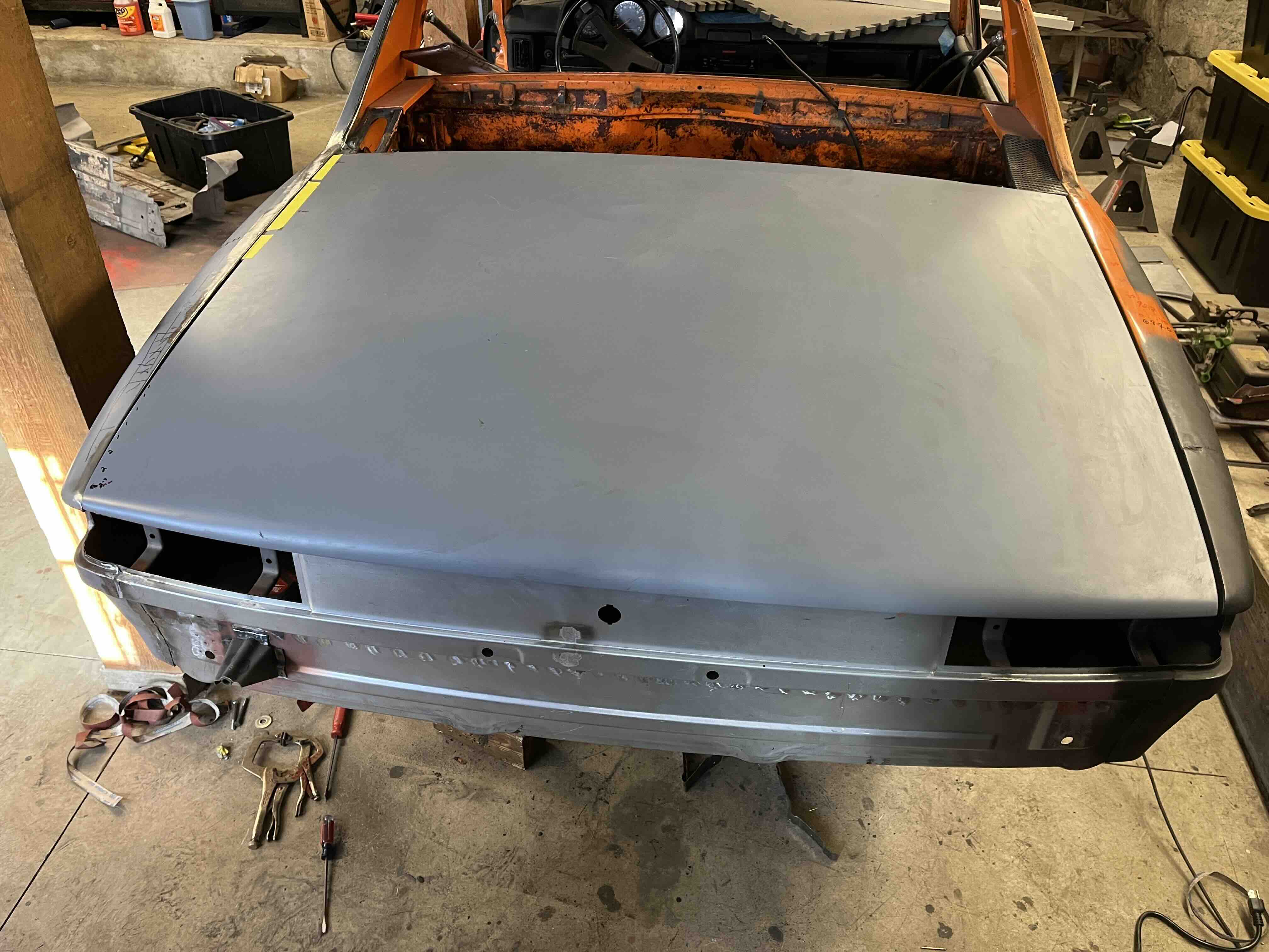

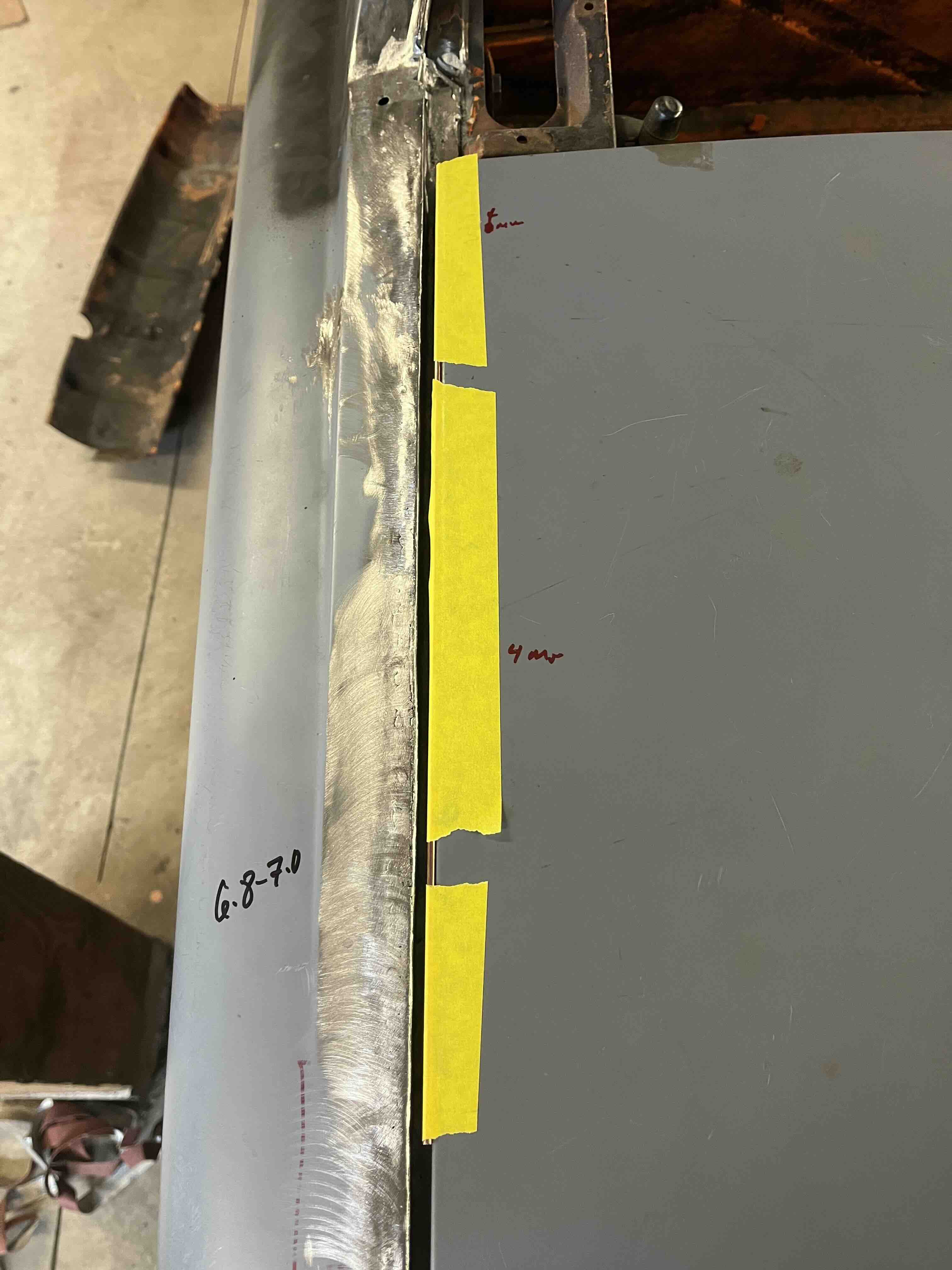

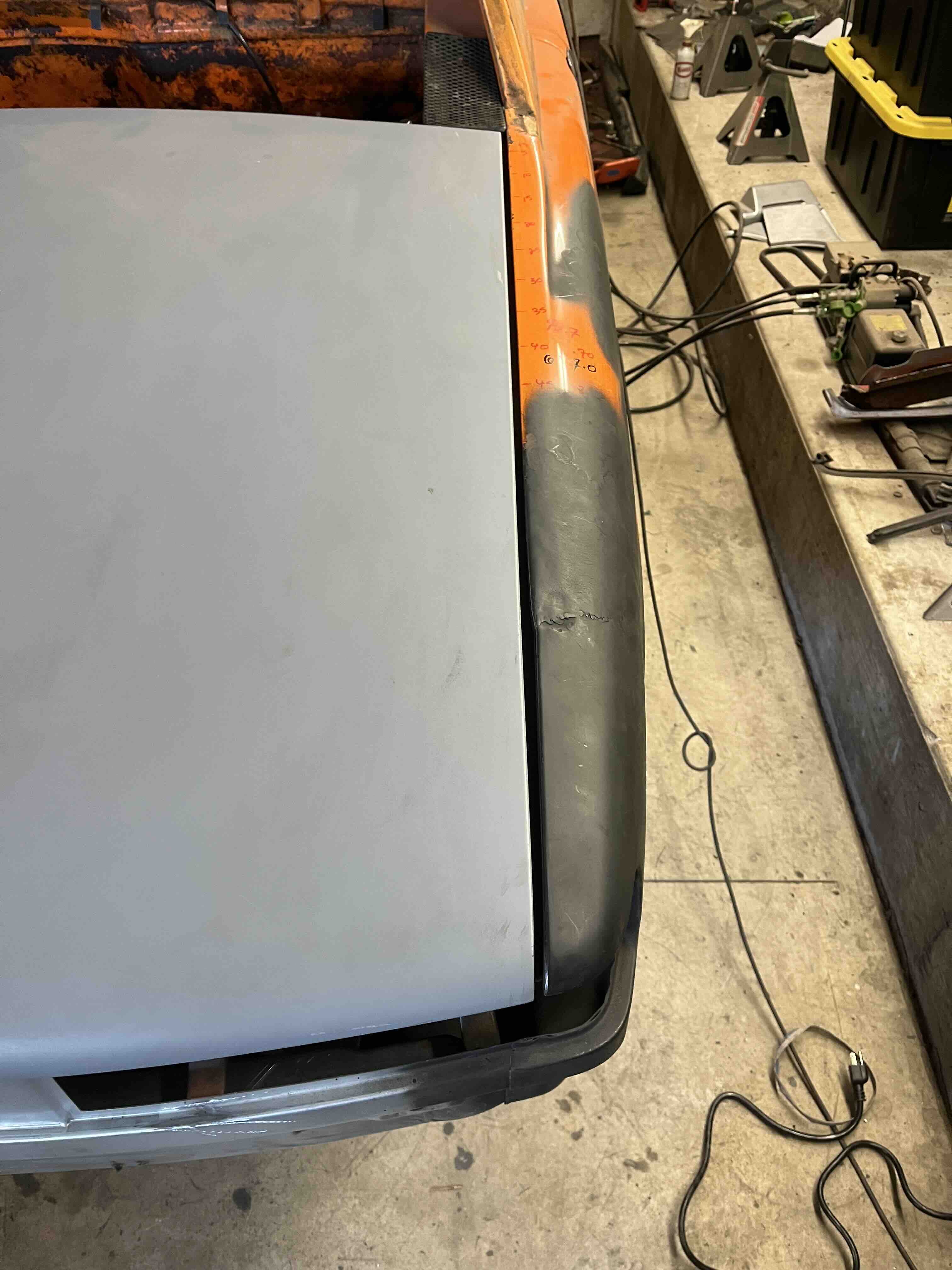

At this point, since I had a complete rear end and a functioning latch, I pivoted back to the trunk lid and the problem of the gaps to the quarters. I figured I could "fix" the position of the deck lid by adjusting the latch and then figure out where I needed to add material to the deck lid to get acceptable gaps. This has been the most frustrating and time consuming exercise so far (farting around with these particular body gaps).
That said, they are looking ok and I think that with some judicious welding on of TIG rod and then some grinding things will be good enough for filler work down the road.
