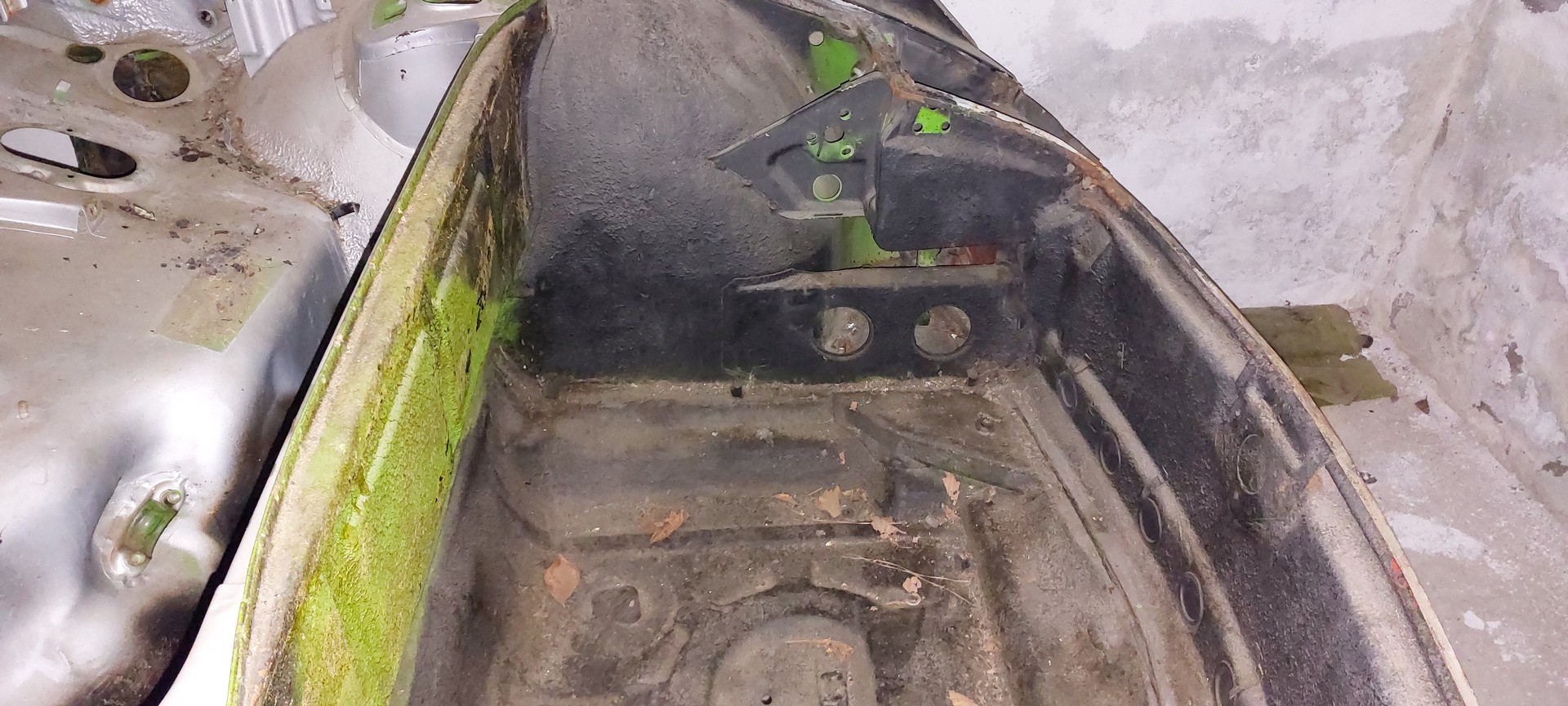

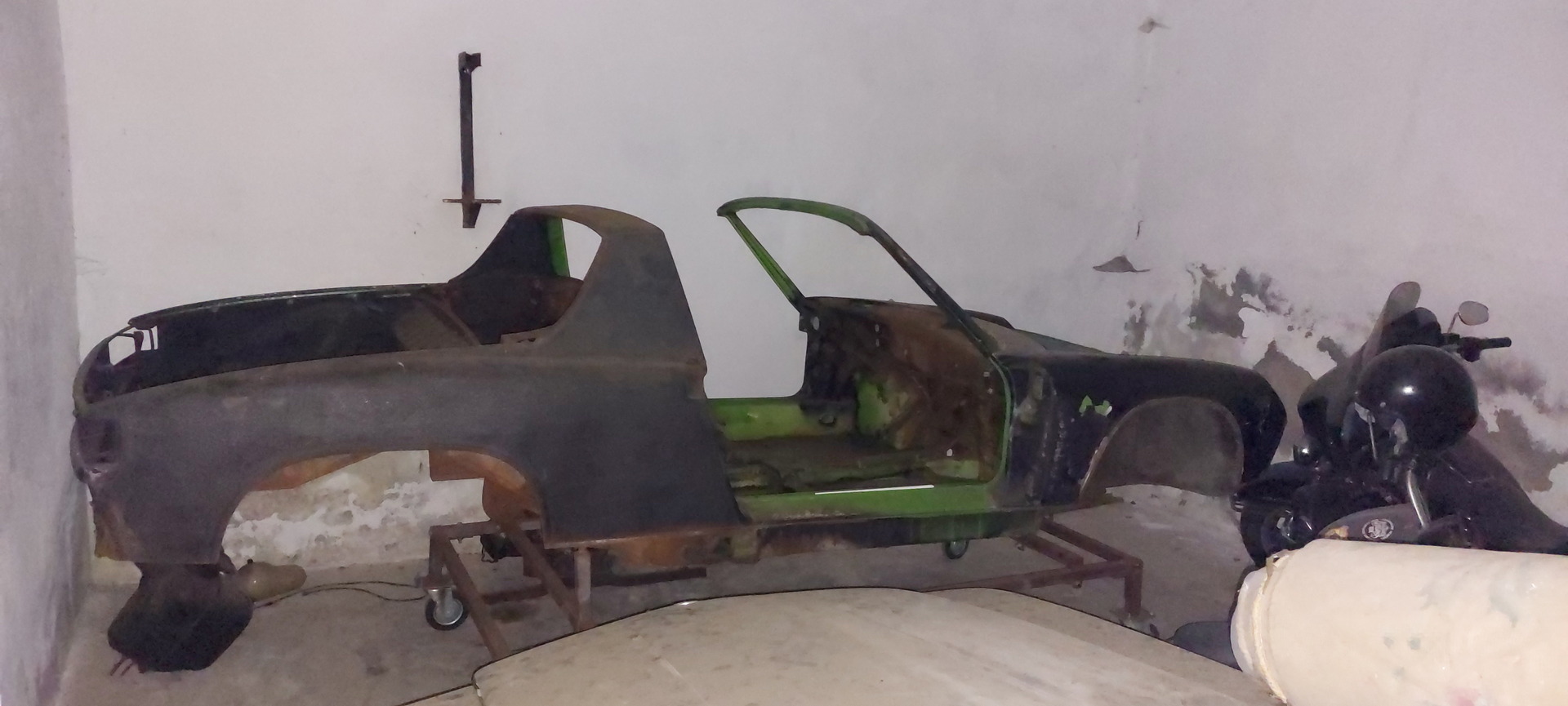

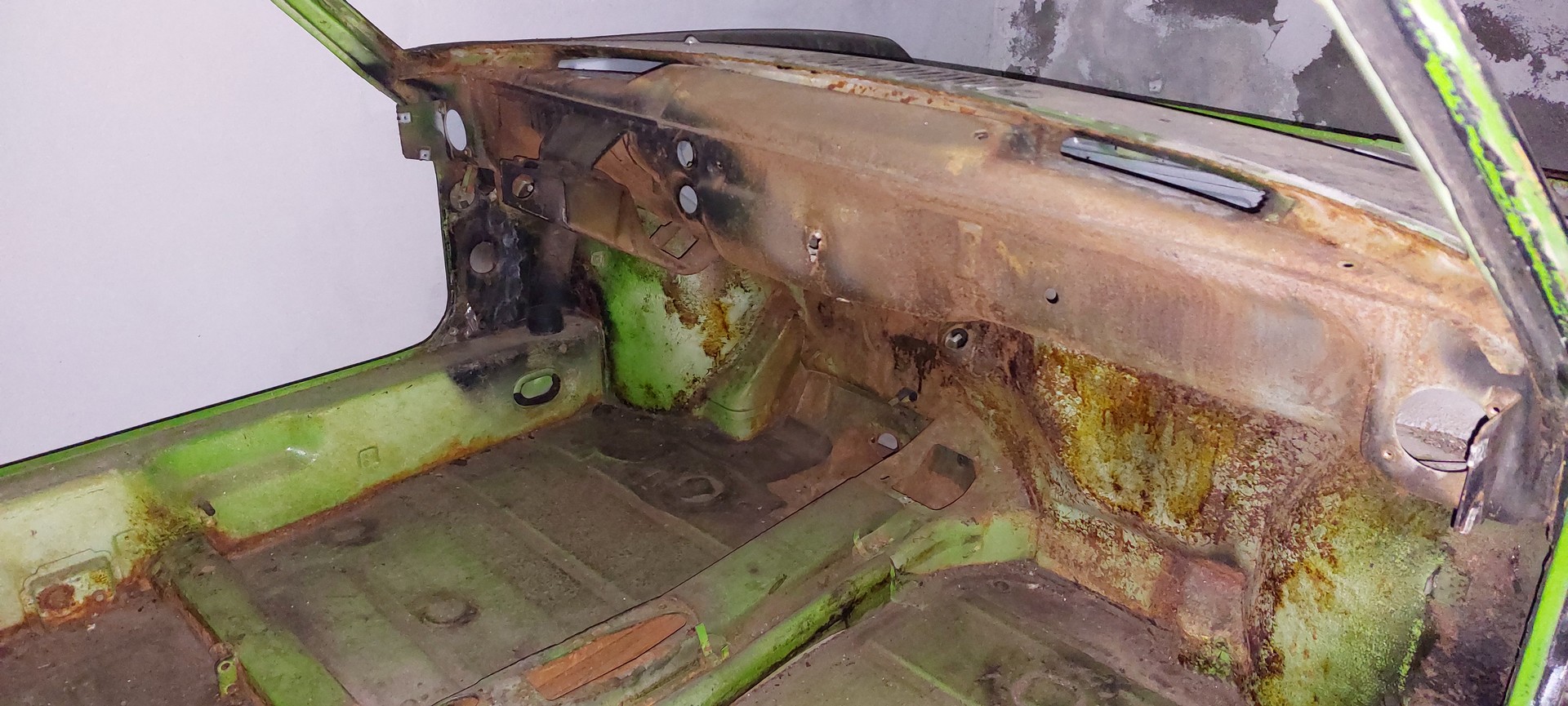

Thank you very much for your write up here. I really appreciate your knowledge (IMG:style_emoticons/default/pray.gif)
But I don´t really think this is Frankenstein job as such:
1. Original Sunflower yellow seems to be the first paint everywhere (front and rear)
2. I can´t see any signs of non original welding between front and rear
3. Most later parts (73´s) were supplied from burnt donor car. I got plenty of spare parts with my 914 (3x gearbox, 2x 1.7L and 1x 1.8L engines, 4x seats, 2x dashboards, 3+3 bumpers, etc.)
Obviously I can be wrong ´cause I have nowhere near your experience (IMG:style_emoticons/default/blink.gif)
Yes. You´re right.
My car has a Bus engine fitted. Unfortunately there´s no engine number so I only suspect it is 2.0L. But I want to sell this and build "Porsche" engine 1911cc on Webers from scratch.
Gearbox is also replaced for side-shifter intead of the original tail-shifter.
I believe that this donor car was complete 1.7L from 1973 with burnt engine bay and partially interior. It was stripped down and some parts installed onto mine 914. I have a really bad access to it so can´t check chassis number now but engine number is EA012447
Hopefully it makes a bit more sense now
