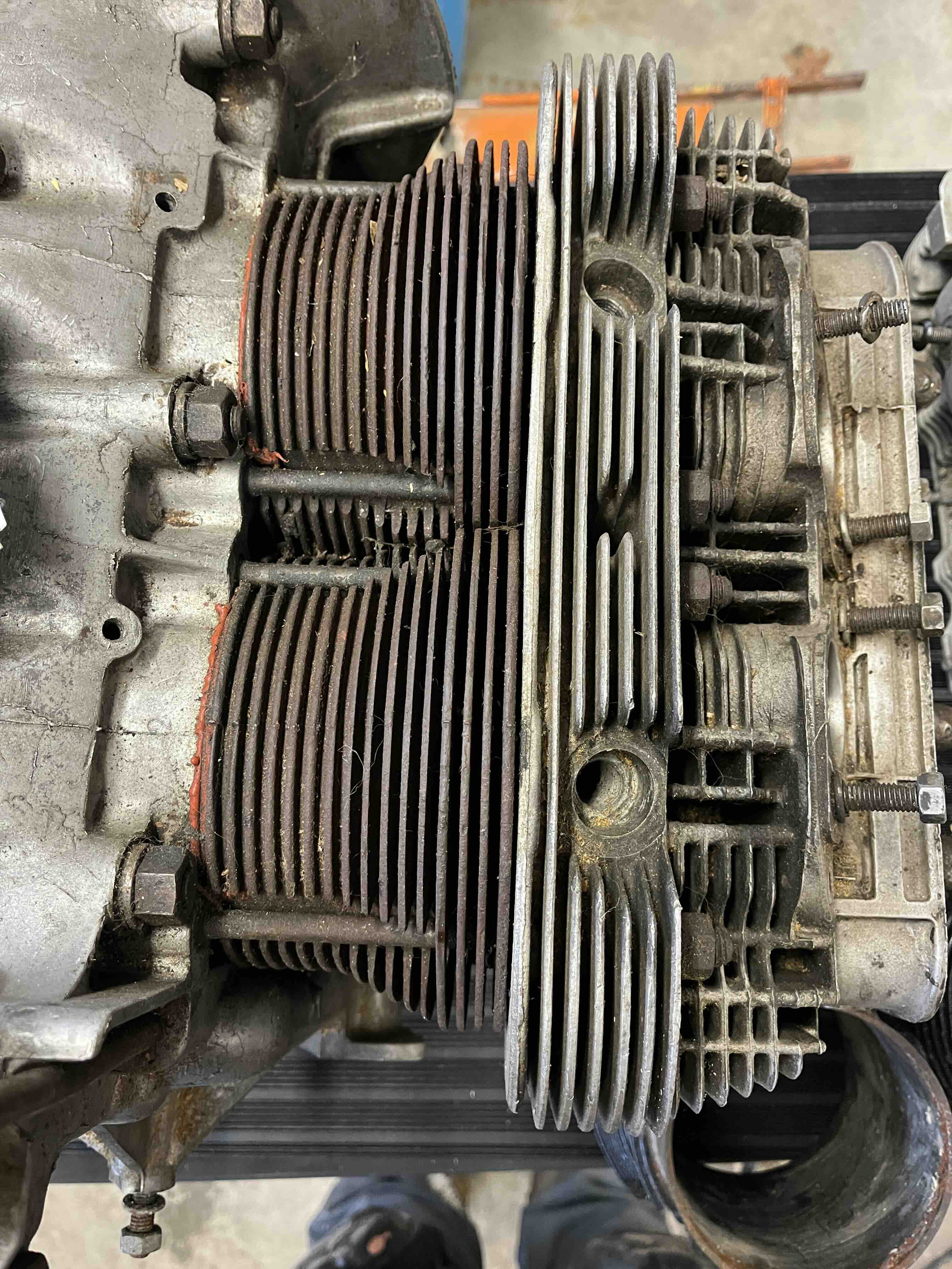

When I got the engine it had the #3-4 head pulled, missing two valves, and the jugs loose. I measured the jugs and found they are 102mm so I went from thinking I had stock engine to excitement about a big bore. Today I took a closer look at it and here's what I'm dealing with (spoiler: probably just a case and internals and maybe pistons that need to be fully built back up).
The jugs are magnetic and steel, with some minor rust on one end from where they were sitting.

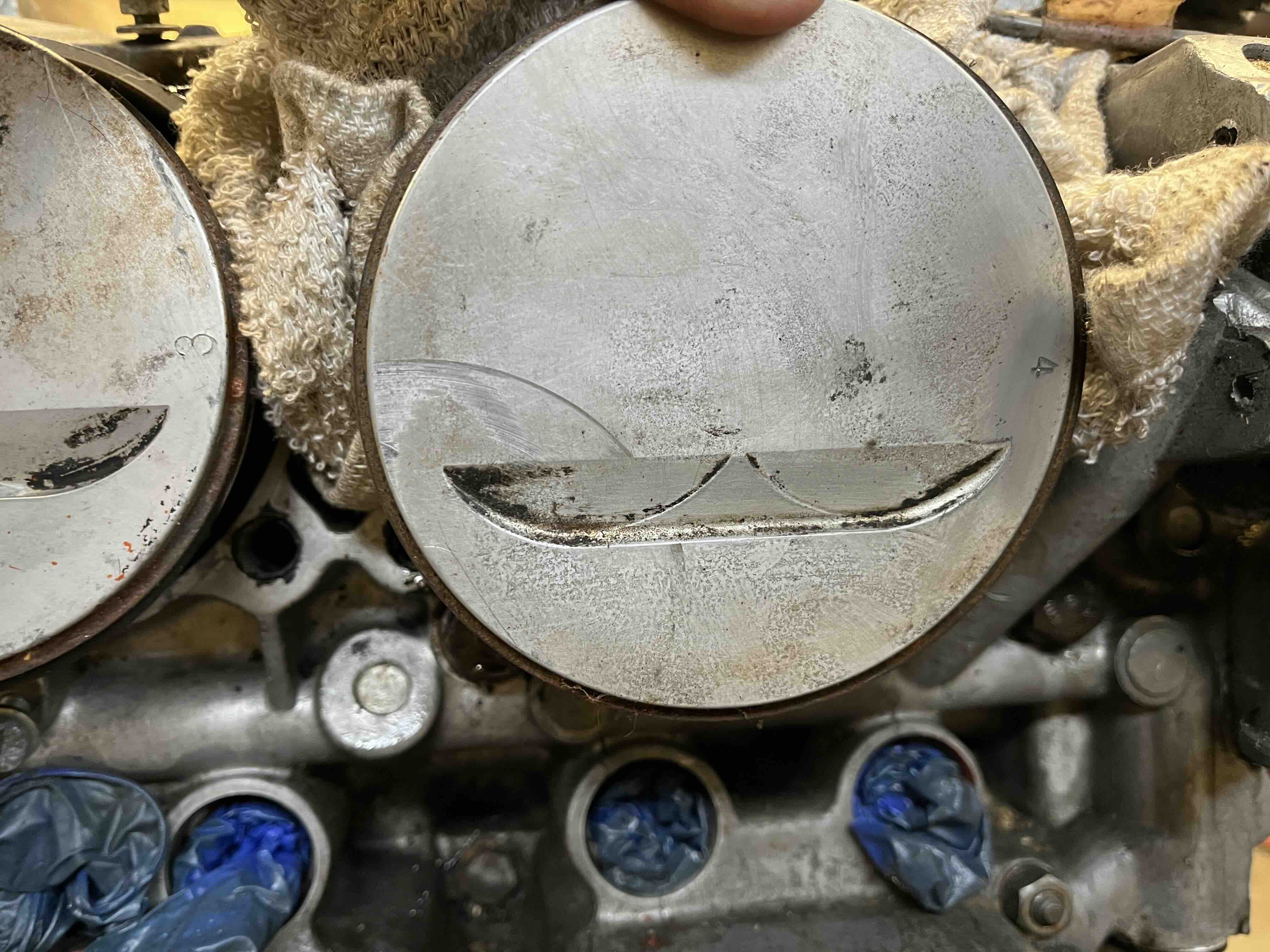

The pistons are Marked JE SRP 40F and as the photos show the (?) #4 has a surface scuff. I've never rebuilt an engine so I don't know if that means the pistons are junk or if they can be reused.

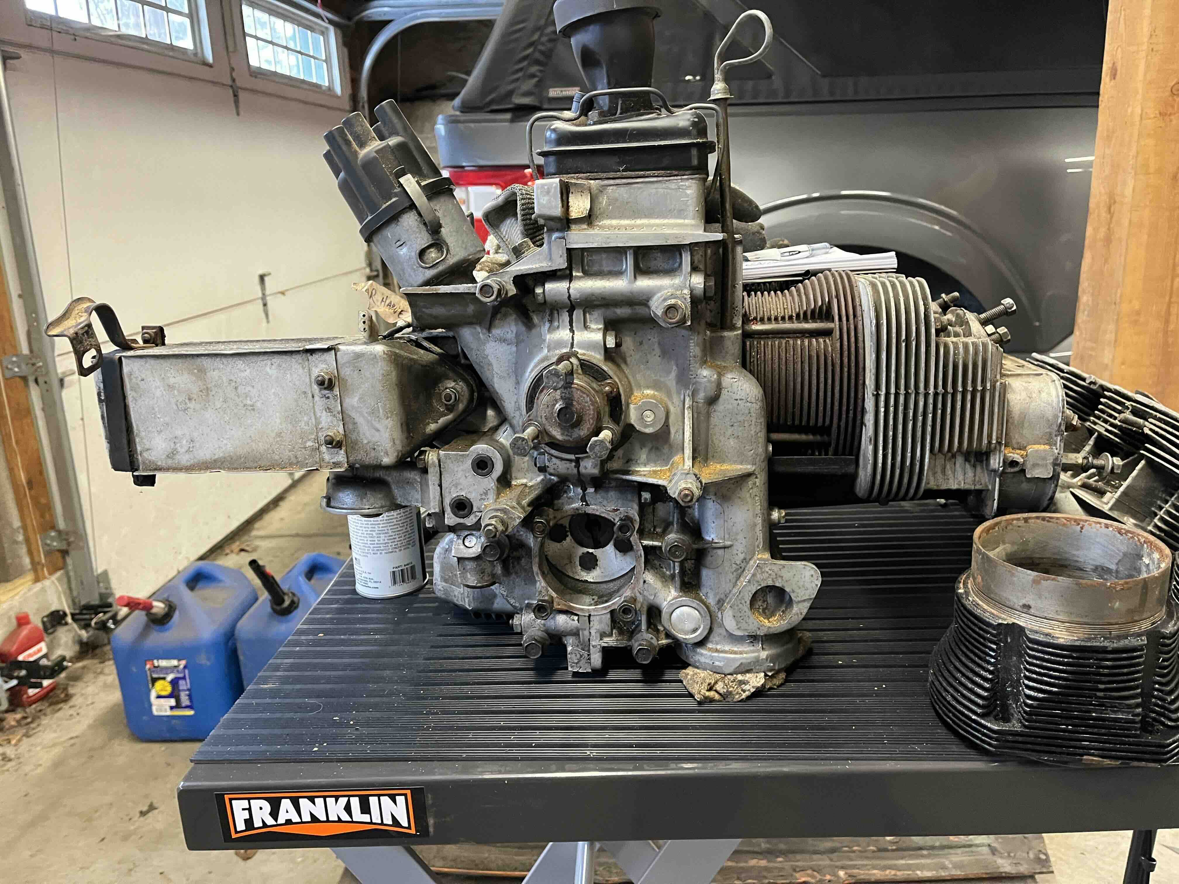

Stroke measured out at 71.76mm which the chatbot tells me makes this a 2.3L displacement engine.

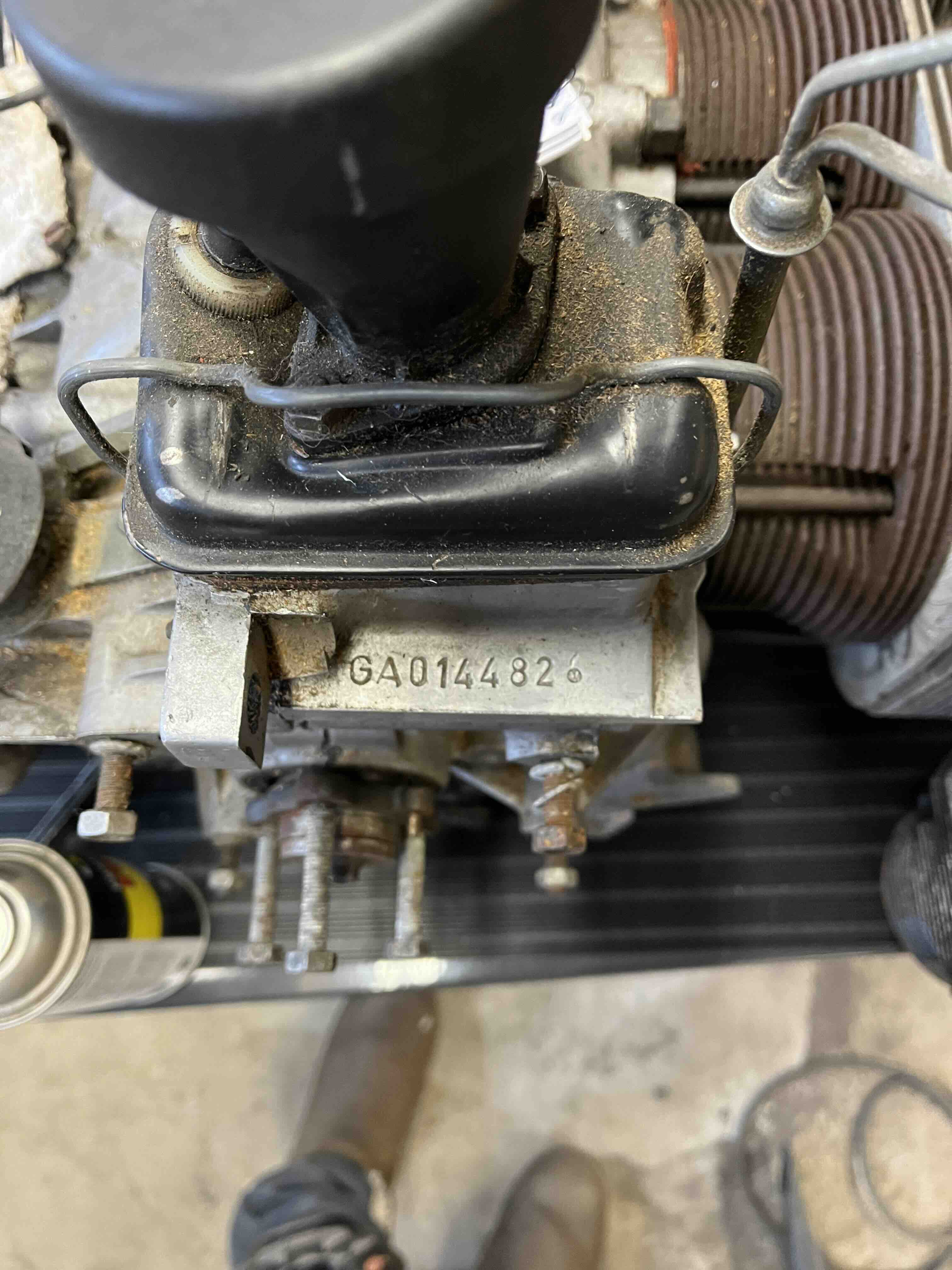

It has a stock clutch and a Bosch 0231178009 dizzy.
At this point my plan is to rely on a local acquaintance who is a retired air cooled engine mechanic to help me assess what would be required to make this a viable engine. Assuming that doesn't involve five digit sums that's probably the route I will go.
