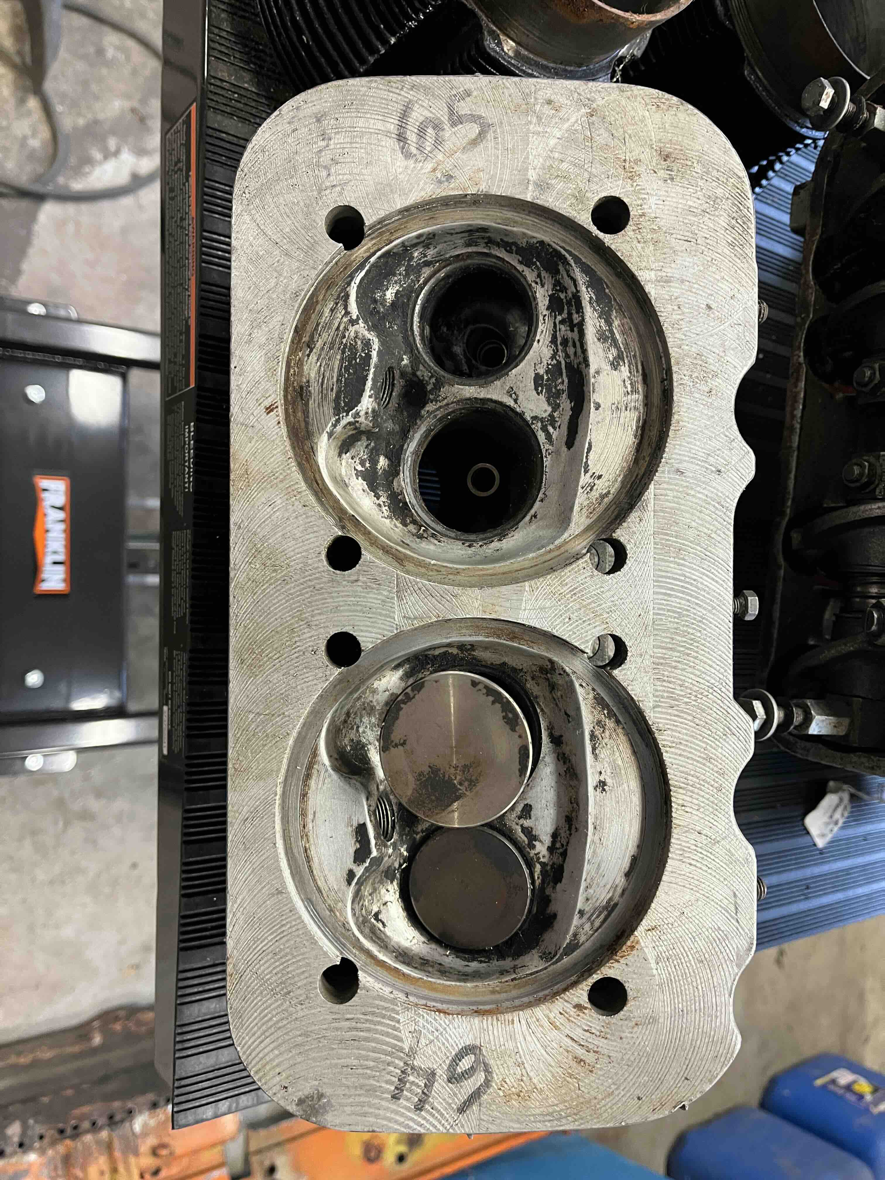

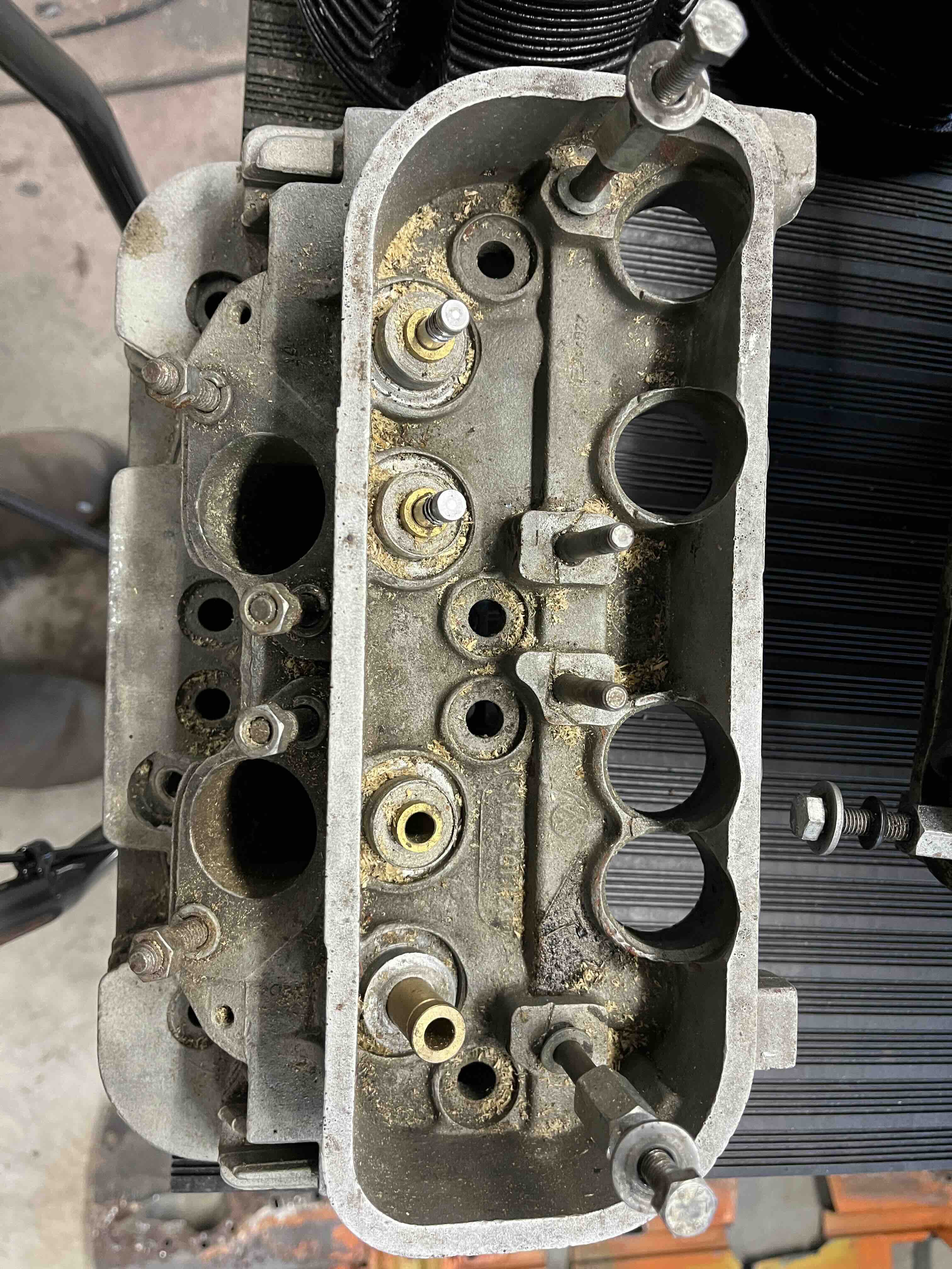

didenpx   Did some more work on evaluating the engine (with ...   Jan 11 2026, 03:46 PM
