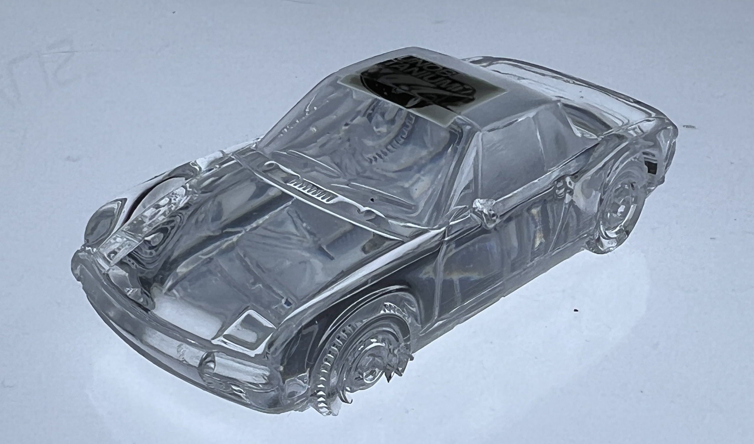

Lots of time to sit by the wood stove and make little resin cars, I added some new additions this year, check out the transporters!
Happy New Year everyone!

Very cool. Are you wood carving these first then make a mold? A vacuum tank or DIY vacuum booth with pump would get rid of those bubbles. (IMG:style_emoticons/default/smile.gif)

I've looked into that, the problem is I gang run about 20 a night, so it would slow production to a crawl if I had to put them in a vacuum chamber, unless you have an idea, I haven't been able to come up with one big enough that's cost effective.
I take the mold's off of die cast cars.

Before I learned about the vacuum booth I used to pour 1/2" of resin and quick hit it with a map gas torch. Just wave it over the surface to heat it a bit and the bubbles come to the top and pop. Your cars are really neat

The bubbles I'm getting are on the surface and only appear after the car has cured, it's frustrating. I finally figured out I was getting the resin too hot, once I got the temps down the bubbles mostly went away.
