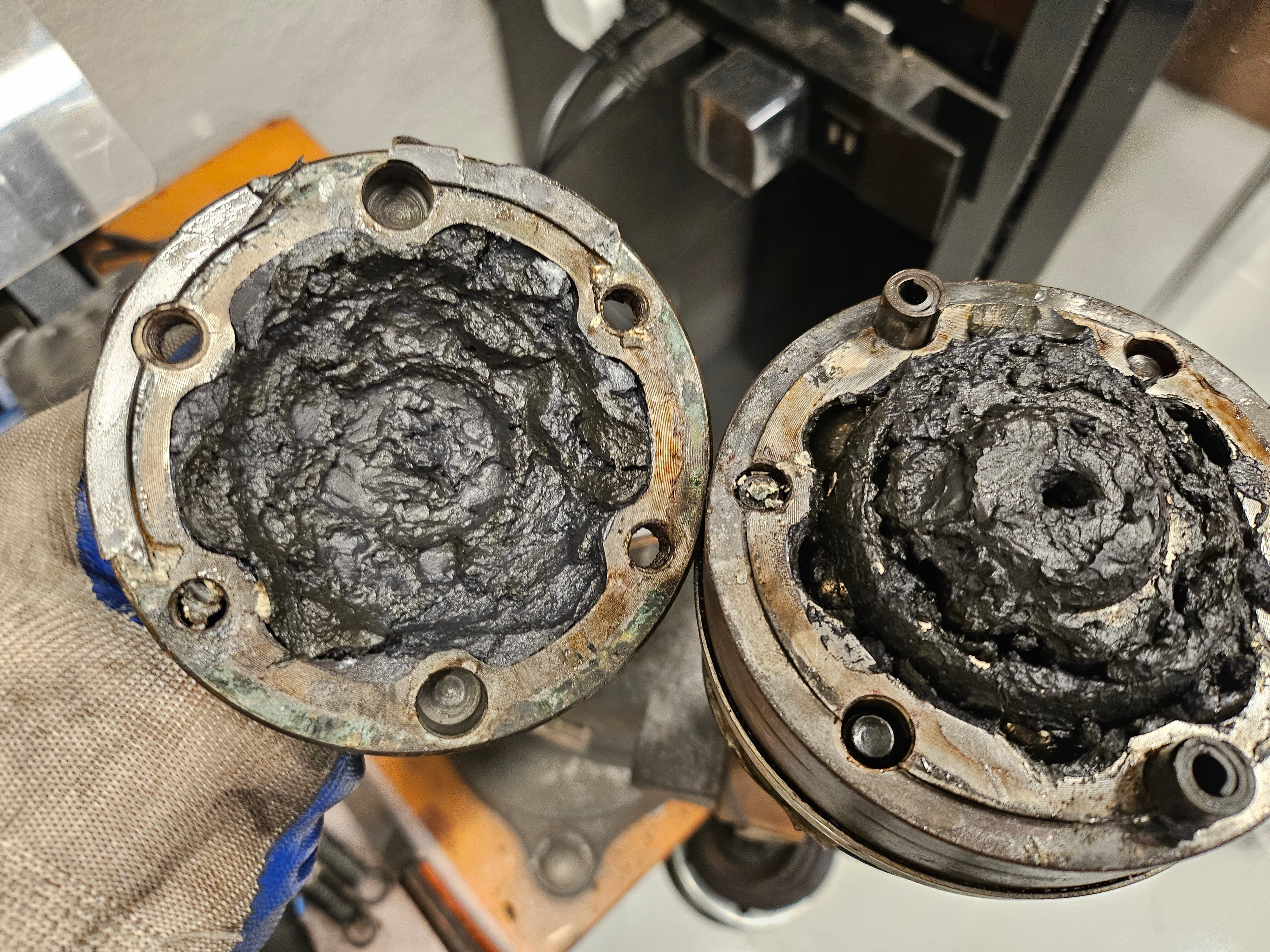

I got some time to pull the left axle shaft tonight, and I was surprised by what I found in the outer CV joint when I removed the stub-axle:
I don't know if you can tell from the photo, but the grease is very dry and thick. So much so that it took some effort to simply pivot the CV joint around the axle, and even more effort to move it in/out axially. And oddly, when I would move the outer race of the CV, there was so much friction that the balls would not roll in the cage, but just slide back and forth.
I suspect that the wear seen on the inner flange is due to the bad grease in the outer CV preventing the axle from floating freely between the inner and outer flanges. Maybe the grease is simply very old, but it doesn't even look like CV joint grease to me. I'm wondering if a PO packed it with something like wheel bearing grease.
I have new axle kits from PMB arriving this week, but out of curiosity I'll clean and inspect the old CV joints this weekend to see how much damage there is.

frank_c   A quick update on this topic. I got some time to ...   Jan 8 2026, 12:32 AM
frank_c   Another update on this topic. I disassembled and c...   Jan 15 2026, 12:33 AM
930cabman   just sayin, I noticed the "grease" in yo...   Jan 15 2026, 05:28 PM
