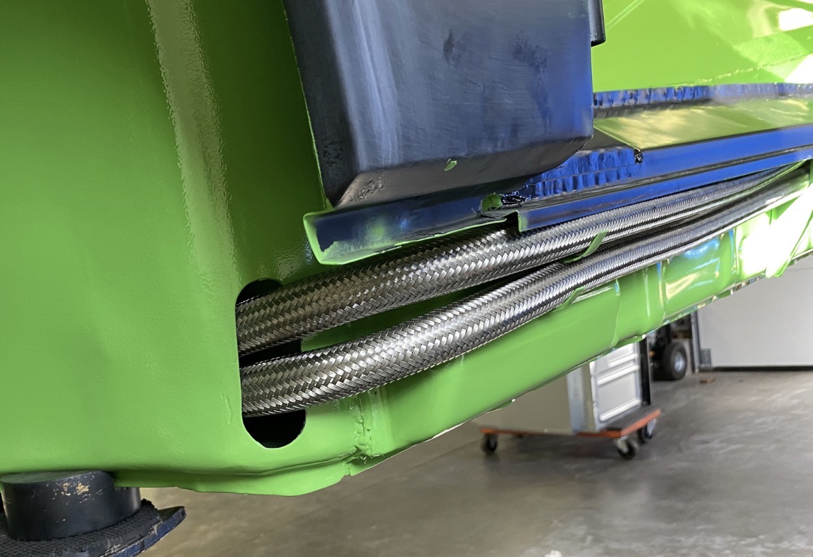

I am building my second 914 and putting a 2.4 six in and building it with hopes of building it out to a hotter 2.5 long stroke next winter... So I am putting in a external cooler up front. I am looking for the best ways to run the lines.. I dont want to run GT hardlines. What did you do?? Pictures welcome!!! (IMG:style_emoticons/default/biggrin.gif)

I’m wondering if anyone has designed a grommet or panel for the opening in order to keep out moisture and critters.

QUOTE(scrz914 @ Jan 9 2026, 01:45 PM) *
possible to drill these openings with a hole saw to get a proper grommet? (IMG:style_emoticons/default/idea.gif)
