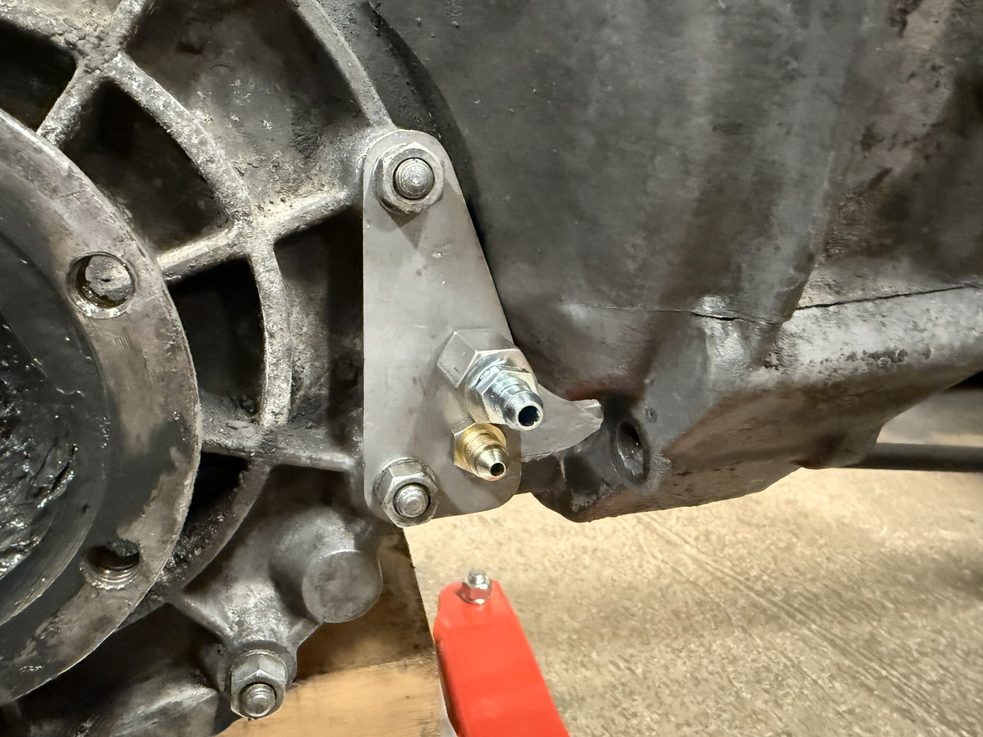

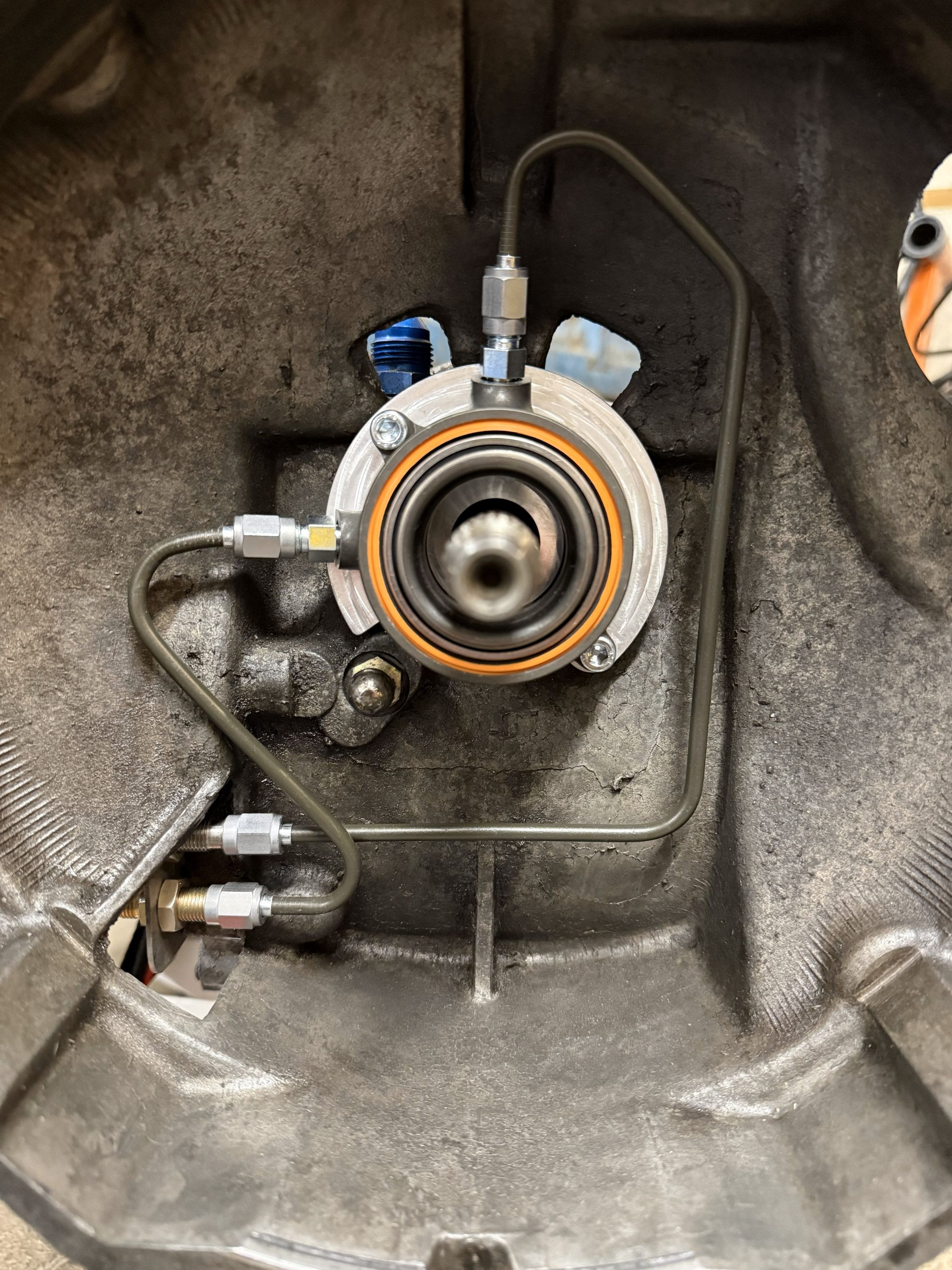

More progress today. The fancy line bracket that I designed didn't quite work out as well as I thought so I went for a simpler approach although millimeters mattered to get the fittings in the right spot.
That makes it easier to access and route the line back to the clutch master cylinder. It also makes for safer routing of the lines inside the bellhousing to the HRB. I know what you're thinking. Yes, the bleed line makes a loop up high that could possibly trap air. Reality is that there would be a loop at the top no matter what. When bleeding, I need to make sure the bleeder bottle is held up high to keep from draining that column of fluid. My other OCD concern is "which fitting connection inside the bellhousing is going to leak?" (IMG:style_emoticons/default/barf.gif) Transmission is back in and everything looks clear inside the bellhousing. I did design a .060" spacer for the engine and transmission which gives the recommended clearance for clutch operation and wear over time. |
