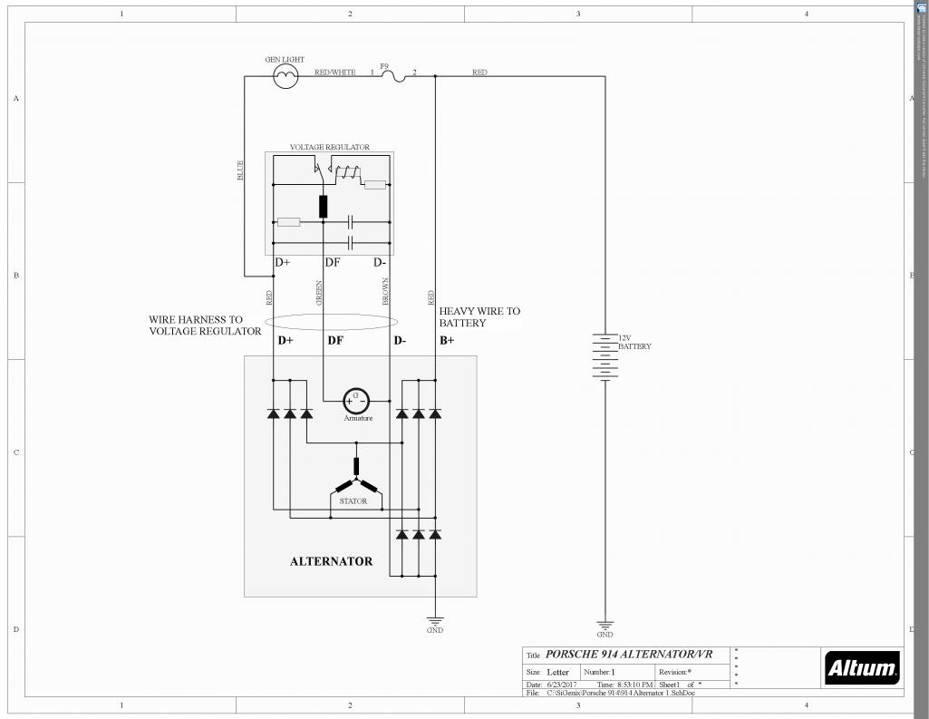

Measured voltage at the battery with a multimeter- had 11.71 just sitting there with the engine off. At idle it still said about 11.7, with the OEM voltmeter reading between 10 and 11. Revving it didn't do much. Turned on the headlights and the OEM meter went down to 10, with the meter at the battery reading about 11.6. Not sure what the h*ll that means but obviously the OEM meter is kind of useless... Any electrical genius tell me what that means? (IMG:style_emoticons/default/smile.gif) @SKL1 As others mentioned, it seems your alternator/VR is not functioning. A couple of tests: 1) Is the GEN light on before cranking the engine? If the GEN light is not on then either the GEN light is burned out, or fuse blown, or an issue with the VR or alternator. 2) Once running, at the alternator connector on the relay board, measure (Don't disconnect anything): - D+ to chassis; should be 14V - DF to chassis; should be 5-9V - D- to chassis; should be 0.0V |
