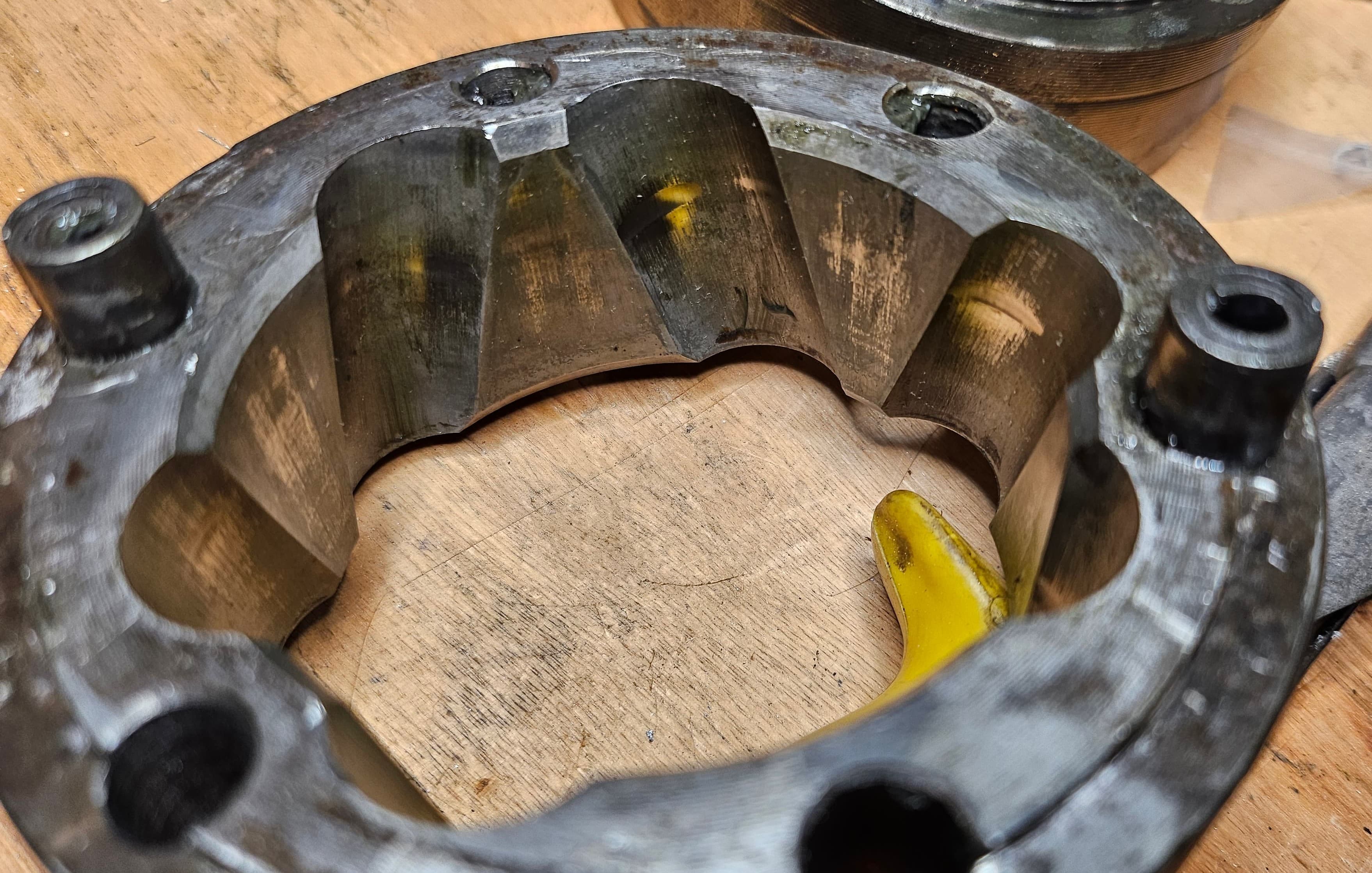

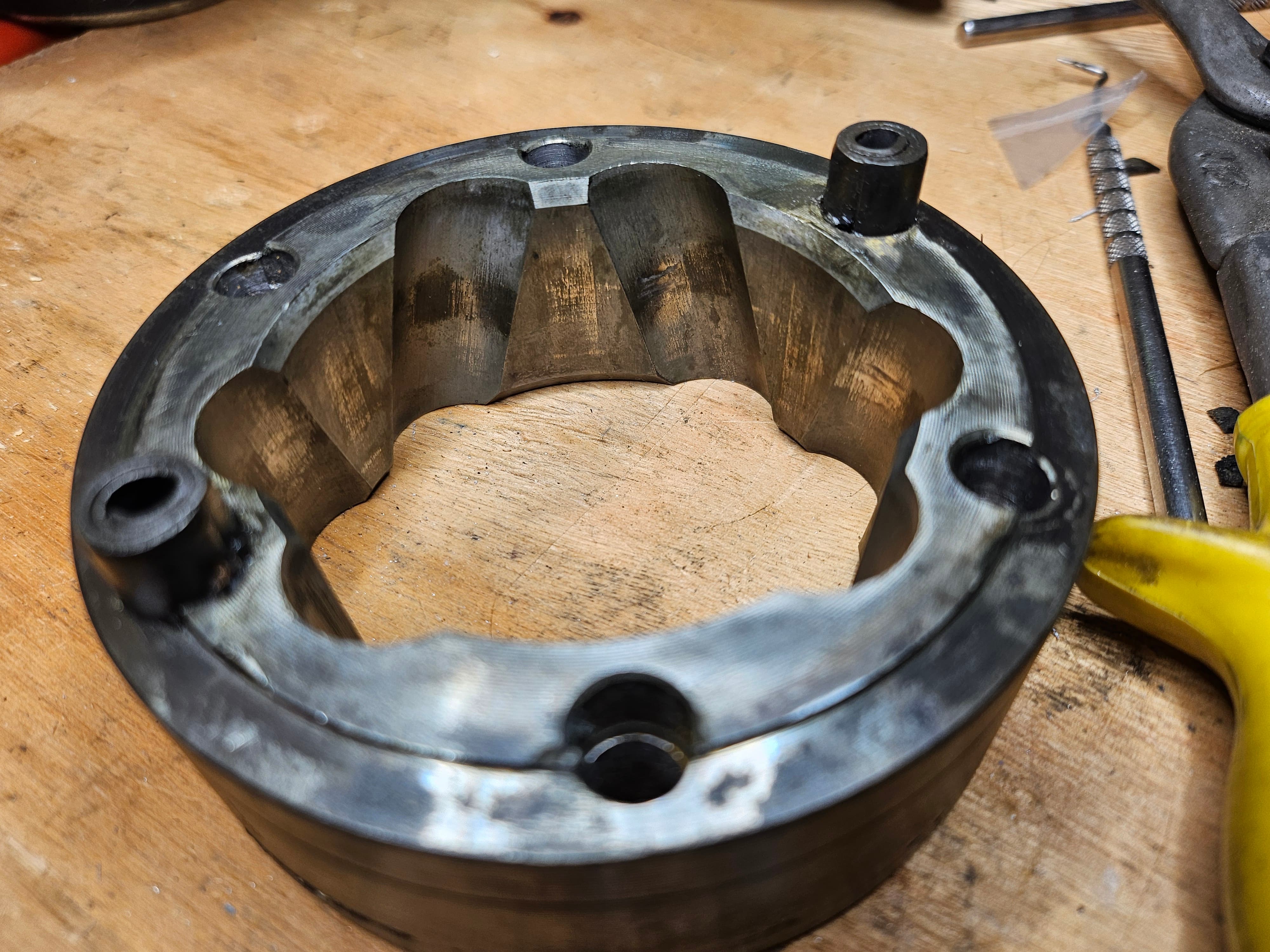

Another update on this topic. I disassembled and cleaned the outer and inner CV joints from the left axle. The grease in the outer CV was like thick peanut butter. As you can see below, both joints are badly worn and will be replaced. I suspect I will find the same with the right axle.
Outer CV Joint:
Inner CV Joint:

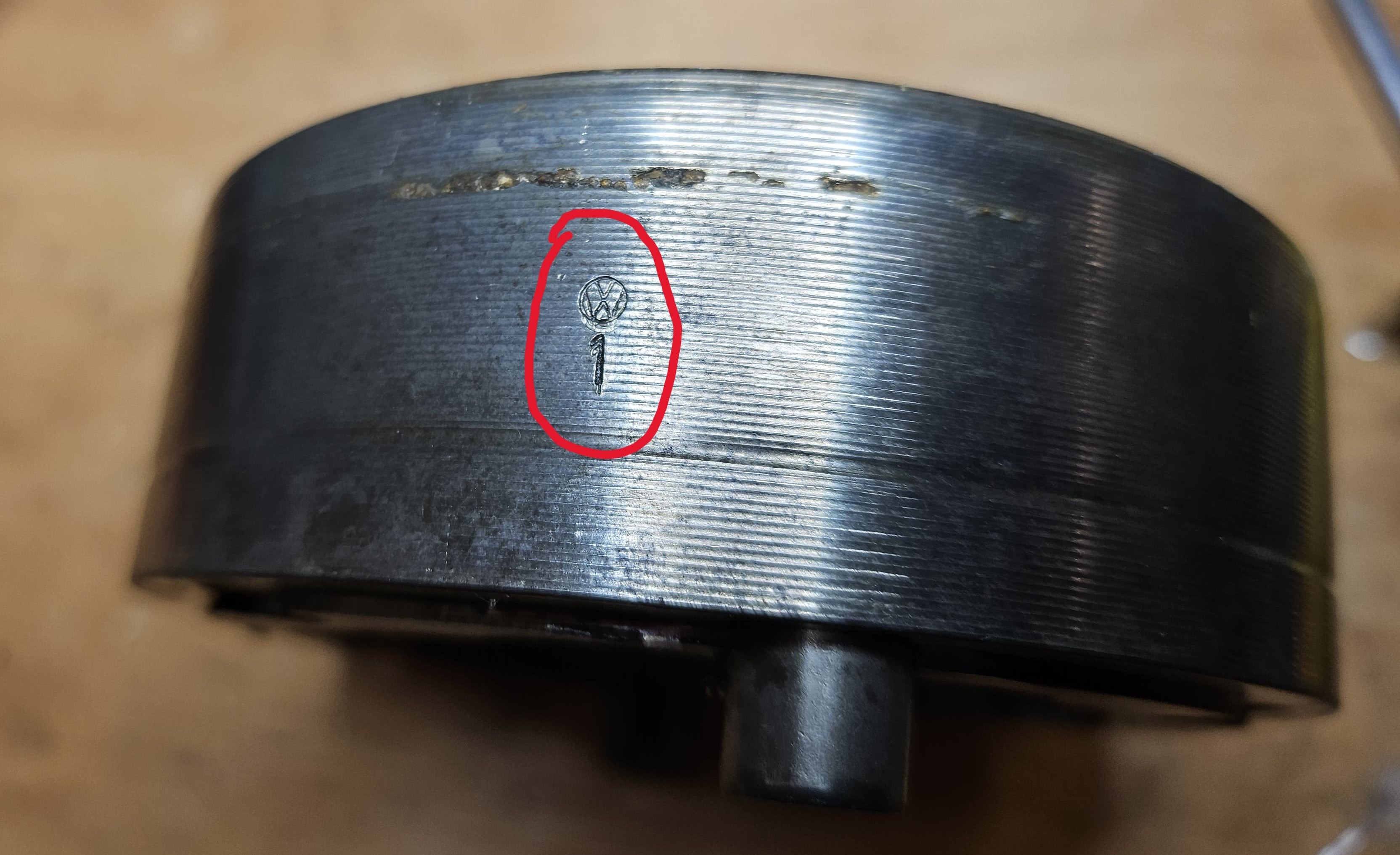

1. Both CVs are stamped with VW logo (see photo). Probably original.

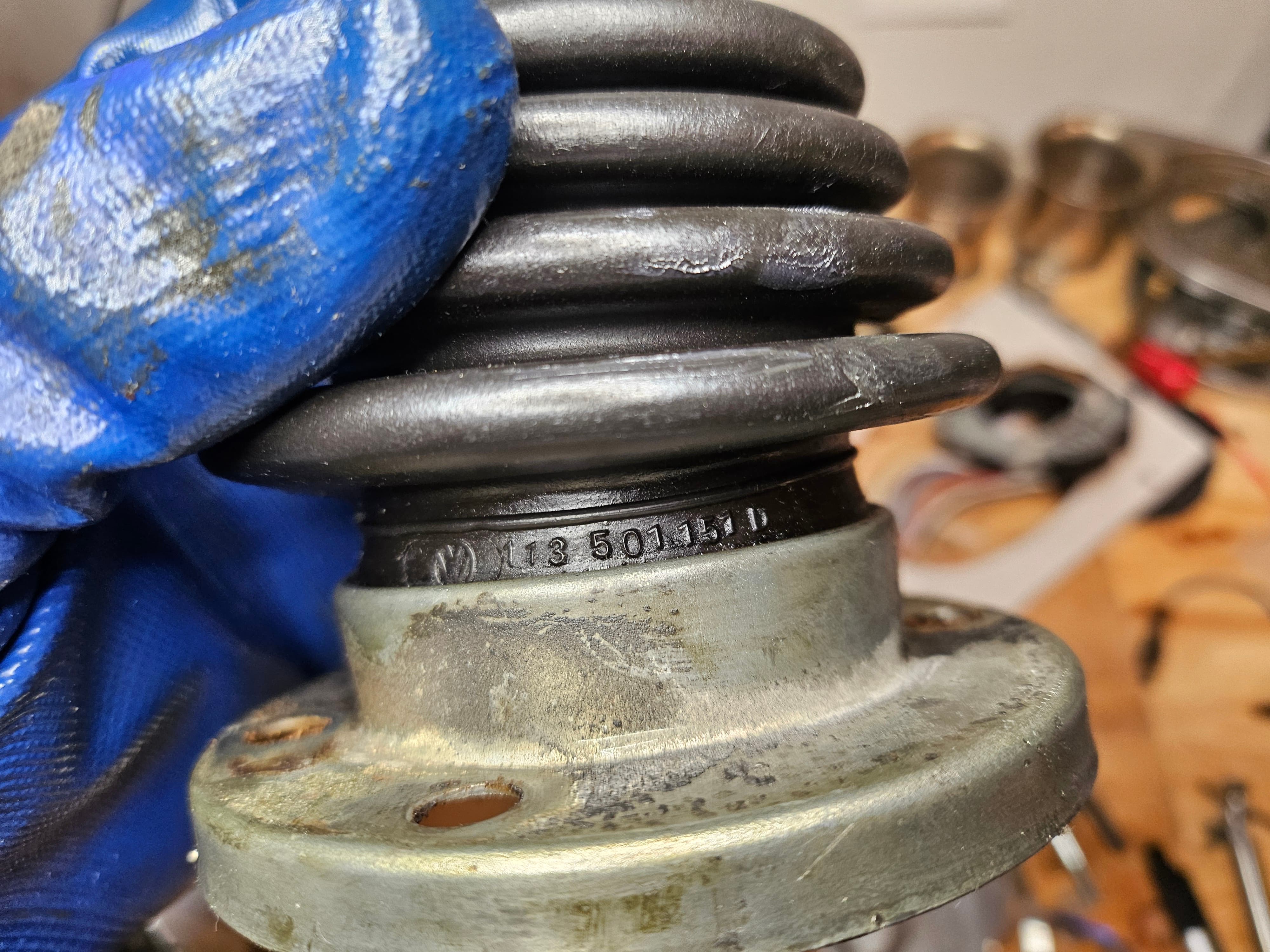

2. The boot on the outer CV is VW part 113501151D with only 4 bolt holes (see photo). This is from the CV with peanut butter viscosity grease. Perhaps the original boot?
3. The boot on the inner CV was a typical aftermarket part (6 holes) - so it was replaced at some point and packed with new grease, just not very much of it.
Given the above, I'm wondering if the outer joint grease has never been changed, leading to the issues I was seeing.
