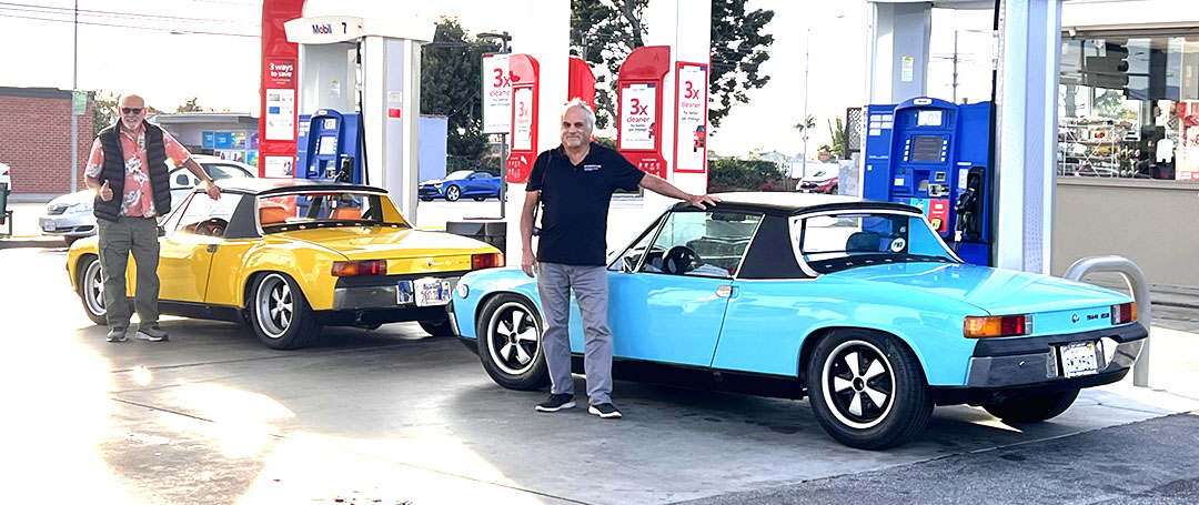

@ Aayala
Shown is my 1970 factory 6 with 7x 16In and 8x16in factory Fuchs (Cannery yellow car)
And Mark Sonners 1974 hot 2.3 BlueBoy with 15in high quality deep 6s and High quality 15” x 7R 15x7 with a deep 7 look with the extra inch going to the inside. If you want to keep the stock body, I think that this is the way to go. And a no on 15x8 on a stock no faired body
Best Bob B

Those are some two good looking cars!! Man I just love the look of those wheels. That might just be my answer! Thank you!
