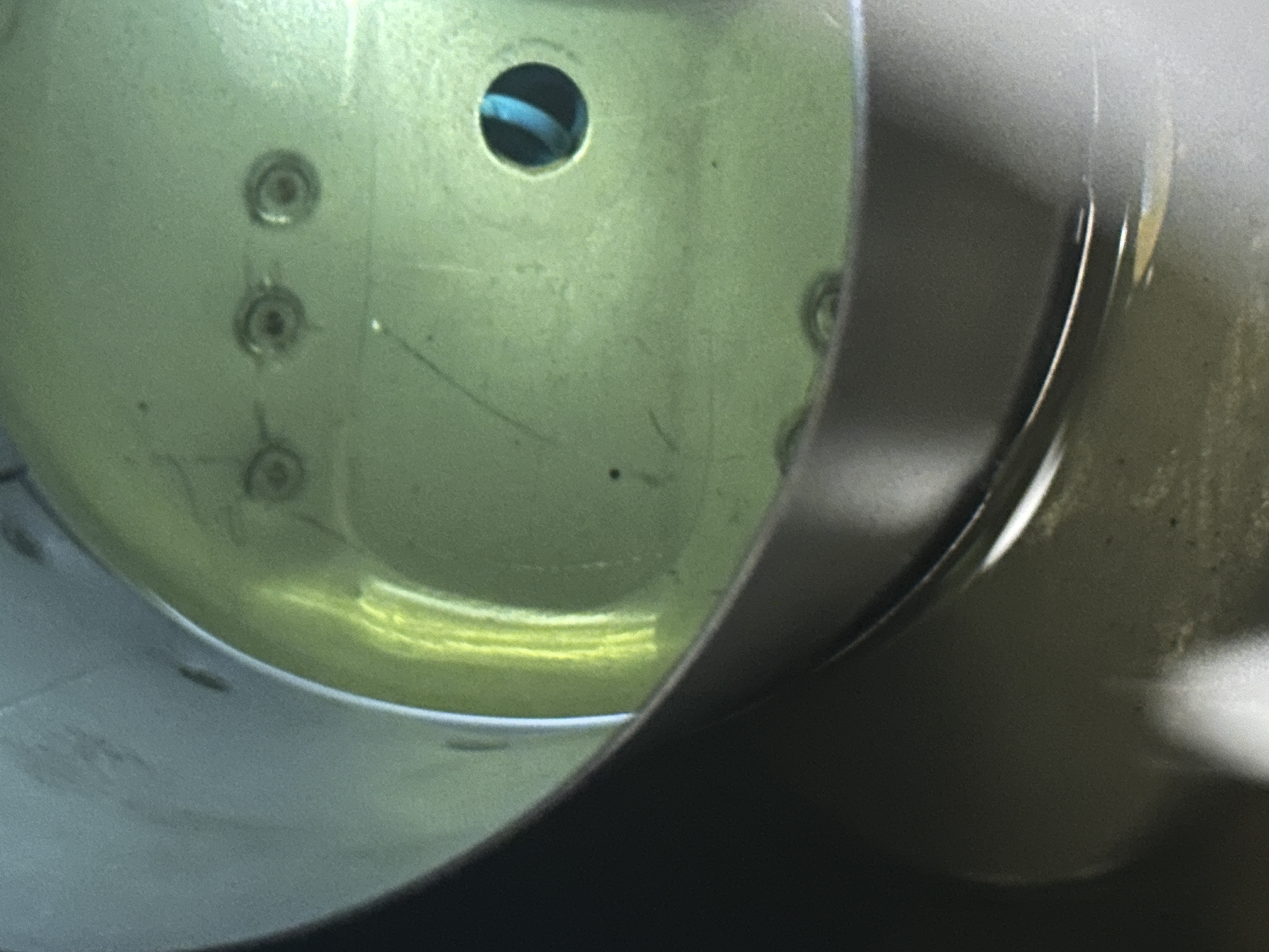

rfinegan   Wrapping up the new fuel tank and AN lines today. ...   Jan 11 2026, 08:26 AM
rfinegan   WOW, I was thinking I was done. Now I see the J b...   Jan 18 2026, 10:26 AM
