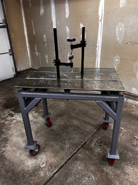

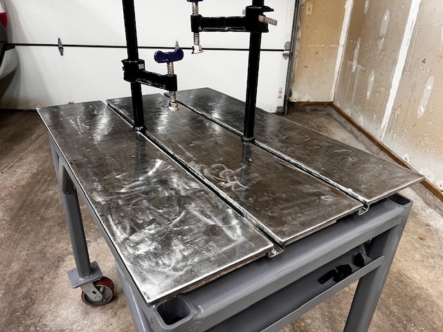

Built a “proper” welding table that I absolutely love!

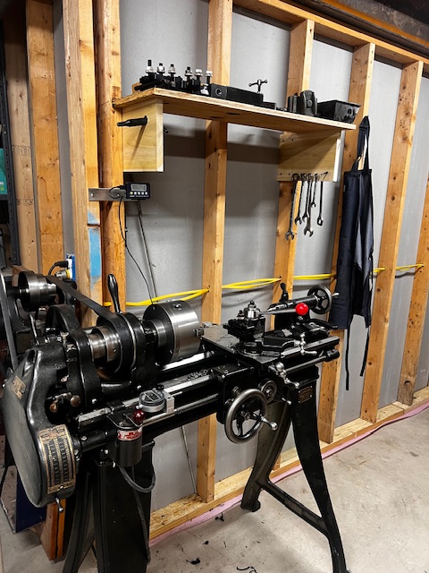

Restored an OLD South Bend lathe.
