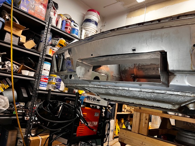

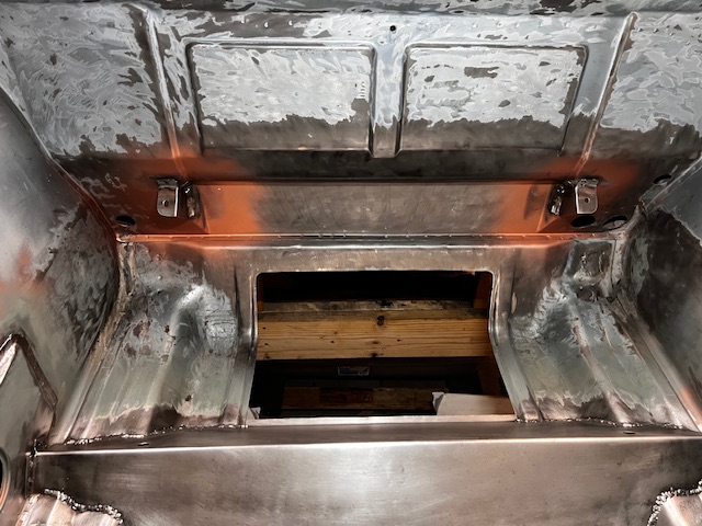

My focus has still been on the cooling system. Specifically, the radiator mounting and shroud. So, I cut a hole in the bumper and built a “tunnel” through the bumper and the frunk front panel. Right now the tunnel is just tack-welded in case I find a reason to alter it later. Eventually it will get trimmed so that it is flush-ish with the bumper and front spoiler. I’m designing a custom plastic grille that will attach to the tunnel at the bumper/spoiler opening.

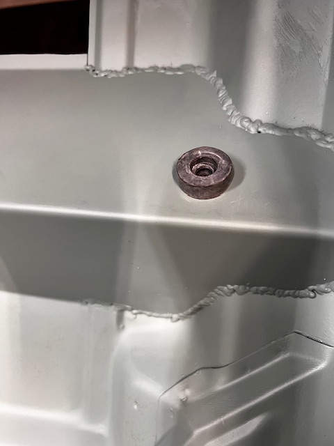

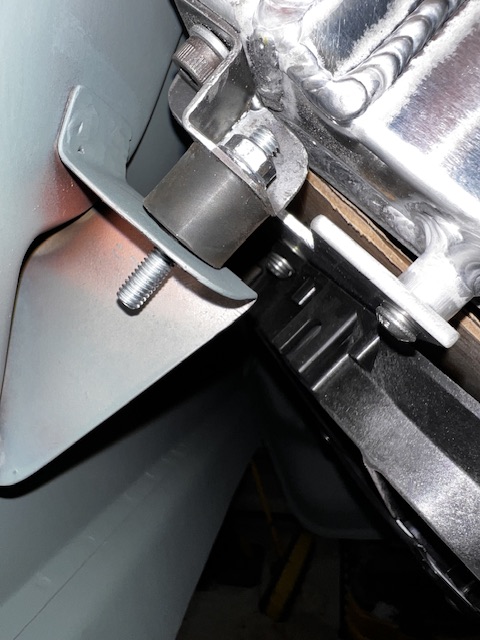

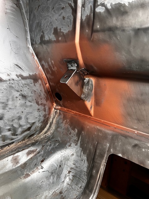

Then, I needed to finalize the radiator mounting so that I could fabricate the shroud. I made some brackets that I welded to the gas tank wall (or whatever you call that part). I’m using rubber bushings/mounts at all radiator mounts to reduce stress.

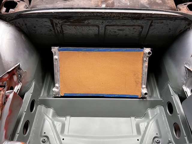

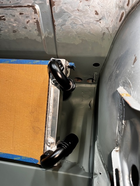

Lilchopshop   Next up, I thought I’d start figuring out radiat...   Mar 13 2025, 05:40 PM
