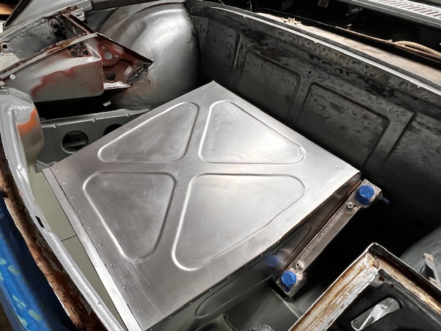

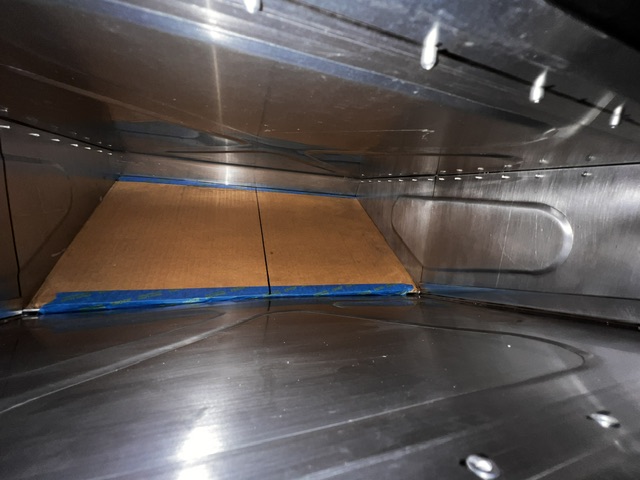

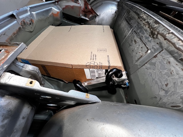

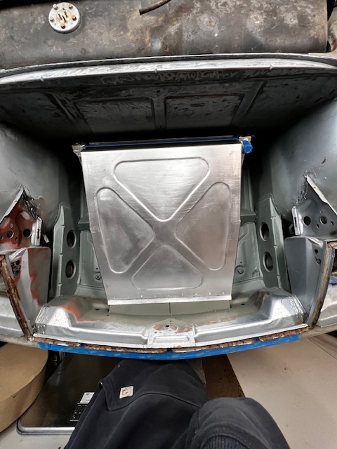

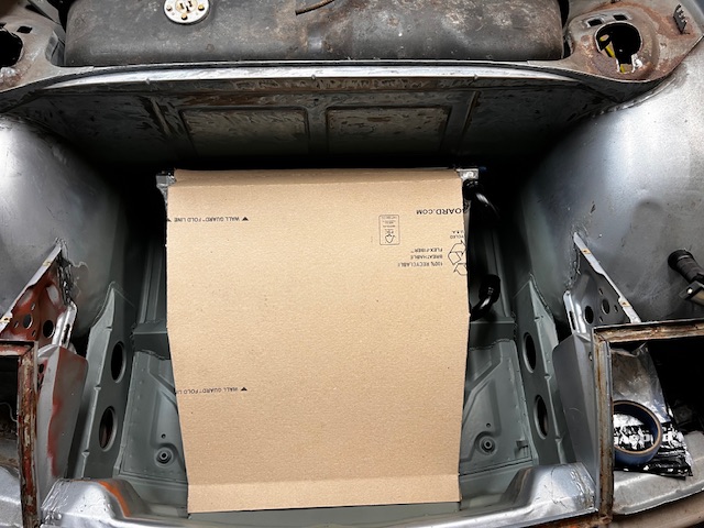

With the radiator and tunnel in place, I mocked up a cardboard shroud and tested it with my cardboard spare tire.

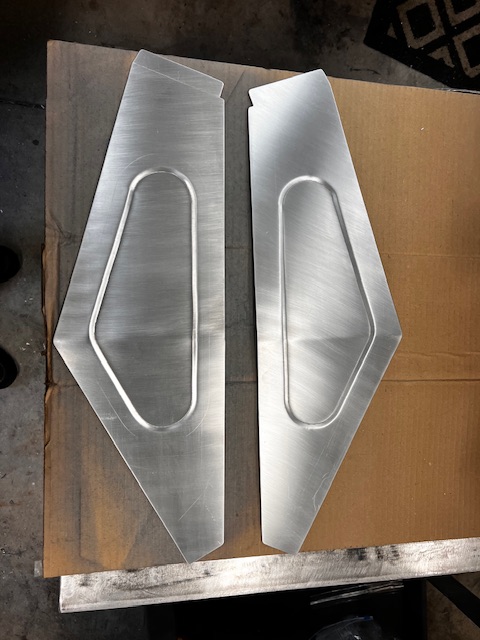

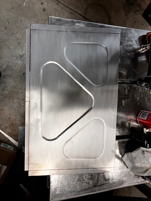

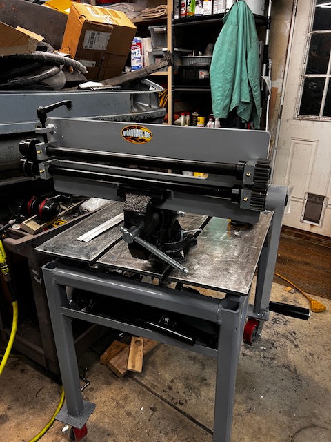

Then, I decided it was time to test out the new bead roller that I bought over a year ago just for this part of the project. It’s pretty easy to use, but man I wish it had a motor and a foot pedal!

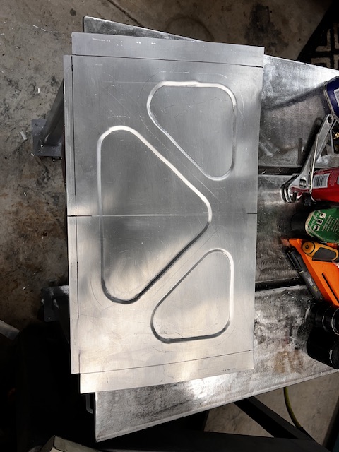

It only took me a few hours to get comfortable with the bead roller and then I started making the parts for the shroud. I’m using .040” 5052 Aluminum. It bends well, but it’s hard to get crisp bends. I decided to use rivets to join the pieces together. I kinda like the look of rivets in aluminum, so this is how I joined the pieces of the shroud.
Next up, I’m making the parts that will attach the shroud to the radiator. Thanks for looking!
