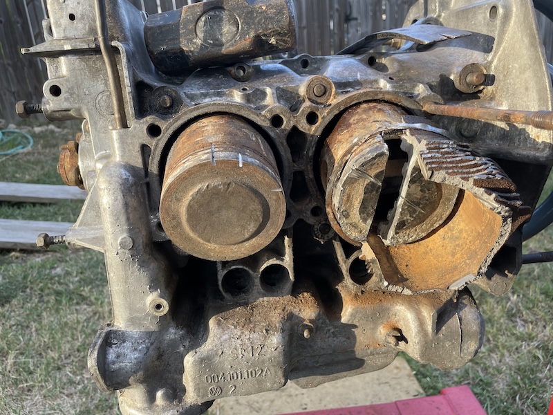

friethmiller
post Jan 22 2026, 09:26 AM
Posts: 1,592
Joined: 10-February 19
From: Austin, TX
Member No.: 22,863
QUOTE(rgalla9146 @ Jan 22 2026, 08:33 AM) *
I agree.
But keep in mind that you can damage the barrel spigots on the case if you get
too rough with this method.
Fasten the barrels tight to the case during the cutting.
A sawsall is another good cutter.
Brutal stuff.
I've done this before on an old 1.7 engine that was completely locked up. Included a pic. Keep in mind that once the cylinders are off you still need to remove the pistons to split the case. If I remember correctly, it was easier on the case to cut the pistons clear at the wrist pins.
This looks horrible, I know, but I was able to save this "W" block and get it reconditioned for a rebuild. (IMG:style_emoticons/default/biggrin.gif)
