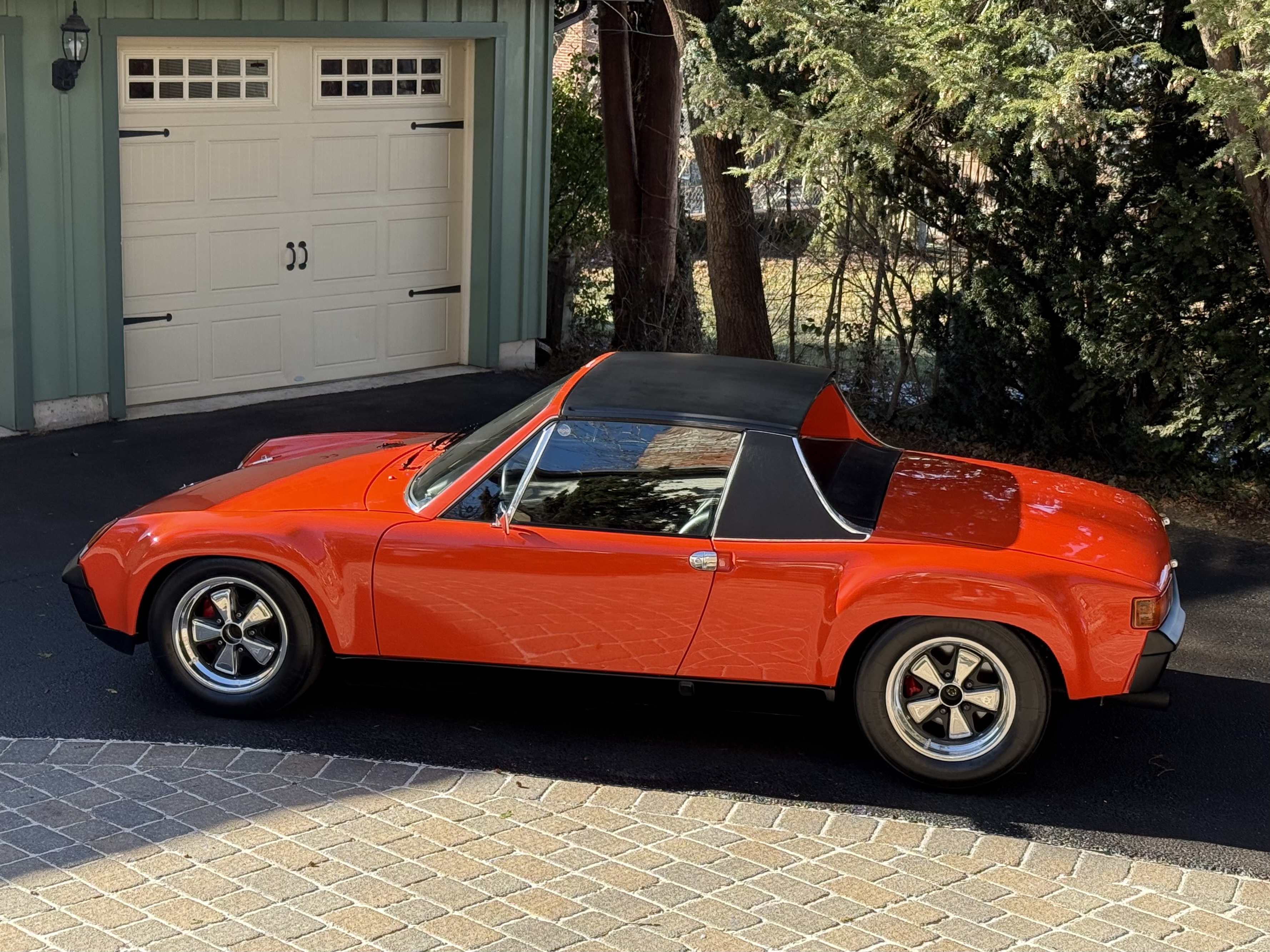

Some kind of crossover between high beams and turn signals. First, everything works… except the indicators. Here’s what happens… use the left turn signal and the left side green arrow on the dash flashes as it should. Use the right side turn signal and the LEFT side green arrow flashes for that one too. Turning on the high beams makes the right side green arrow light up. Seems pretty telling but I’m lost when it comes to electrics. Simply a plug and play issue? Wires simply hooked up to the wrong bulbs?
