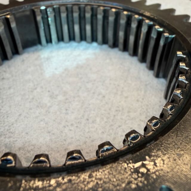

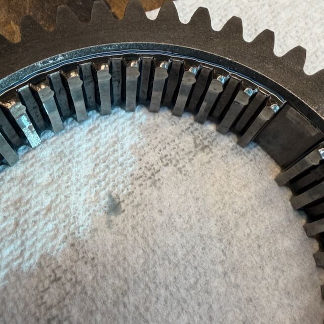

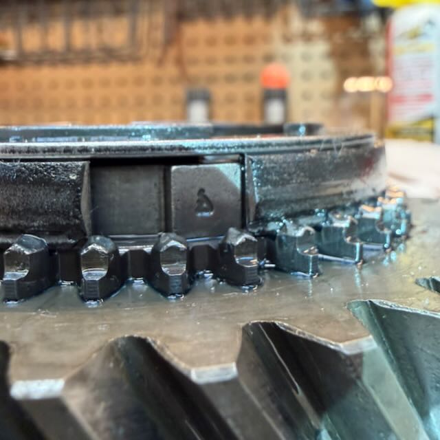

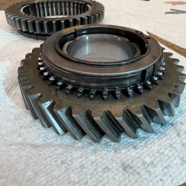

I finally found some time to tear into the transmission. The disassembly was pretty easy.
Dr. Evil's videos were worth every penny, even though I am not doing a full rebuild. It really helped me understand what goes on in that box when I shift gears and was a confidence booster for taking it apart.
There was not much metal on the plug magnets. Some, but I was expecting a golfball of metal fuzz. It was tricky to not have the middle section of the transmission come off with the end. That took some careful tapping.
The diagnosis and fix are clear - That dog don't bite, that's for sure (see pix). The slider teeth look like they have been smeared around. I'm certain I need new dog teeth, slider and synchro.
Now to get parts ...
