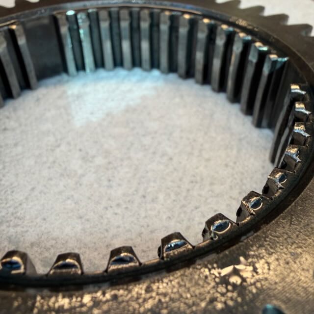

Chaznaster   I finally found some time to tear into the transmi...   Feb 15 2026, 02:43 PM
mepstein   If first gear is gone, second is usually close beh...   Feb 15 2026, 03:09 PM

mlindner   I do have the tools needed for a small rental fee....   Feb 15 2026, 03:43 PM
jim_hoyland   :) Nice pics, thanks for posting   Feb 15 2026, 04:03 PM
914werke   Sucker is toast   Feb 16 2026, 12:25 PM
rudedude   If you haven't spend some time on the bird sit...   Feb 16 2026, 02:40 PM
Chaznaster   Thanks to all for the confirmation and advice. I ...   Feb 16 2026, 05:40 PM
