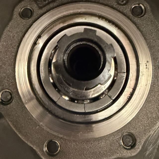

Today I separated the dog teeth and pressed in the new ones. It went really well.
Then I put some bright lights on the transmission to get the old gasket scraped off and saw something I wish I could unsee. The race of the bearing that sits under 1st gear is cracked in four places.
Maybe a full rebuild is going to happen sooner than I had hoped. Like maybe now.
Ugh ...
