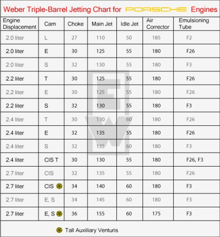

I am down to the last thing for this engine re-fresh: CARBS
They seem to be in very good condition and since they are missing the Porsche factory mark I am guessing that they were 'cored' on a rebuild sometime prior to my ownership
OR
Are 914-6 carbs NOT market like 911 carbs are???????
Anyway, I have not gone too deep since they are in great shape - the gaskets seem good, the floats are the brass kind but in perfect shape, the bowls are very clean,,,,,,
Can I get some direction on:
1. what to look for in a recently rebuilt carb
2. where is a good reference for setup prior to installation
Any other opinions would be well received,
Thank you Teeners

euro911   See if you can find a copy of this factory Weber T...   May 30 2025, 09:28 PM

ctc911ctc   ****UPDATE**** Sooooo.......it would seem that on...   Jun 5 2025, 10:10 AM
rgalla9146   Those are replacement newer production carbs. ...   Jun 5 2025, 11:34 AM
