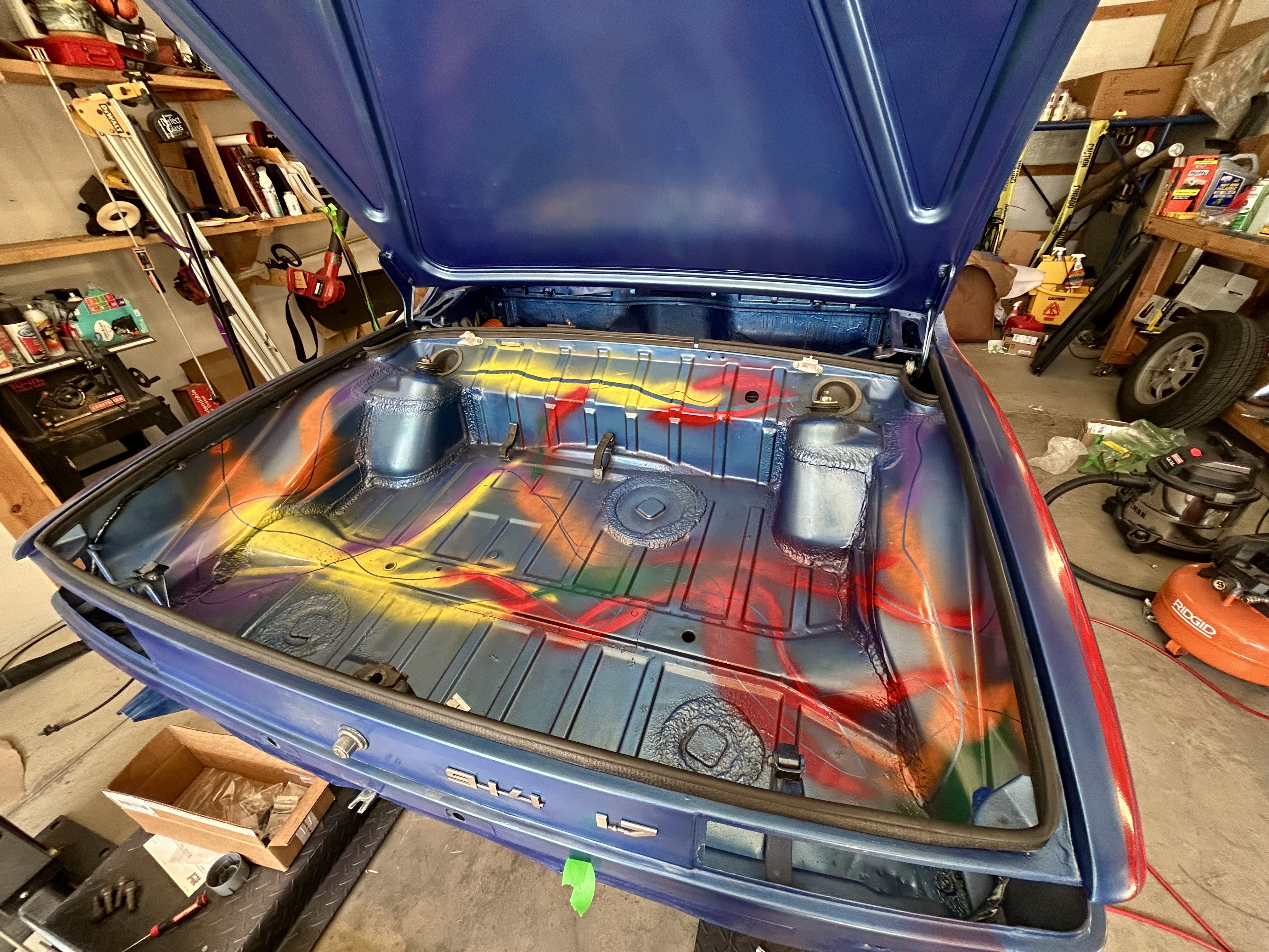

HFC3   Complete blasphemy.   Mar 19 2026, 12:32 PM

HFC3   I was asked why the paint? If you inspect the p...   Mar 24 2026, 07:20 AM
