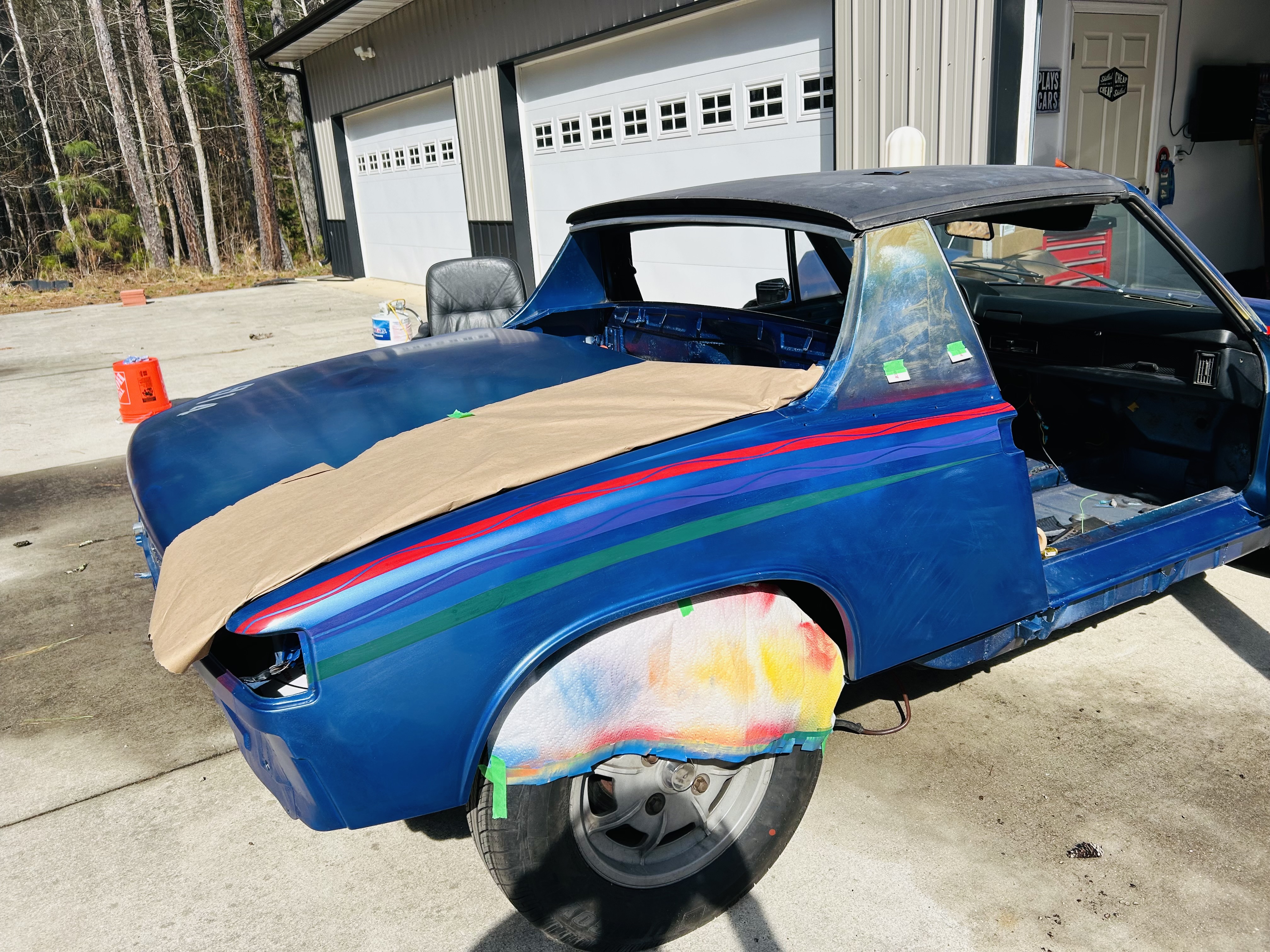

HFC3   Clear coat on sides.   Mar 21 2026, 06:36 PM
