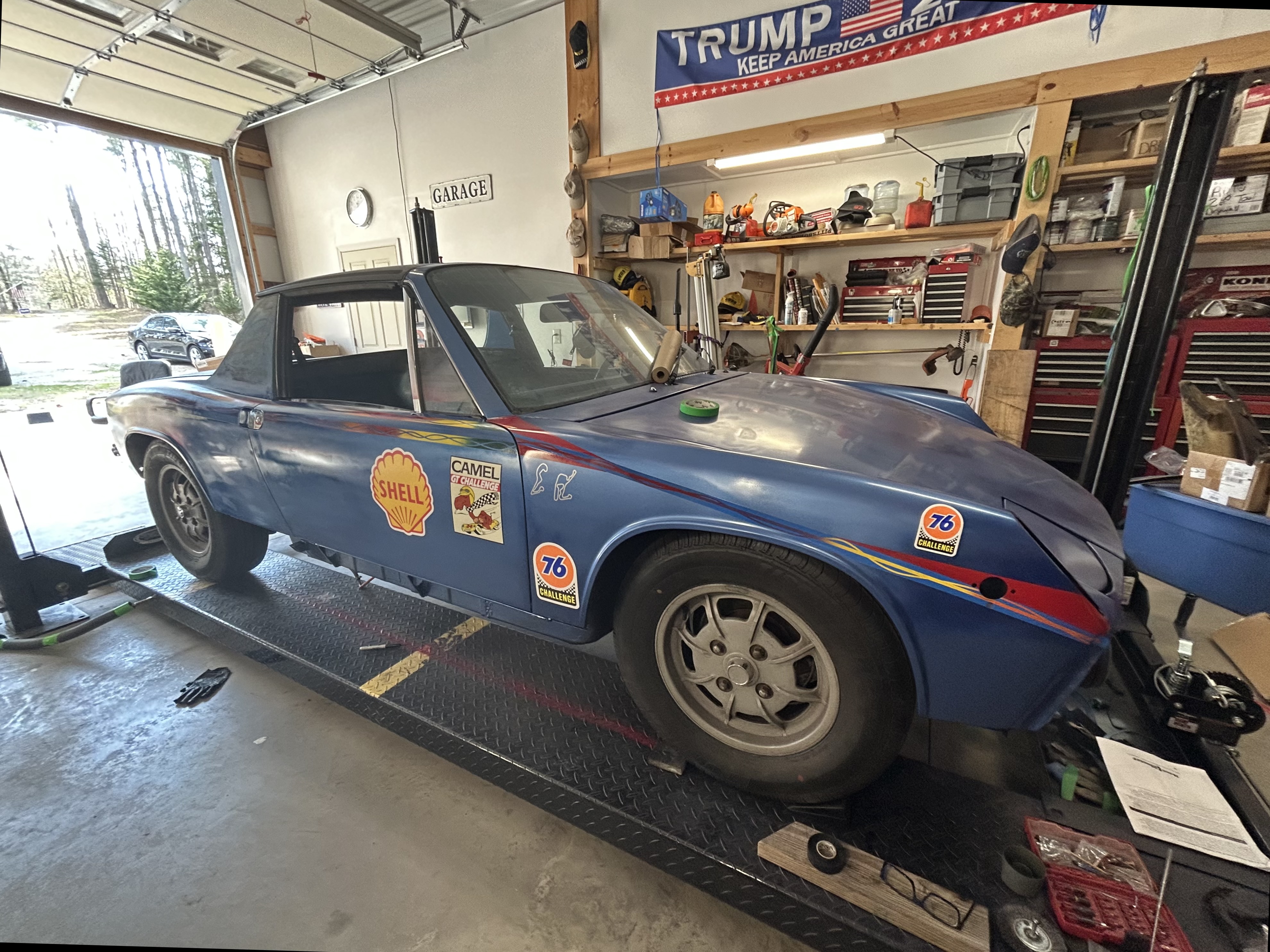

I had trouble starting my restoration of a 73 914 on 914 World so I placed it on TheSamba.
I will add some background and progress as I move along.

HFC3   This 914 sat in the ownership of two gentlemen in ...   Feb 12 2026, 08:48 PM

HFC3   I first repaired both Jack points.   Feb 13 2026, 07:46 AM
HFC3   More detailed pictures on the link in my first pos...   Feb 13 2026, 07:57 AM
HFC3   The engine and transmission are ready to fall out...   Feb 15 2026, 01:05 PM
HFC3   Pulled the motor.   Feb 17 2026, 06:32 PM
HFC3   I mean, I literally pulled the motor.   Feb 17 2026, 06:34 PM

HFC3   I think I am very close to being done with Welding...   Feb 22 2026, 07:15 PM

HFC3   I think I am very close to being done with Weldi...   Mar 24 2026, 04:12 AM
HFC3   This is the only panel I didn’t weld. I figure...   Mar 24 2026, 04:17 AM
HFC3   I was asked why the paint? If you inspect the p...   Mar 24 2026, 07:20 AM
