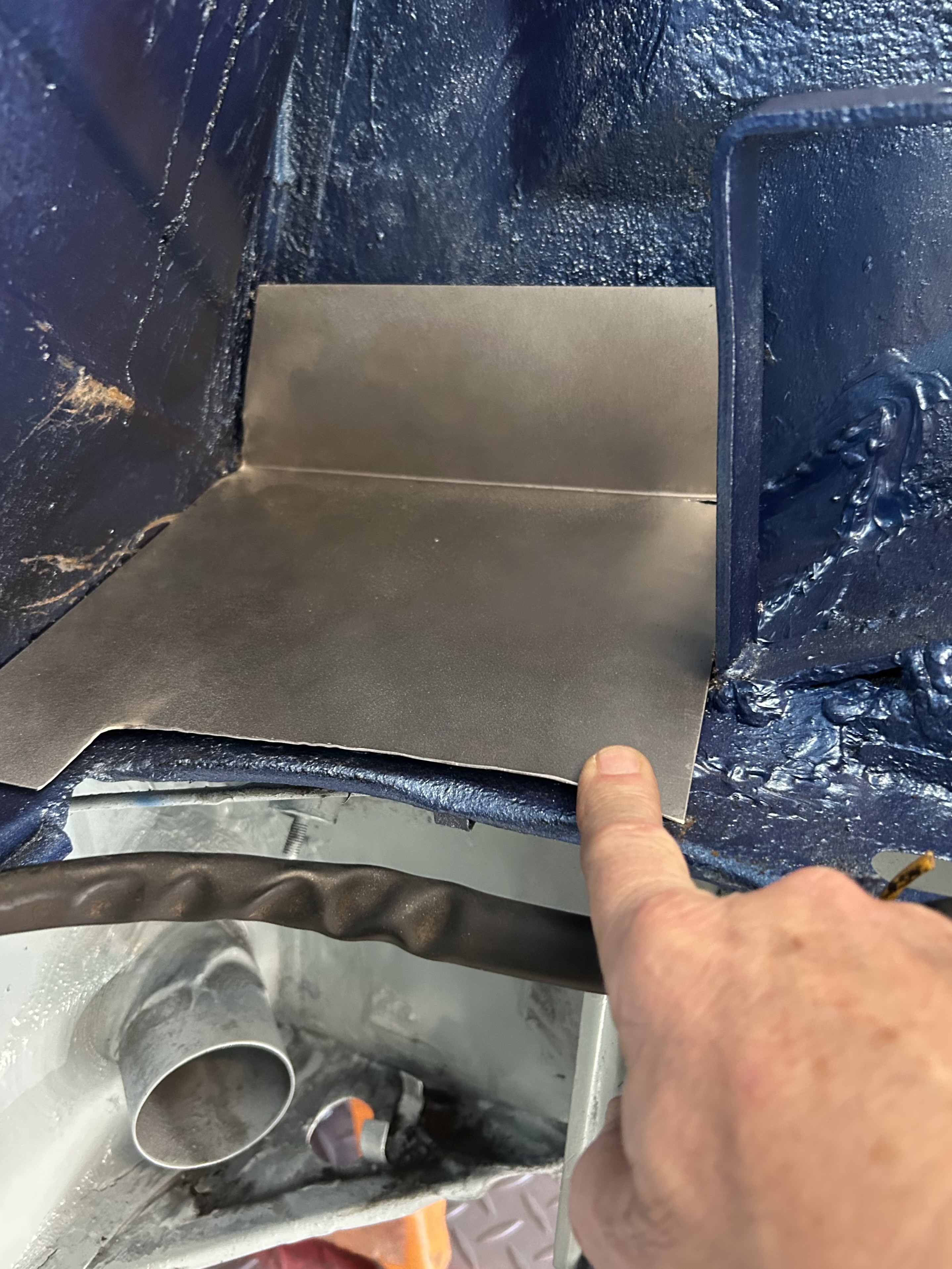

QUOTE(DRPHIL914 @ Mar 23 2026, 06:33 PM) *
QUOTE(HFC3 @ Feb 22 2026, 09:15 PM) *
I think I am very close to being done with Welding other than one more AC line hose in the passenger wheel well.
hey good work fast work , wow, but i have a question and concern,
you said the hell hole here is good, you have applied a lot of new seam sealer , what i cant see is if the stock drain hole is still there ? maybe its just the angle of the picture but i hope its not been closed off or eliminated it does serve a purpose to let water that getsinto the engine compartment a place to drain out.
Just wondering...... keep up the great work,
- ps the girlfriend story is crazy!! poor car took the brunt of the punishment!!
Good eye. I did eliminate the drain hole on that side. I was looking for a rubber drain similar to the one used in the frunk. In the end I fabricated a piece to cover the entire area with a slope to drain. Obviously not original but you really cannot see it from above.
