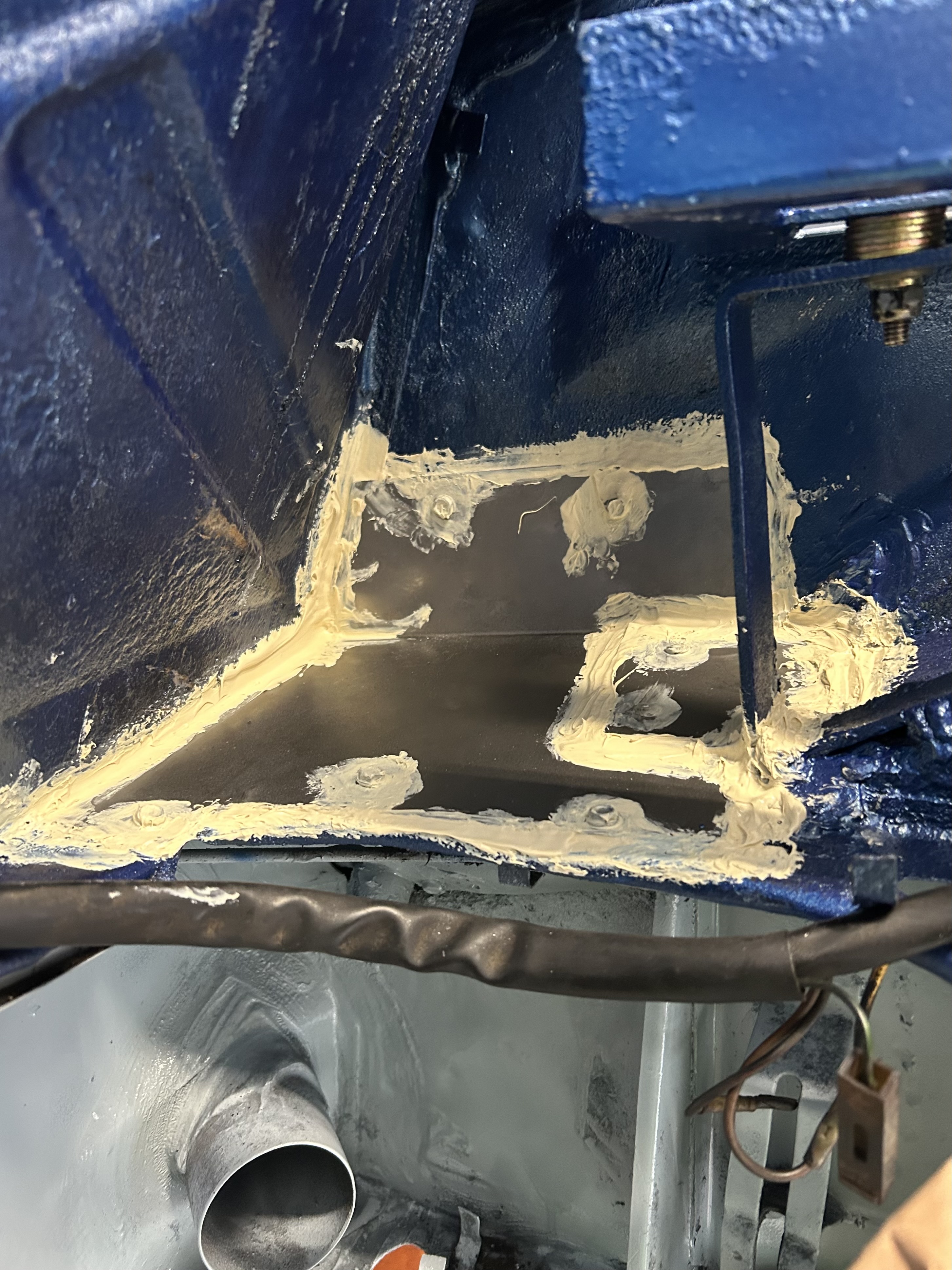

This is the only panel I didn’t weld. I figured it was not structural and if needed I can easily access it. The link at the bottom is a more detailed account of this build.
