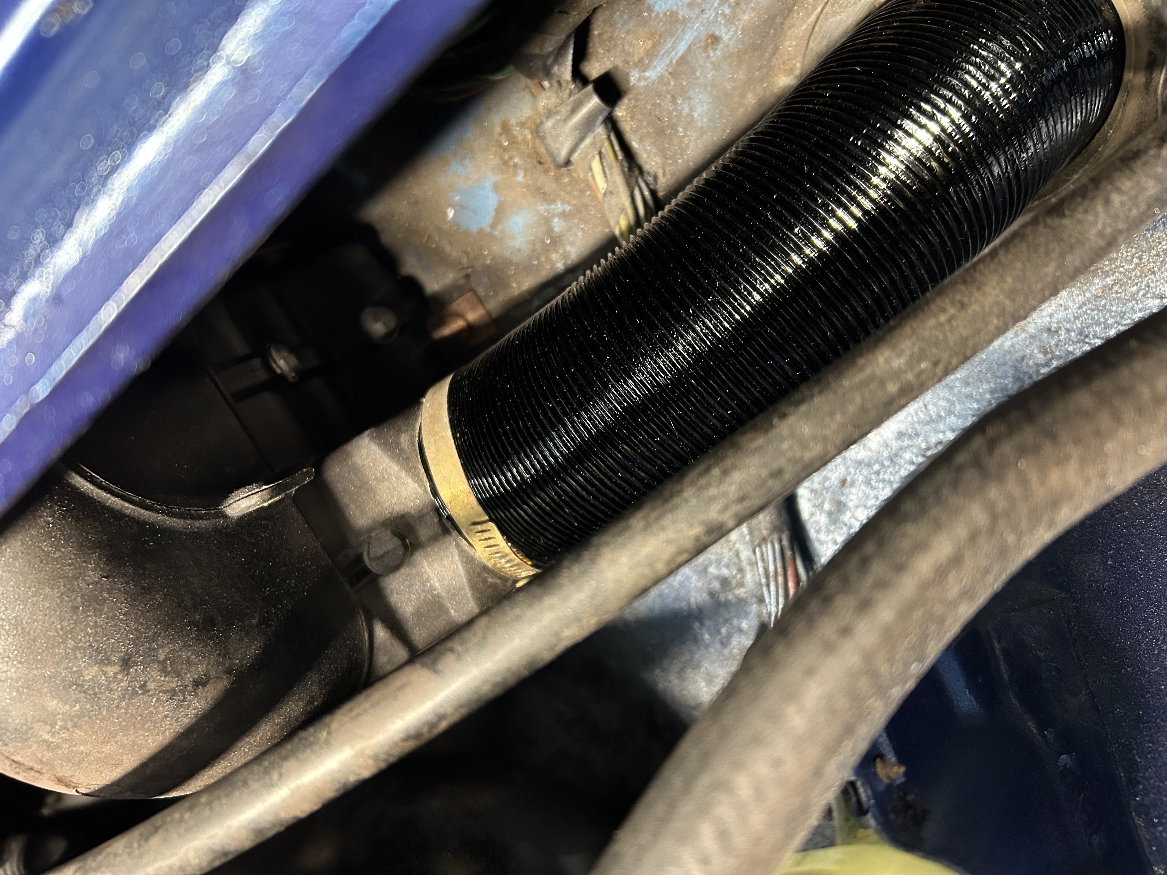

I ran a new fuel line front to rear. Installed the wind deflectors on the pan.
I was able also finish one of the vent window rubber triangles. New hoses both sides from the longitudinals to the air box. Replaced the rubber targa top holders in the trunk.
