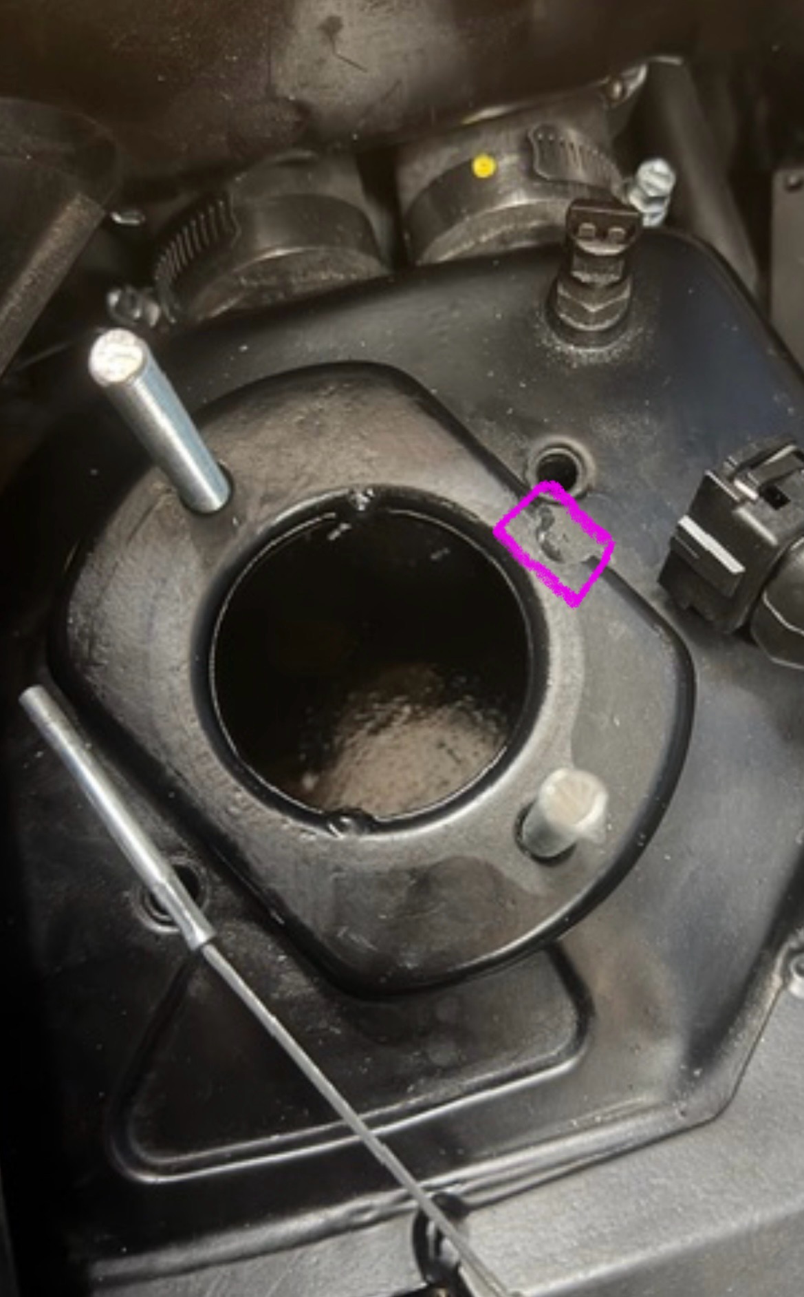

Wait I think I spotted it. Is this it?Attached Image
