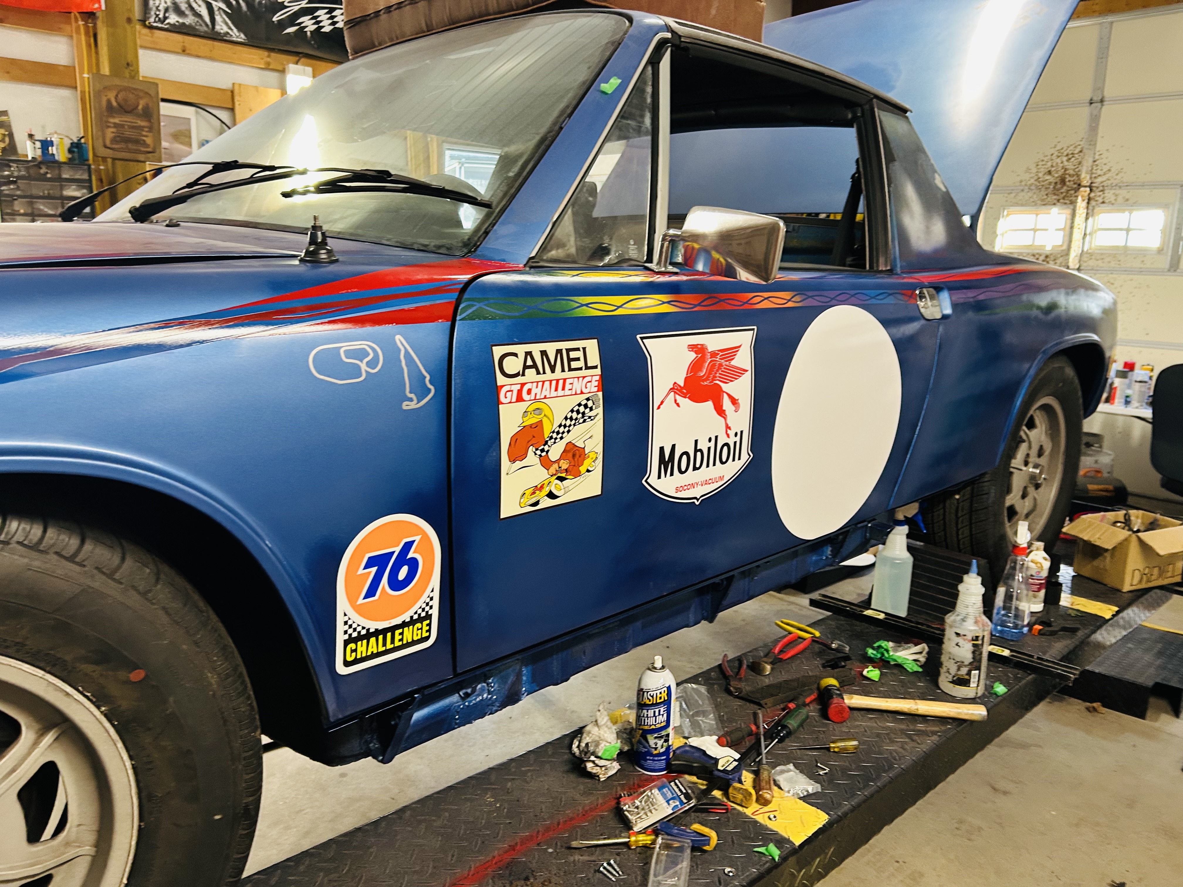

HFC3   Front bumper painted.   Jun 27 2026, 11:19 AM
HFC3   Temporary installation till I can get a filler p...   Jun 27 2026, 11:21 AM
HFC3   The 914 had some blank canvas left to deal with. R...   Jun 28 2026, 04:06 PM
HFC3   Freehand on the Lobster.   Jun 28 2026, 04:09 PM
HFC3   He came out pretty good. Glare hurts the picture.   Jun 28 2026, 04:12 PM
