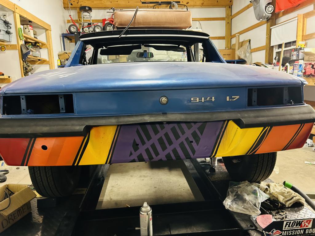

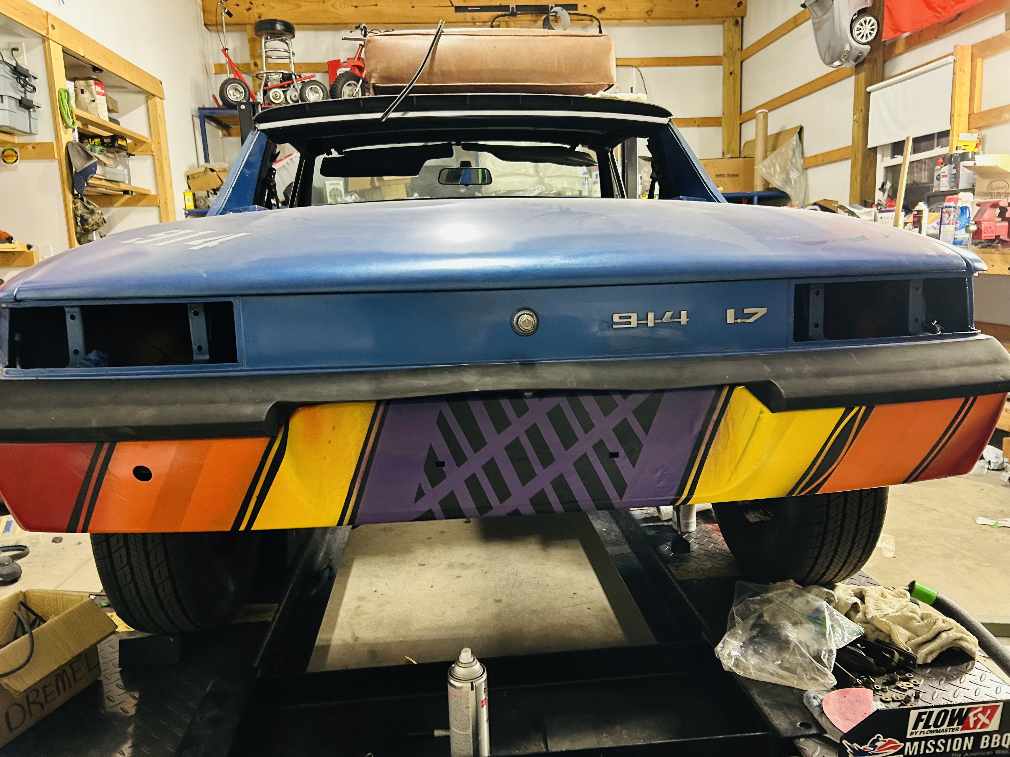

HFC3   Working on the rear bumper.   Mar 31 2026, 04:45 PM
HFC3   Gumballs finally arrived.   Mar 31 2026, 04:47 PM
HFC3   SS threaded rod came in. It was so easy to hang ...   Apr 2 2026, 03:49 AM
