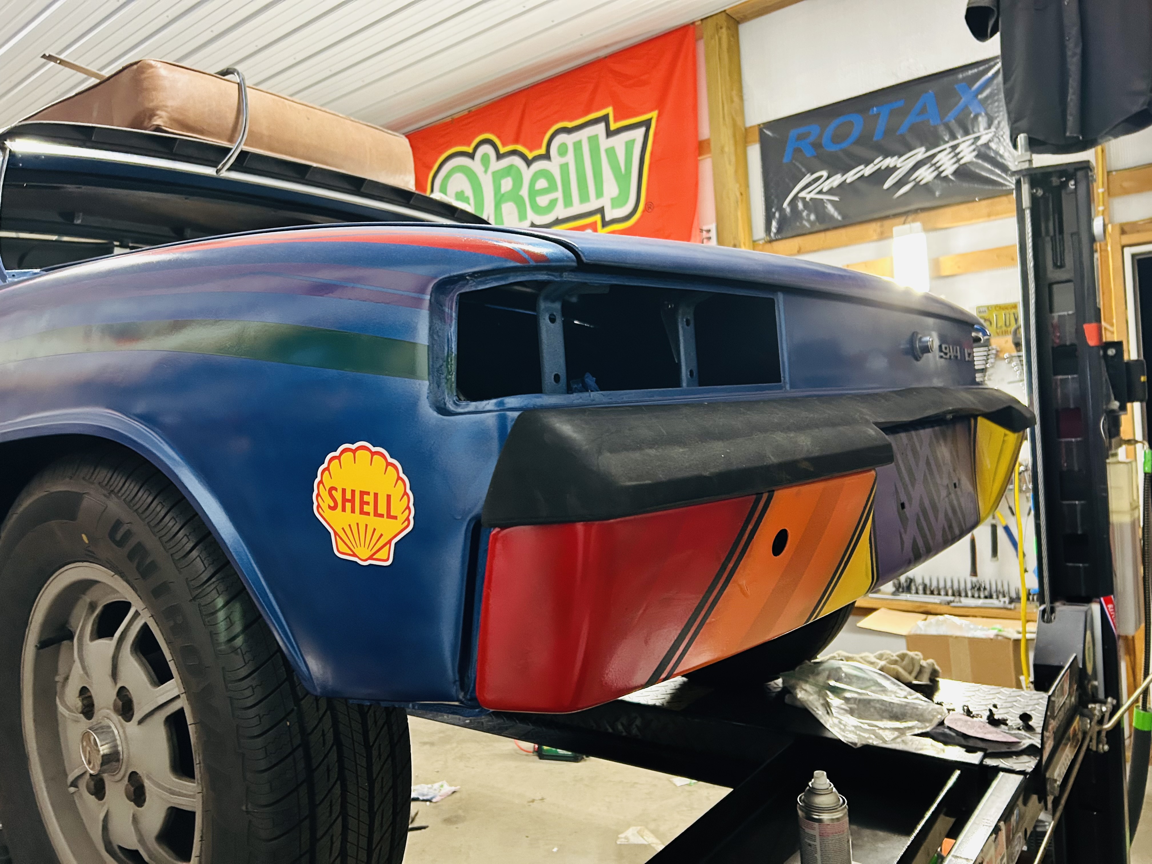

HFC3   Working on the rear bumper.   Mar 31 2026, 04:45 PM

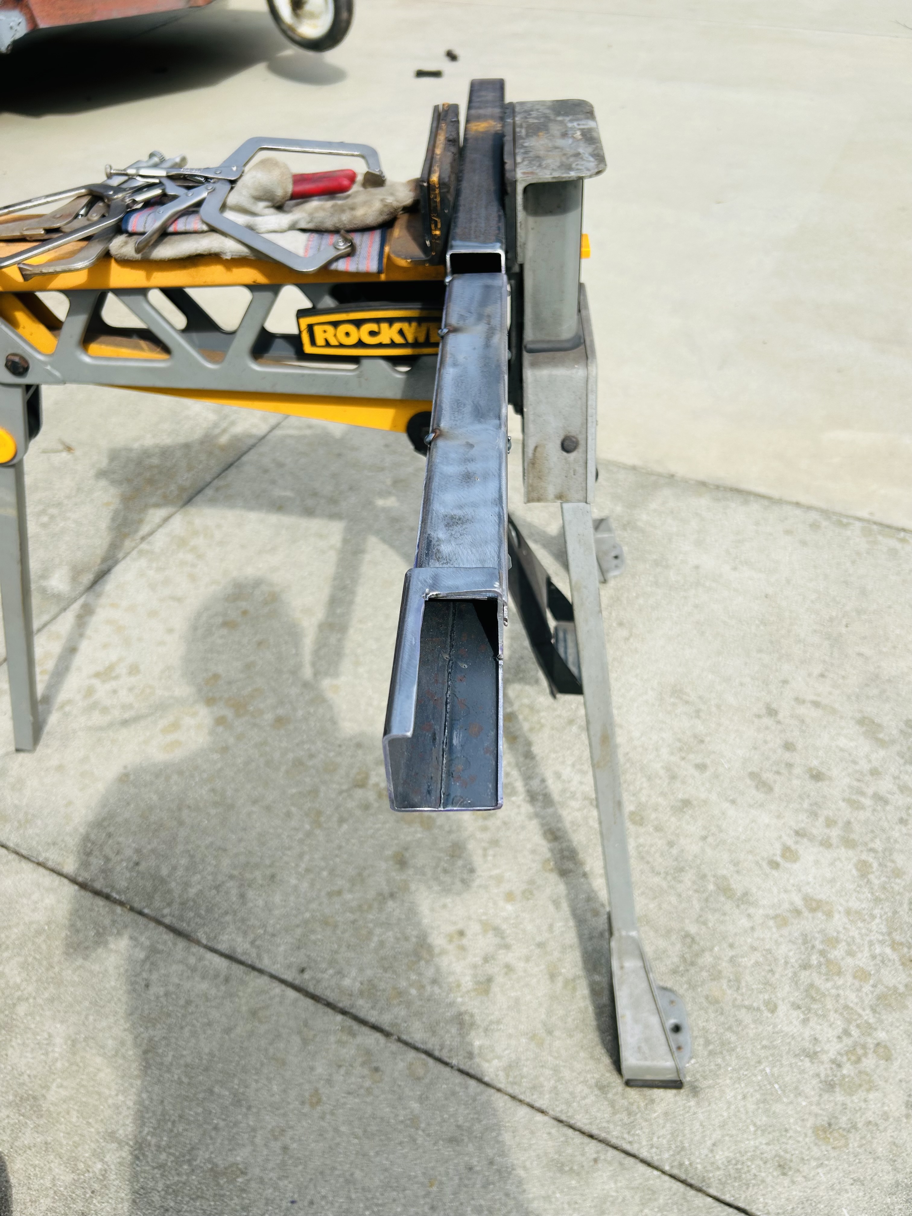

HFC3   Fabricated chassis stiffeners   Apr 2 2026, 03:54 AM
HFC3   RE: Girl Friends Revenge Richmond VA   Apr 2 2026, 03:55 AM
HFC3   RE: Girl Friends Revenge Richmond VA   Apr 2 2026, 03:56 AM

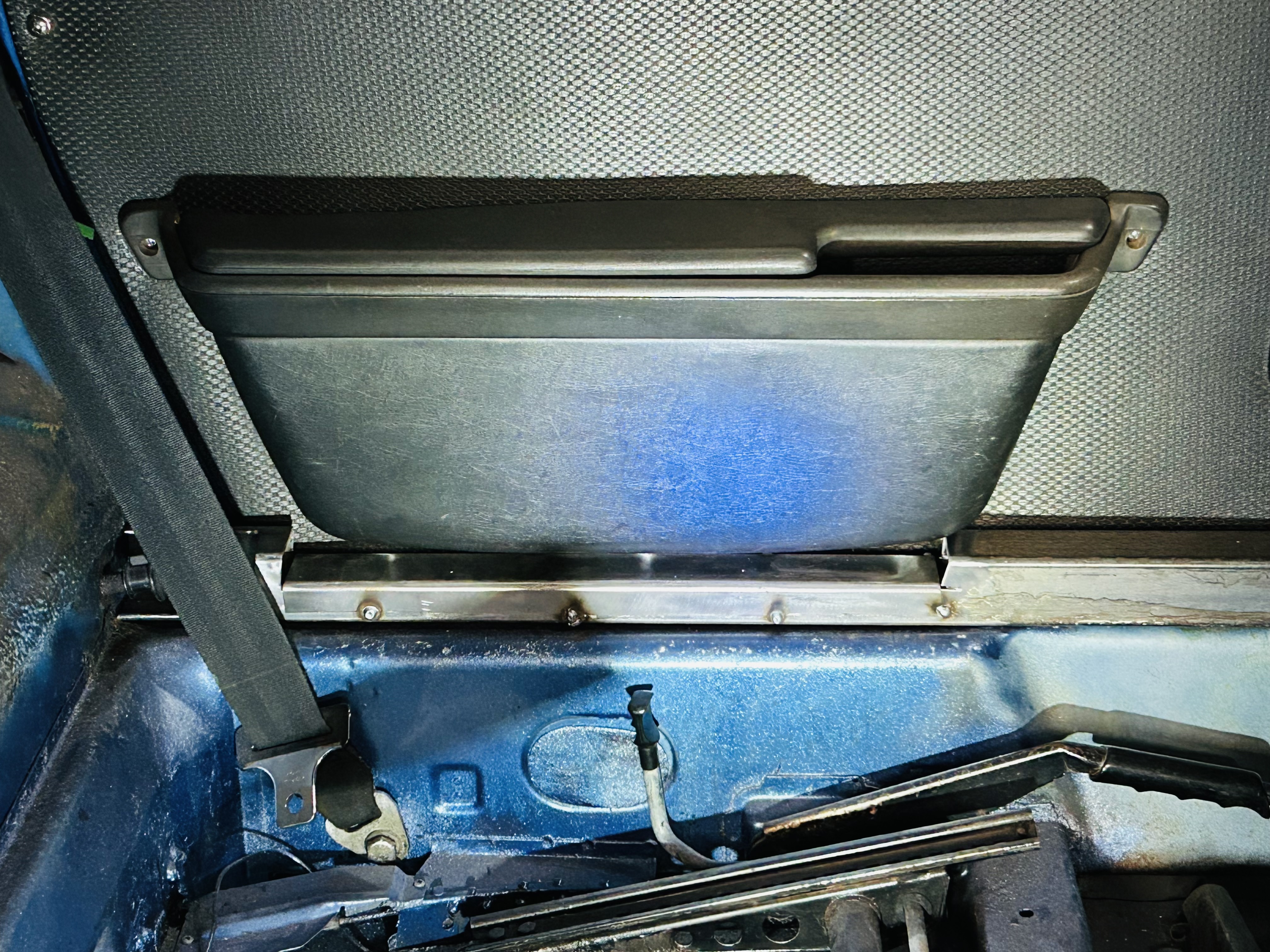

HFC3   Started on the sails. Trim is just laying there. ...   May 22 2026, 05:47 AM
HFC3   Sail panels and trim completed. Rear suspension is...   Jun 4 2026, 04:59 PM

HFC3   Finally a complete rear look with taillights.   Jun 18 2026, 02:37 PM
