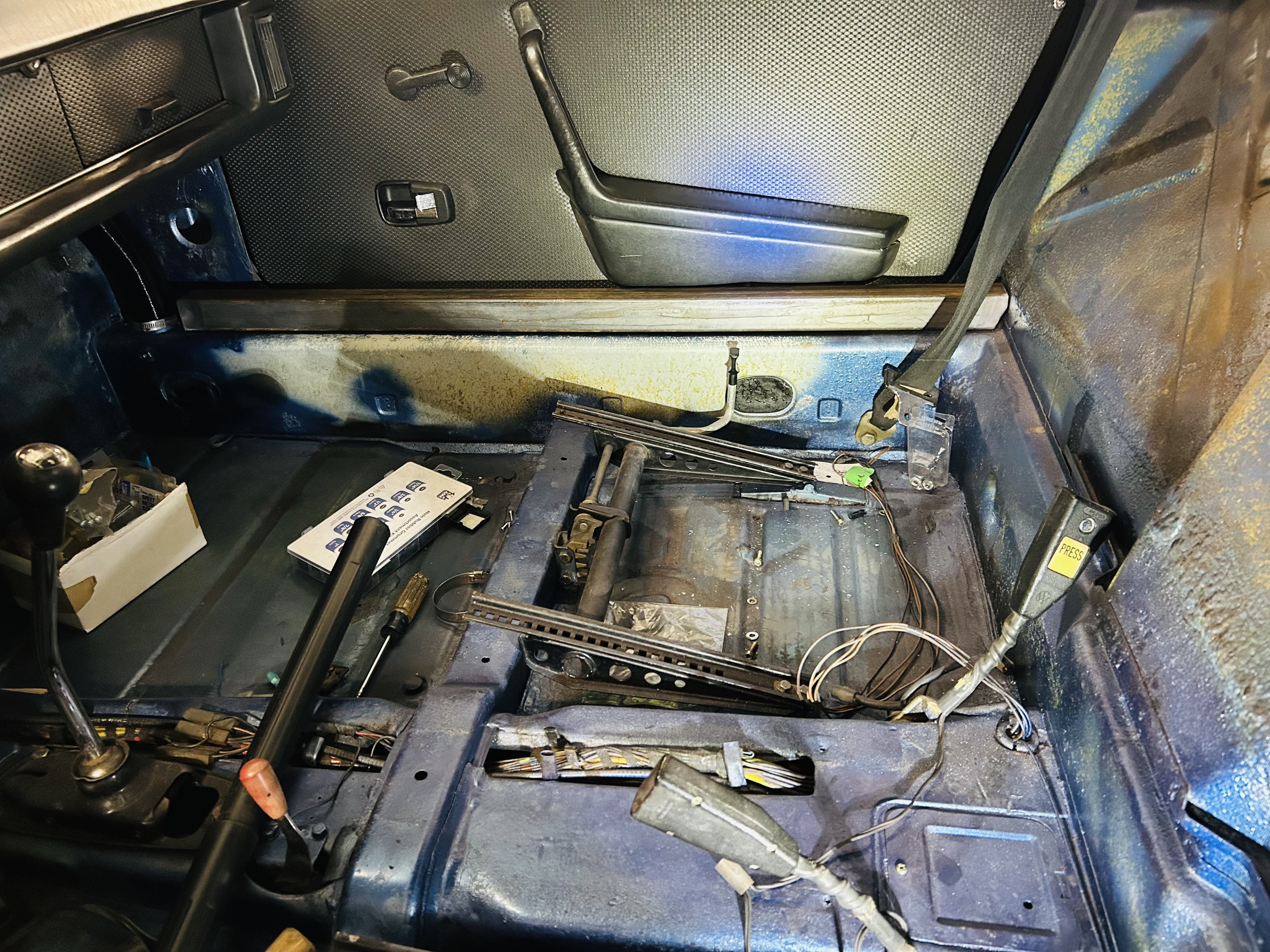

HFC3   Fabricated chassis stiffeners   Apr 2 2026, 03:54 AM
HFC3   RE: Girl Friends Revenge Richmond VA   Apr 2 2026, 03:55 AM
HFC3   RE: Girl Friends Revenge Richmond VA   Apr 2 2026, 03:56 AM

TRP   What is going on with those stiffeners and the tub...   May 7 2026, 08:03 PM
HFC3   What is going on with those stiffeners and the tu...   May 8 2026, 07:37 AM

TRP   Thank you @HFC3 . I just clicked the link to yo...   May 8 2026, 08:54 AM
