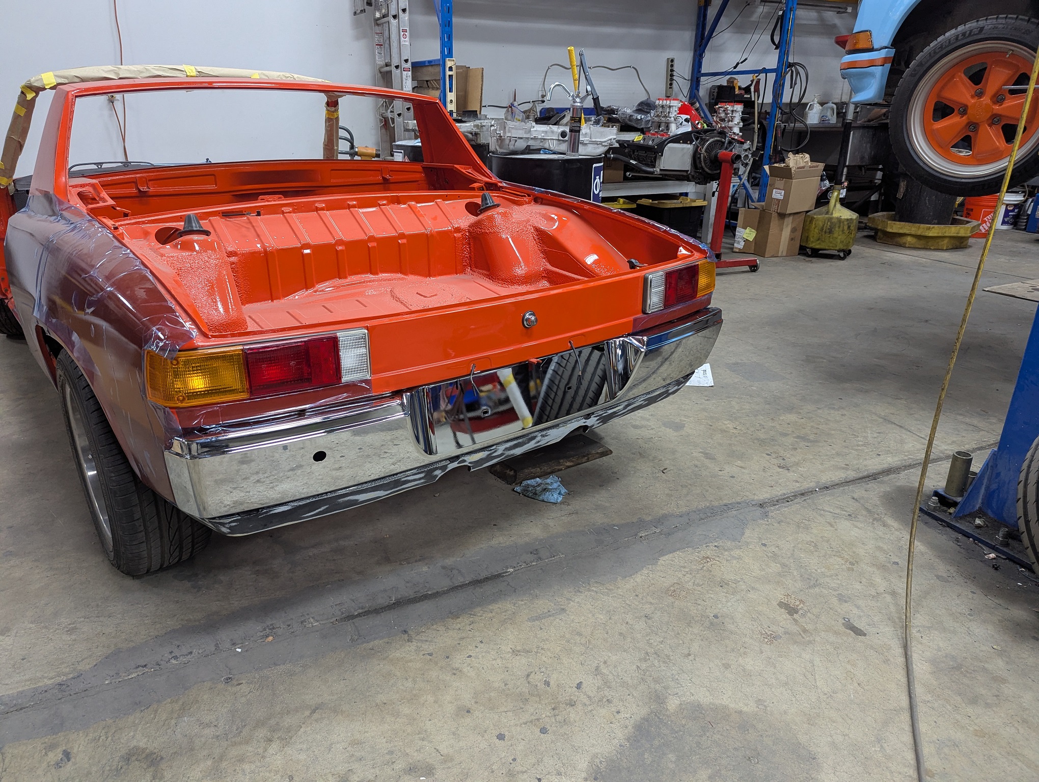

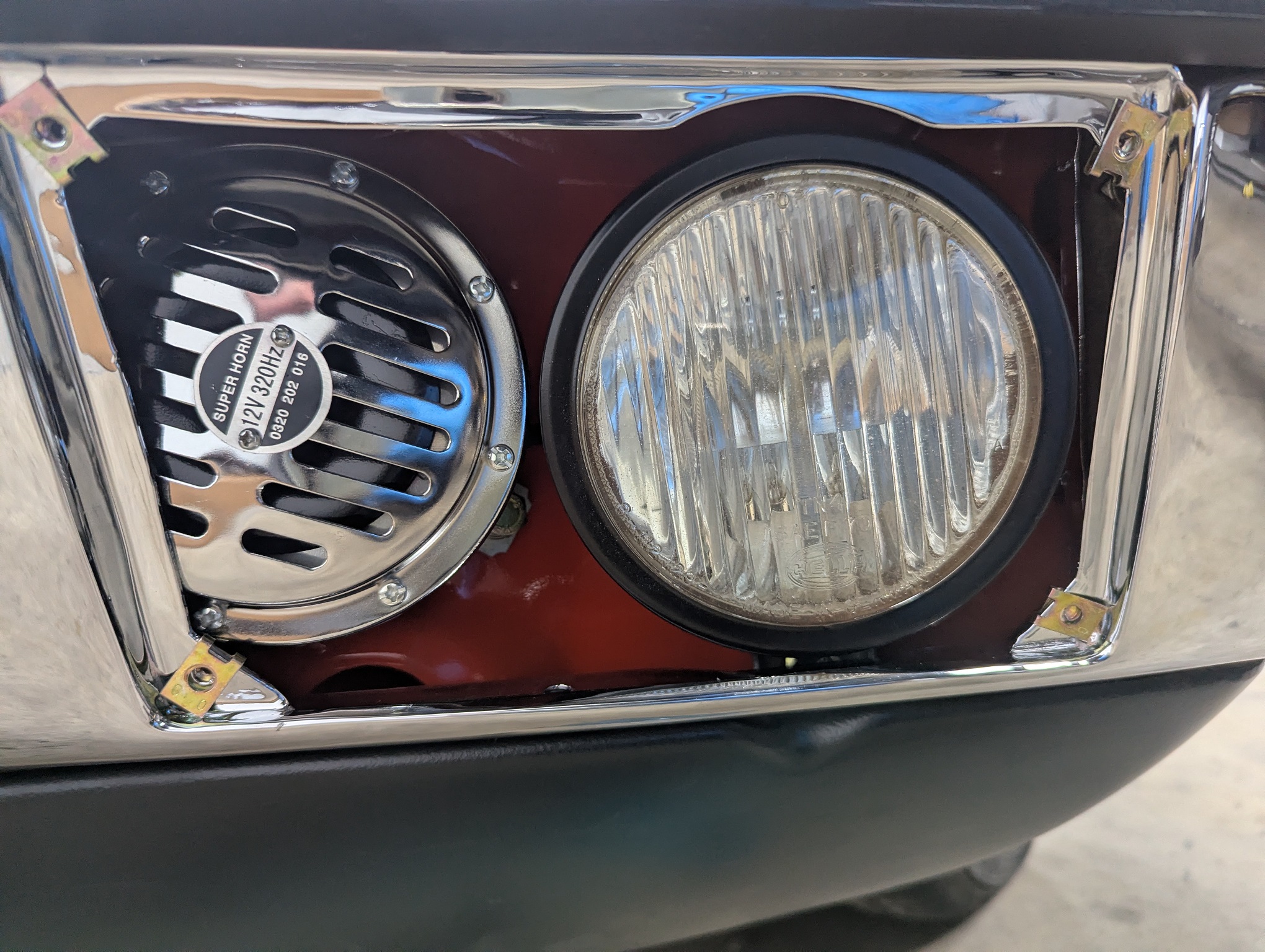

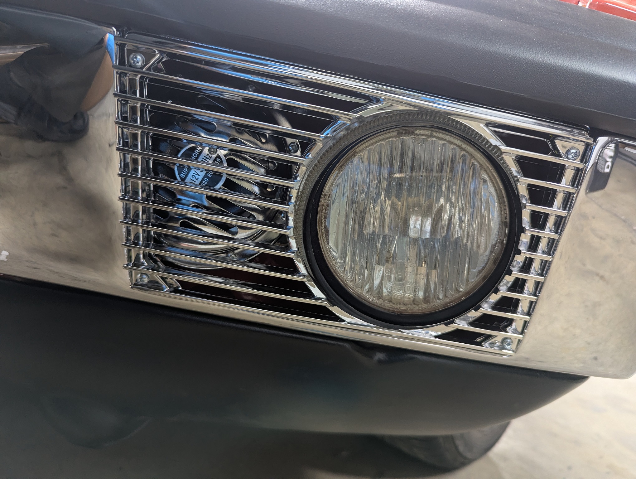

QUOTE(Montreal914 @ Apr 2 2026, 06:55 PM) *
Here are a couple quick shots I took while test fitting the first set EMPI sent before they went up on the site.
I was told they modeled a perfect set off a 73 when they made these.
A couple observations.
1. while undrilled the metal is stamped on the backside of where to drill if you wanted to install bumper tits.
2. The fog light grills fit correctly. The mounting tabs are the correct size & placement. Previous reproduction bumpers I have seen (I believe they were they ones AA was selling) have been pretty badly malformed in this area with the corners rounded off preventing the grills from sitting flat the the tabs where the nut clips attach were to small and off center.
Amazing deal given these sell for about half of what it costs us to get a stock bumper rechromed.
Attached ImageAttached ImageAttached Image
