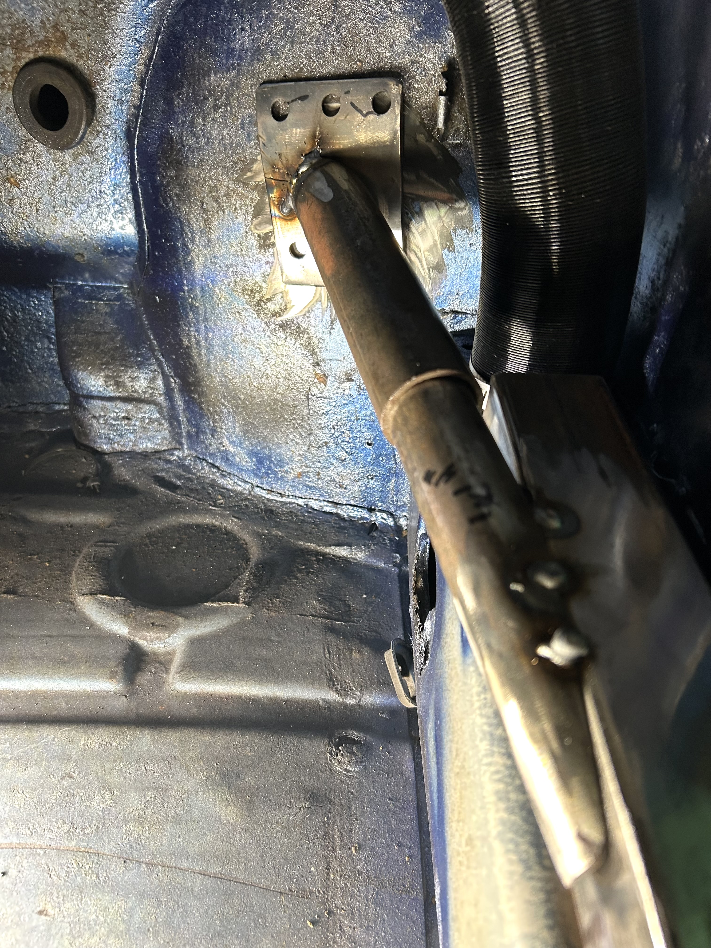

Final tubes to wheel wells. Everything is loose and can come in and out that way I can weld it up outside of the car with the exception of the telescoping tubes.Attached Image
