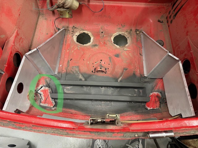

Curious about the cuts here (are they cuts?) and why they had to happen. Looks like it’s coming together nicely!

East coaster   Curious about the cuts here (are they cuts?) and w...   Apr 5 2026, 04:27 PM
mepstein   Curious about the cuts here (are they cuts?) and ...   Apr 5 2026, 05:17 PM
East coaster   It's a common GT mod. Reinforcing the area b...   Apr 6 2026, 09:56 AM
