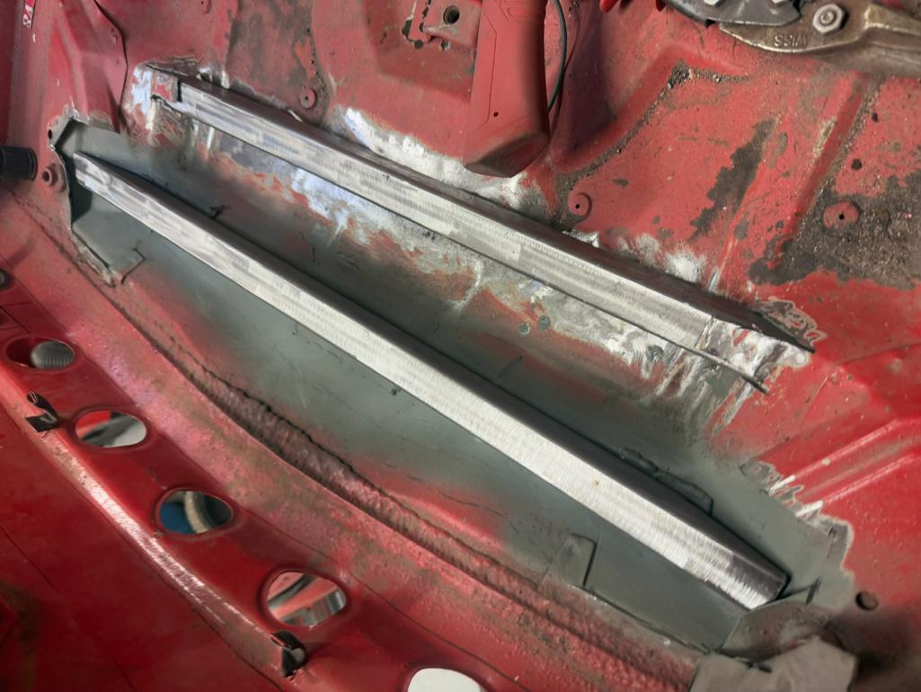

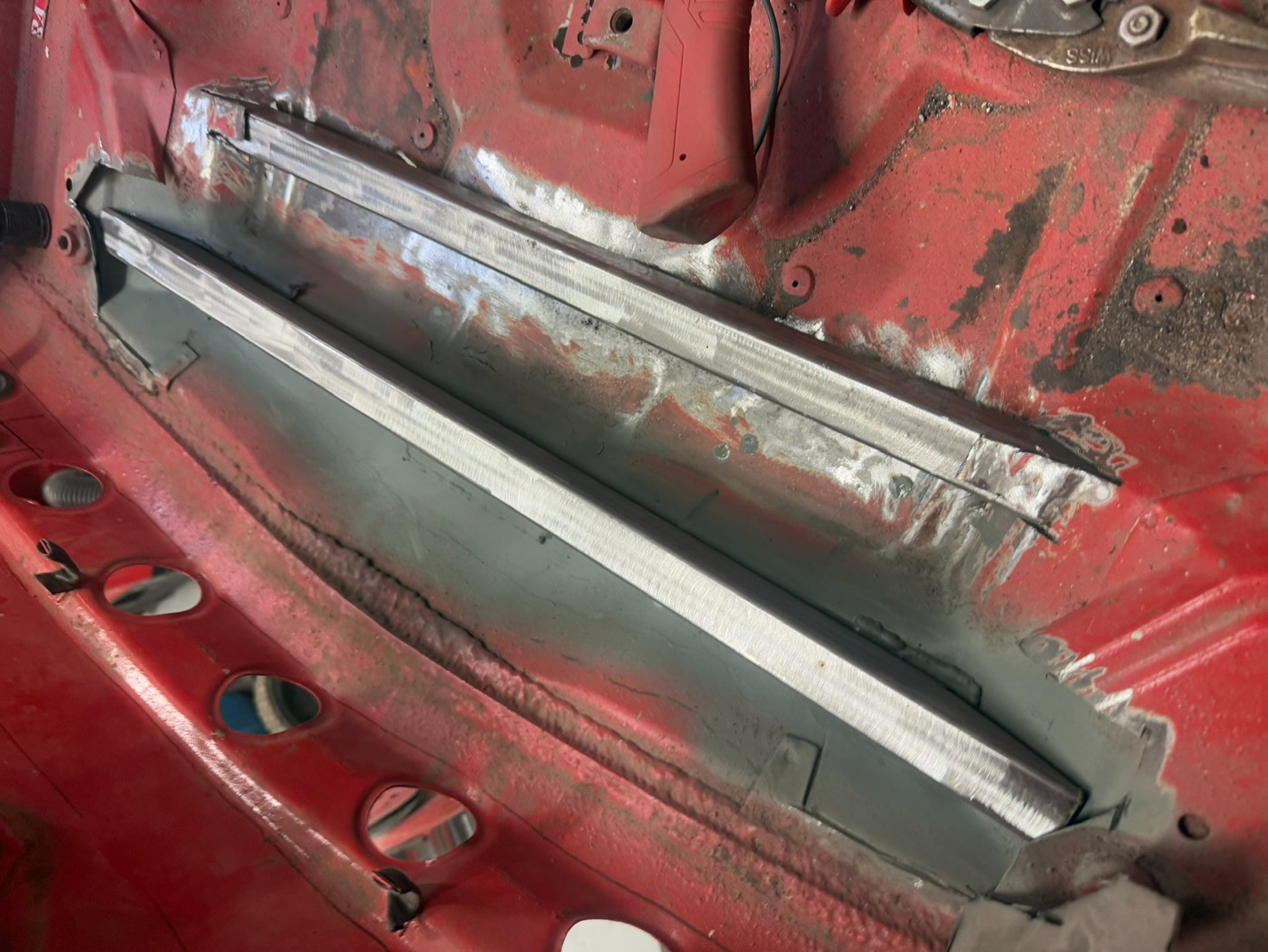

Curious about the cuts here (are they cuts?) and why they had to happen. Looks like it’s coming together nicely!

QUOTE(East coaster @ Apr 5 2026, 06:27 PM) *
It's a common GT mod. Reinforcing the area between the suspension mounting points. Maybe helps, maybe not. Between cutting a big hole in the front and running big tires, I like the idea and had Jarred execute it. The small pieces were cut out so the metal stock could be welded to the top of the suspension points. Then the pieces are welded back in place.
I've always felt like a lot of attention is paid to the rear of the car in regards to reinforcement but not much in the front.
